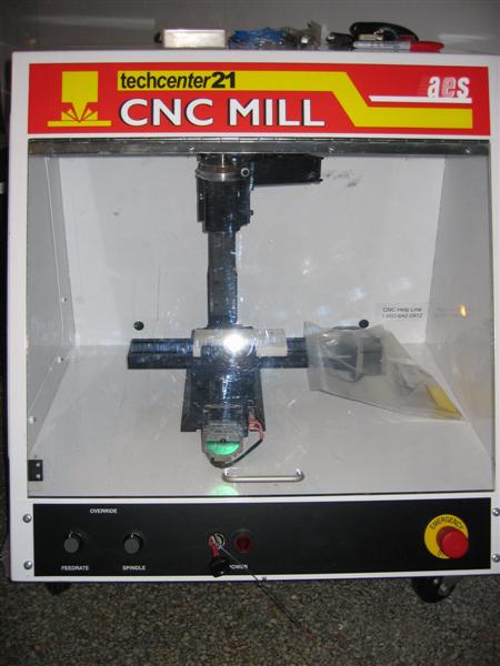

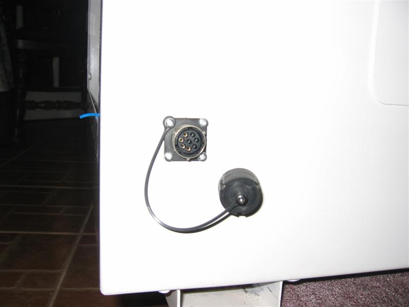

I just bought a Denford Micromill 2000 year 2002 and I recieved some software disks and manuals with it, but the problem that I am having is that I think they are the wrong disks and manuals. Can any one tell me if I have the right disks to work with this machine and on windows XP , and where I can get the right manuals. Will Mastercam v7 work to program this machine? Also what is the round plug on the left side towards the rear for? Here some pics so you know what i am talking about. Thanks

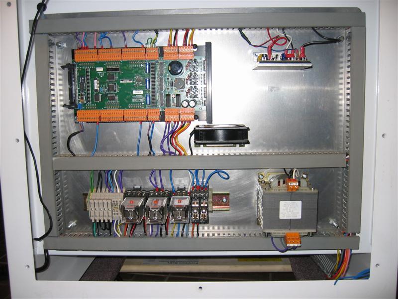

Unfortunatley i can see that you have a PCB missing that sits on top of the board located at the top left of the panel :cry:
The board is the one that handles all the communications and has all the inteligence for the system so is not cheap :(

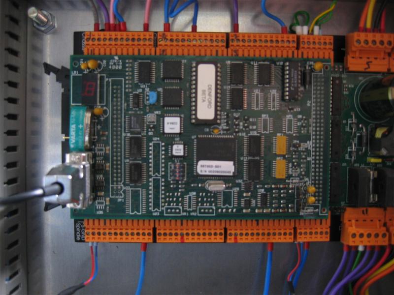

Just thought can you add a photo of the board as there is an EPROM fitted to it depending on the Version written on it you may have DOS software :(

Post by illmakemyown » Tue 18 Mar , 2008 19:02 pm
Here a picture of the board, also you will see on the bottom 2nd and 3rd connector there are to red marks what goes connected there, the old owner had two wires going to a small relay on the bottom. was that right? Thanks

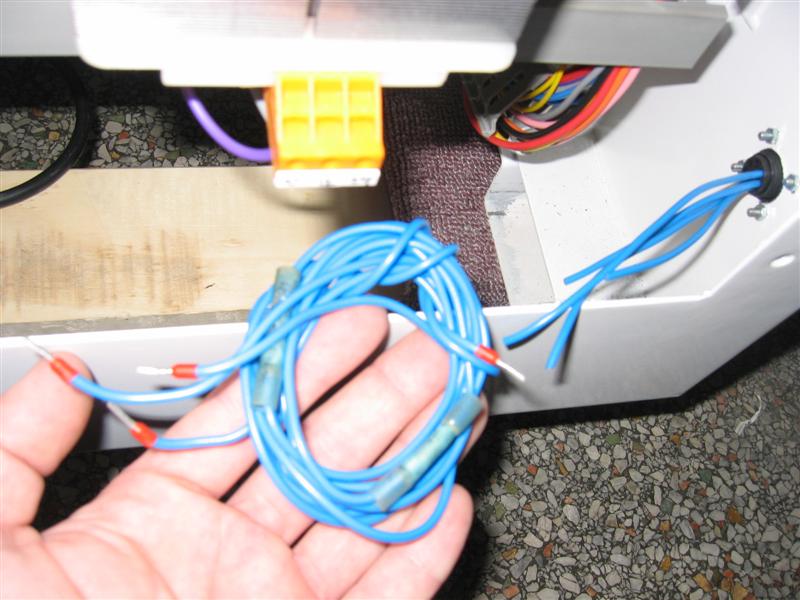

Actually the wires from that board went to the round plug on the side, same with the ones from the relay. The old owner cut them from the plug and put them together bypassing the plug on the side. Does anyone know what that round plug was for, how do I bypass it if I have to, what wire goes where? Thanks

Post by Steve » Wed 19 Mar , 2008 13:31 pm
The two red marks are correct for the wires,
The one 2 terminals in is a 0V and the other is the Guard input.
These come from a relay contact or guard switch.

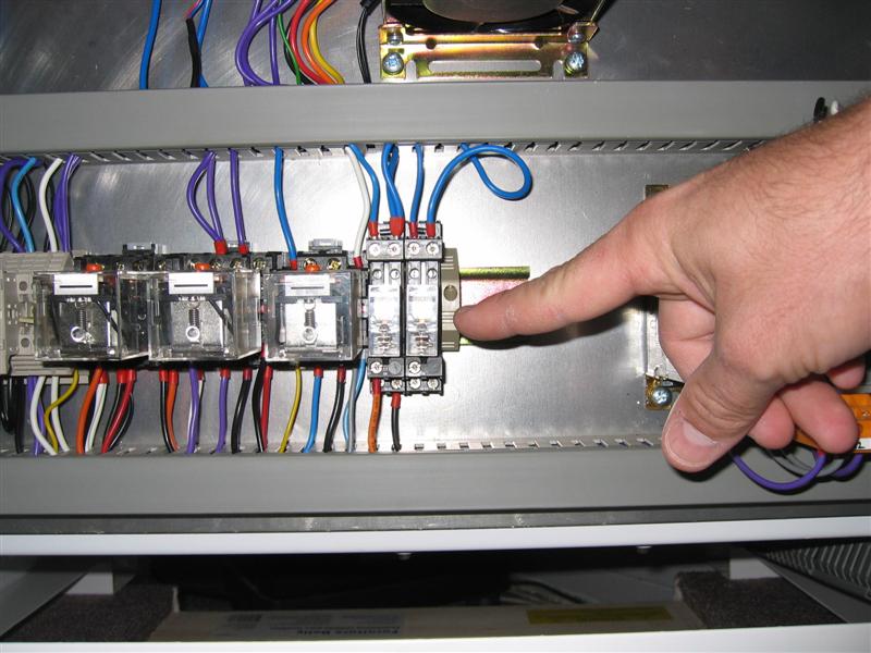

I just looked at my machine and it looks like mine has one more relay than the diagram shows? Its the one I'm pointing to in the picture, I think its got some thing to do with the plug on the side. I think i am going to have to call AES because they might have added that plug to it, because it looks like the hole was drilled after the cabinet was painted white. Thanks

The relay you are pointing to is the Auxiliary Relay (AR) it has a 12vdc coil.
The round plug on the side of the cabinet is for a robotic arm/parts feeder and the AR relay is wired to it. The coil terminal, on the AR relay, A1 is wired to Terminal Block 2, pin 6 (Extra Outputs 12). Terminal A2 on the coil is wired to terminal A2 on the next relay to the left, the Spindle Go Relay (SGR) and that wire goes up to Terminal Block 10, pin 3 (+12vdc).
The Outputs on the control card are switched to ground when activated completing the circuit to the coil (energizing), closing the relay contacts.
The relays from left to right are;
Main Relay (MR) - 110 vAC Coil
Emergency Stop Relay (ESR) - 110vAC Coil
Guard Relay (GR) - 12vAC Coil (YES AC)
Spindle Go Relay (SGR) - 12vdc coil
Auxiliary Relay (AR) - 12vdc coil
boots
Posts: 220
Post by boots » Fri 21 Mar , 2008 16:18 pm
The connectors with the red marks are for the round connector on the side of the cabinet.
The connector on the left, Terminal Block 8, pin 5 (Extra Inputs 10) is wired to pin A on the round connector.
The connector on the left, Terminal Block 9, pin 2 (Inputs GRD,ground) is wired to pin B on the round connector.
The machine will operate with out this all connected, it is only needed if a robotic parts feeder is added.

Thank you I just checked my machine and it is wired just like you said, but it also had wires on the AR Relay terminals 11 and 14 that went to the round plug, and wires on Terminal Block 8 pin 5, and Terminal Block 9 pin 2 that also went to the round plug. Someone cut all the wires going to the round plug and joined 2 and 2 together, i removed them before turning on the machine. I want to put them back where they belong on the round plug do you know where they all go connected to. Also if they are not connected will the machine still work? Thanks for the help. :D
