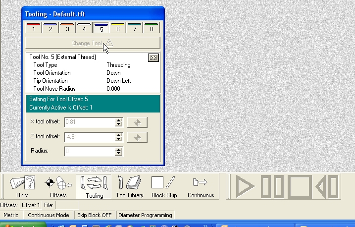

got the cable sorted now, so the machine will now connect to the pc. i can now get the chuck to spin and alter the speed i can also move the tool post left and right and up and down :D. i cant see how to opperate the tool change manualy, just to make sure it works ?. is there an option in the software to make the lathe do a dummy run as though it was machining somthing ?. here is a pic of the screen showing the mode i am using to operate the lathe. cheers simon

To operate toolchange manually, either:
1. Go into AUTO mode, open up the tool editor from the tooling button on the bottom left. Click on a different tool number from the top 8 buttons (you may have to right click and add tools to make them all active) - then click "Change Tool !"
2. Go into MDI mode and type T0202 M06, then hit cycle start.
For a full Auto test, open one of the standard .fnl files (should be found in my documents\denford\cnc files) like pen0. Then in AUTO mode, press cycle start. (get used to pressing Stop then Rewind before starting a program - to be sure it starts from the beginning of the file)
Re: mirac pc and microrouter
Post by Steve » Mon 23 Jan , 2012 10:21 am
To index the toolpost first you must make sure the Auto Toolpost is enabled in the setup parameters.
Then open the tooling library. Highlight the tool you want to change to then click the toolchange button. Note the machine must be in Auto Mode to allow a toolchange!
