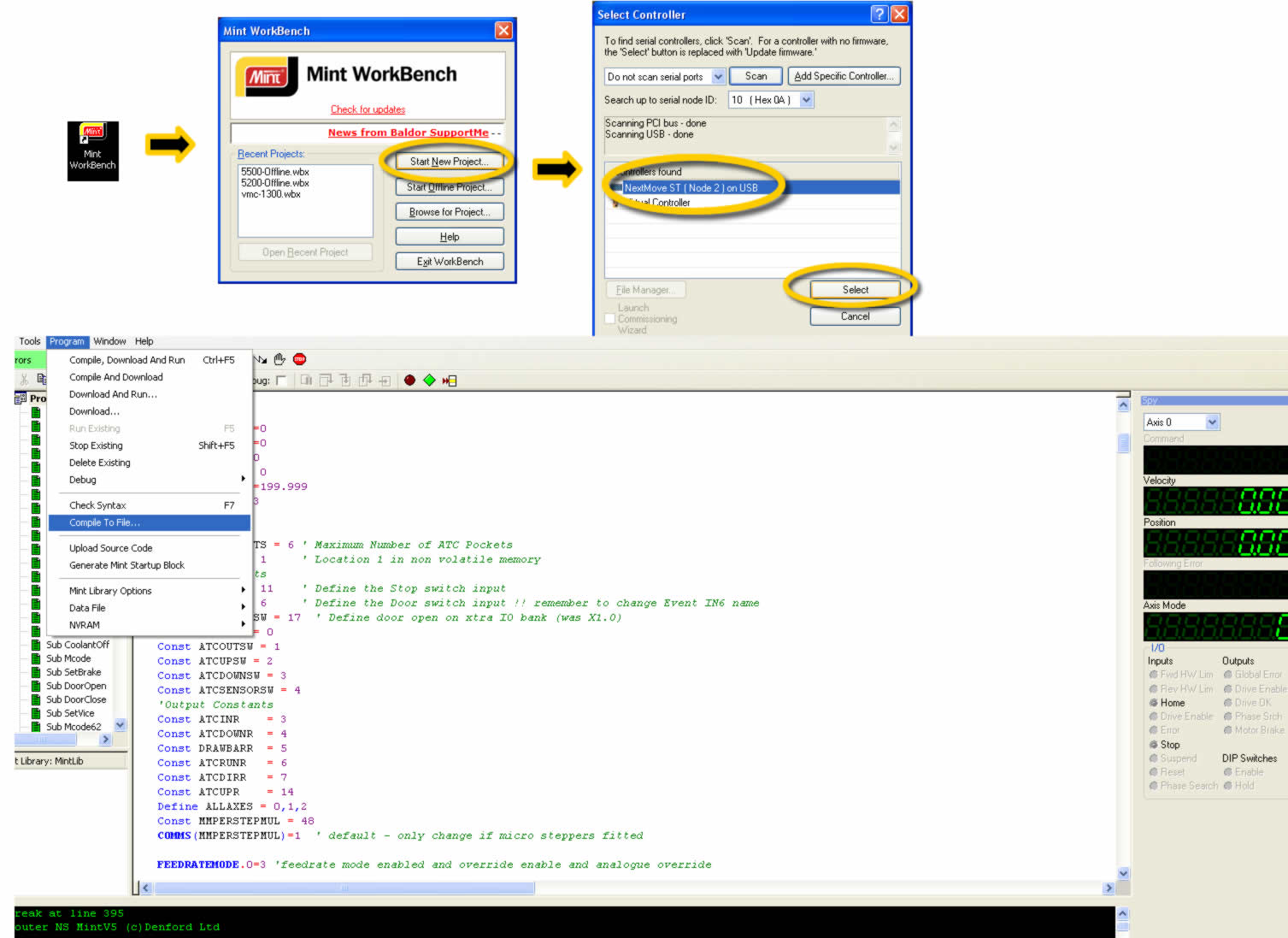

The Mint program is stored as a text file:
MACHINE-NAME.mnt or MACHINE-NAME.52xx.mnt for Green 7-segment LED Baldor boards
MACHINE-NAME.55xx.mnt for latest Orange 7-seg led Baldor
These text files are the source code for the machine logic.
Mint Machine Centre (Workbench) can open the .mnt files and compile them into .mex files...
MACHINE-NAME.52xx.mex for Green 7 boards
MACHINE-NAME.55xx.mex for Orange 7

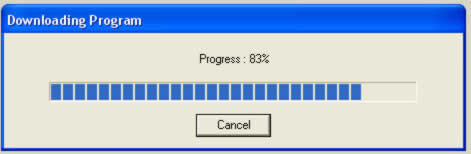

This .mex file is then downloaded to the Baldor every time you connect to the machine in the VR software (When you see the erasing flash...Downloading message)
