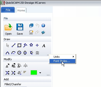

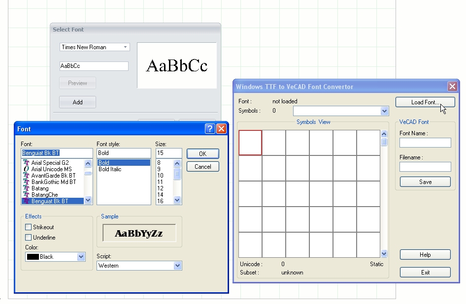

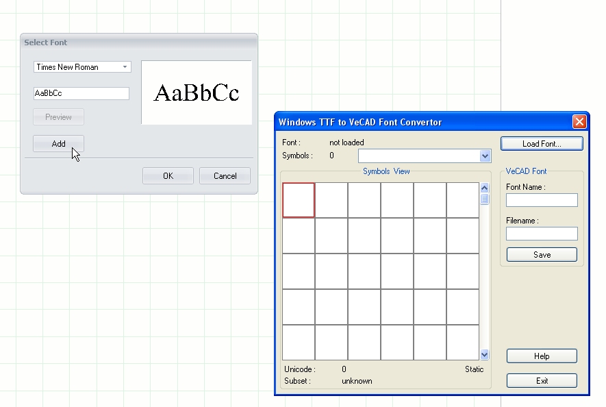

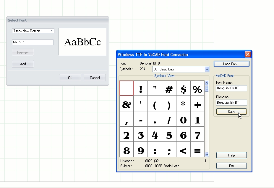

From the Menu displaying fonts select fonts and then follow the following procedure.
Any font on your computer can be added.
The new fonts will only appear in the menu once you have closed down QuickCAM then restart it again.
If you don't have the latest QuickCAM 2D the procedure is the same in the older version from the fonts menu, but you could download the new version as your licence key will work just the same.
The V-Carve and Tabs functions would just be disabled.
Font Styles.
Add.
Load Font.
Select the font from the list
OK
Save
Exit.
Restart QuickCAM

When I click save, nothing happens...
The help function doesn't work either.
