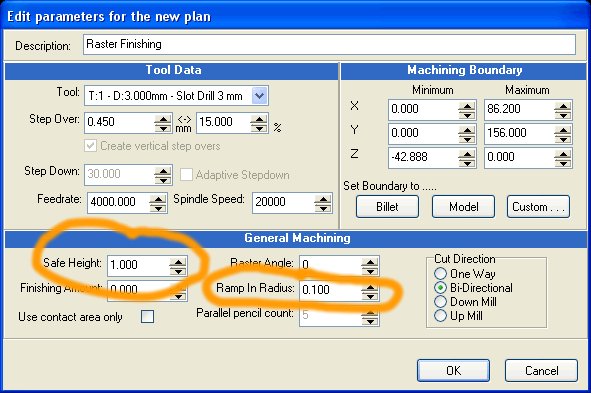

As someone else is having a similar problem, I've done a screenshot of the bits that need changing:

Denford Admin wrote:As someone else is having a similar problem, I've done a screenshot of the bits that need changing:
Sorry for any inconvenience, but would you tell me where I could find the 'Edit parameters for the new plan' toolbox? I have been looking for a while, but I cannot find it.
Re: Autodesk Inventor - Quickcam Pro- Denford Compact 1000 P
Post by Denford Admin » Tue 17 Apr , 2012 8:44 am
Those parameters appear when you add a plan.
If the plan already exists then double click on the plan in the right-hand list (or highlight it and click the Edit button)
