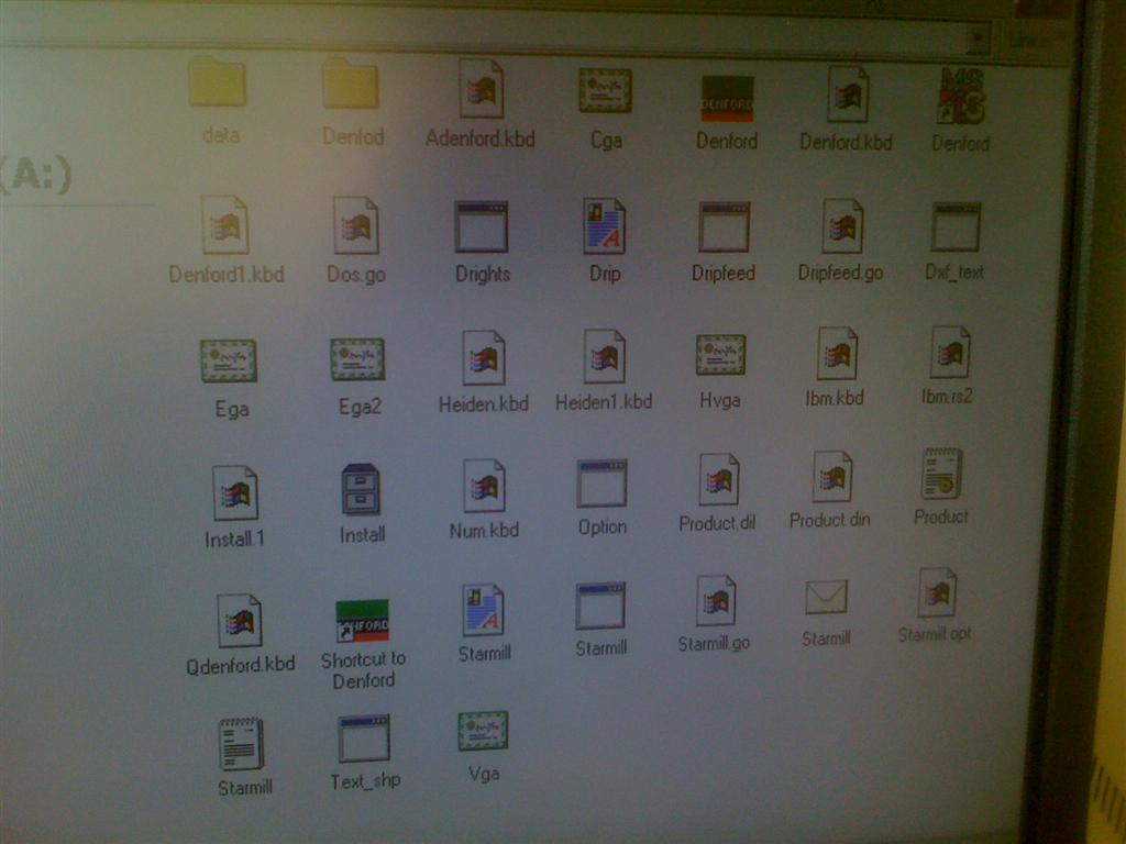

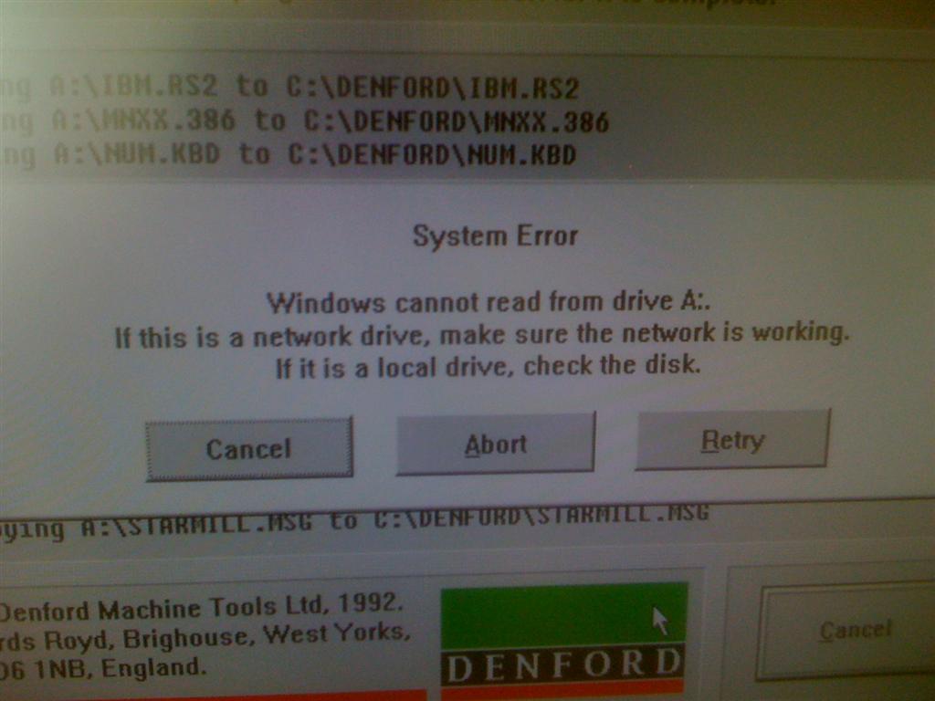

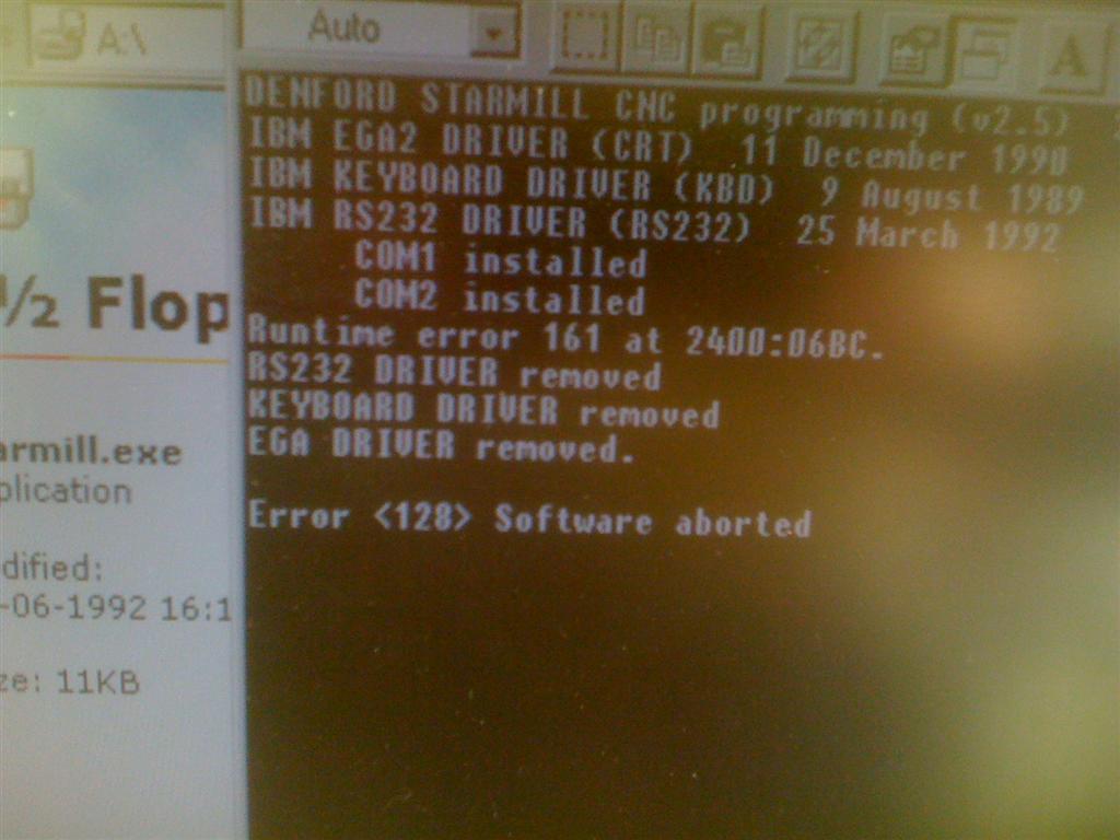

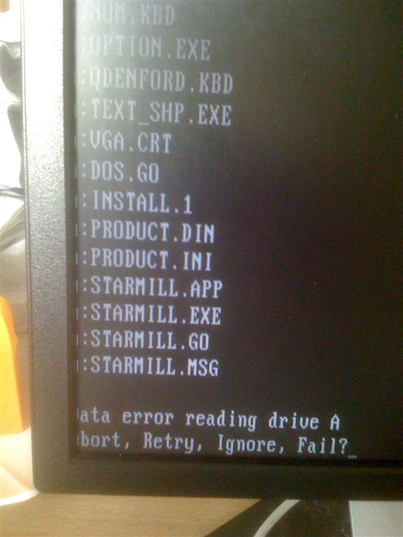

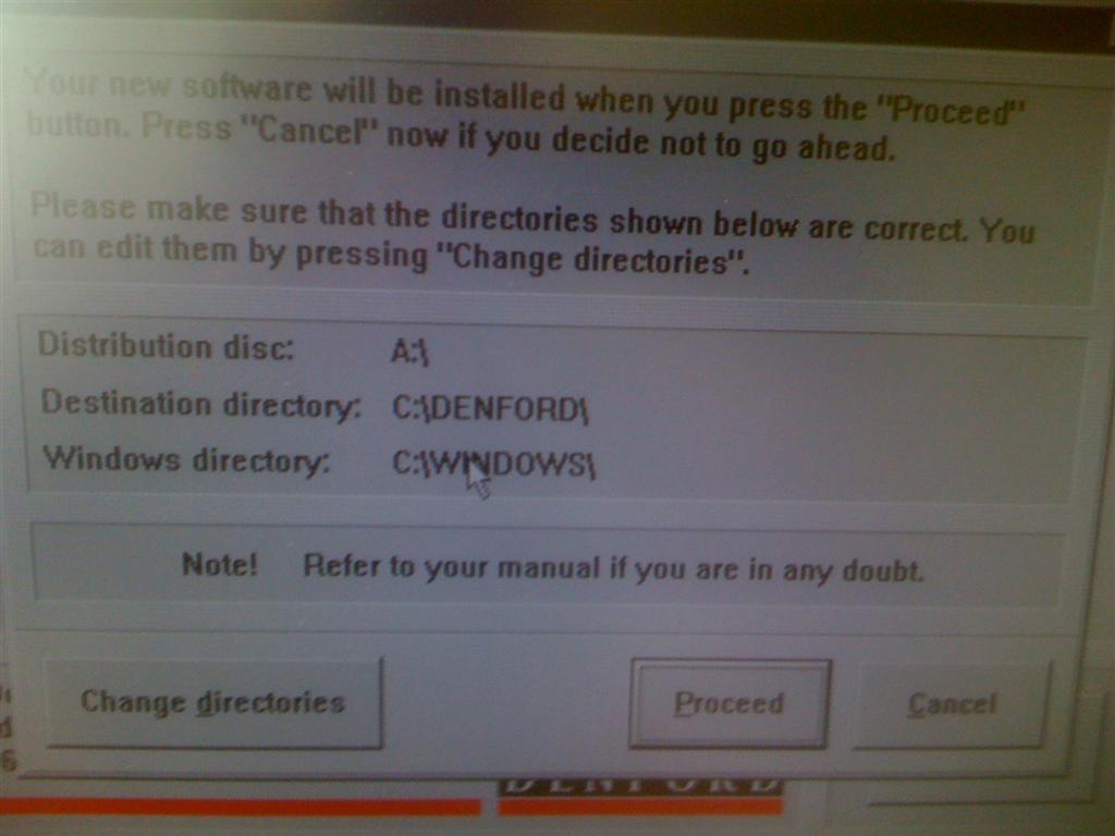

Hi all , as in my first post I have a Starmill with Nee software floppy and dongle . I now have an old Windows 98 pc and cannot find my way to getting started .
When I put the floppy disc in to the drive and open the disc from "My Computer" I see what is in pic 0029 .
If I go to the Starmill app icon and press on it , I get pic 0028 .
If I go to Install , I go through a process which is pics 0030/31
If I start the pc up in DOS mode and try and copy the floppy to drive C , I end up with pic 0027 .

Re: Starmill
It could well be the disk is corrupt...that magnetic data has been on there for quite a few years now.
Hopefully you can recreate the disk from software on the website (sorry I don't know which one you should pick though)
Re: Starmill
yeeehaa is all I can say . Ive just used the starmill.zip and hey presto , I have a fully functional machine . as they say , jobsa goodun !!!!!
