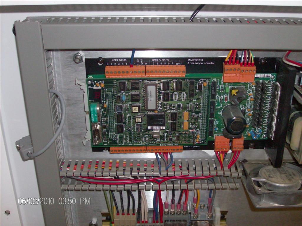

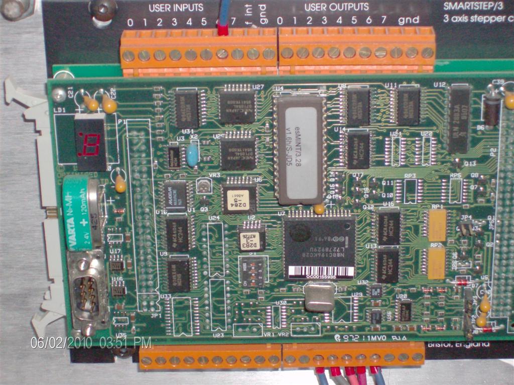

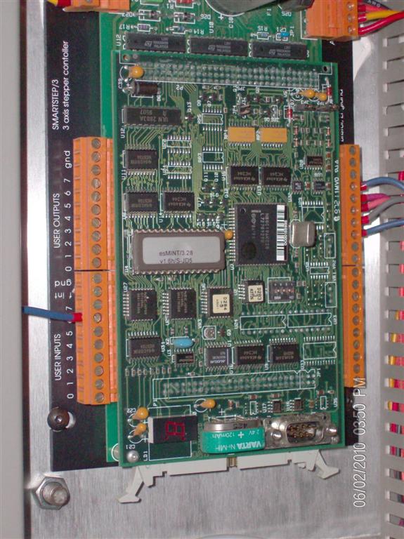

I have a Micromill IST with the smartstep 3 controller. The ROM label says esMint 3.28 v1.6h/S-JD5. I am using the Fanucsmd DOS software that I downloaded from the Denford site. The machine came with the software manual.
The machine has a LED with a 7 then a blinking dot (.).
I have not been able to get the software to completely pull up. It trys to load then it says it removed the keyboard & COM1 drivers then error 128.
What do I need to do for the software to connect? What should the Fanucsmd.GO file look like?

I notice that one of the orange motor connectors (on the top right) looks to be pulled out slightly
Not sure about the error 128, but there have been other posts on this, eg:

Yes! I have pushed it back in since I took the pictures. Also the 9 pin connector is removed to take a better picture.

I don't understand how you've got it working with V2 VR Milling - do you mean the DOS software ?
The esMint chip on the Denstep board you've shown will only run with DOS control s/w
In theory you could upgrade the control board to let it run from V5 VR Milling, but it's possibly too expensive to be worthwhile.
