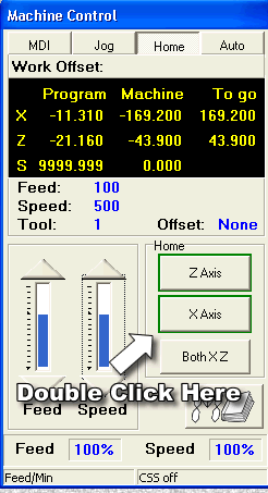

Secret Home for VR Turning?????
Yes - see attached picture. ...
Warning - The secret home button is only useful if you are having problems with the home switches or dogs - allowing you to move the axes out of the way for maintenance.
The machine MUST be homed normally at all times otherwise you can damage your machine by running into deadstops and possibly running the nut off the screw.
- Pressing secret home allows machine to be moved without homing - use with caution !
- vrturning-secret-home.gif (14.65 KiB) Viewed 6212 times
