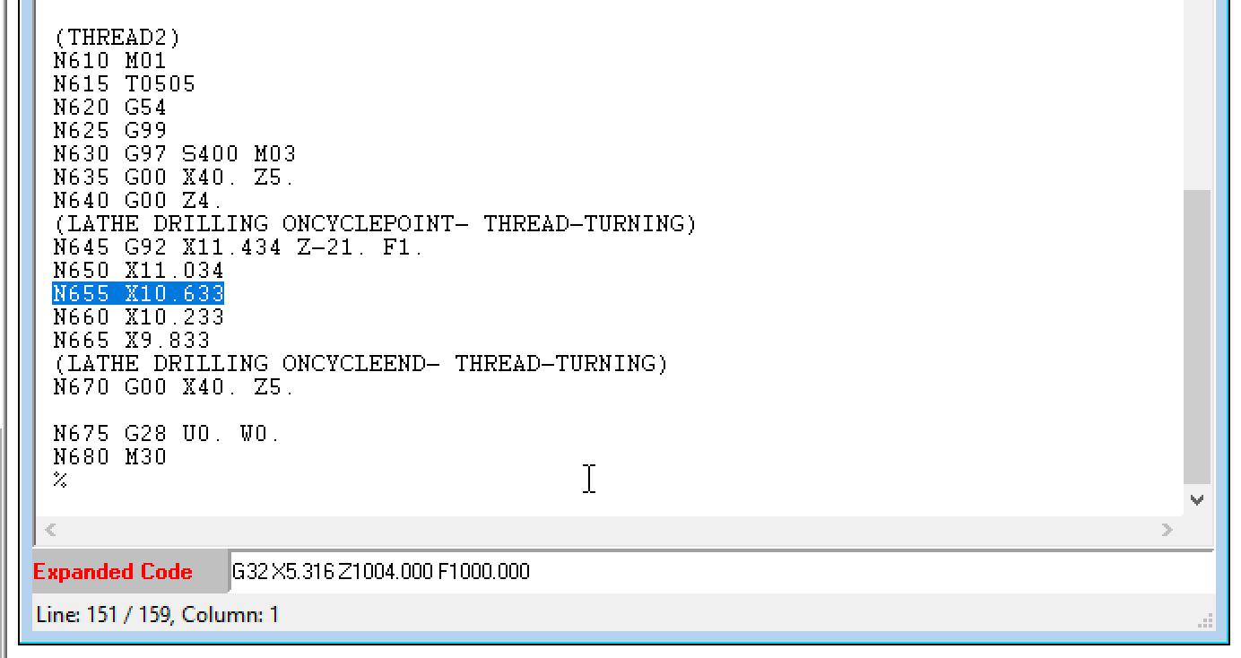

Post by dpslwk » Sun 26 Jan , 2020 16:10 pm
I'm currently trying to rewrite the Fusion 360 Post processor to correct drilling and threading cycles
Just trying to get G92 working and need to file a BUG in VR Turning, seen in v1.33 and v1.51
I'm only doing this in the simulator / virtual machine right now as I'm not near the our Novaturn.
Using the correct modal format and Setup->View Cycle Expansion shows the issue/
line N645 G92 X11.434 Z-21. F1. runs correct
but in the following line N650 X11.034 its is correctly trying to expand the cycle to G32 but has a Z10004 (way off the scale), and not correctly remembered from the previous Z-21
Screenshot 2020-01-26 at 14.33.13.png (33.32 KiB) Viewed 29148 times
N650 X11.034
N655 X10.633
N660 X10.233
N665 X9.833
(LATHE DRILLING ONCYCLEEND- THREAD-TURNING)
N670 G00 X40. Z5.
N675 G28 U0. W0.
N680 M30
