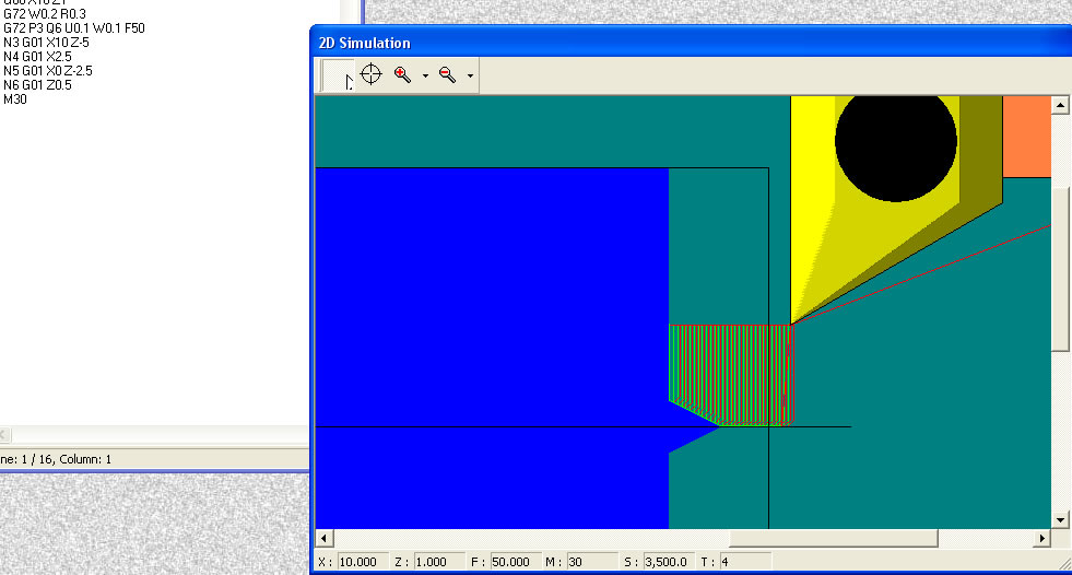

I wonder if anyone could help me with a quick query.
I'm currently learning to use G code programming on my Novaturn but am struggling a little with the G71 and G72 canned cycle commands.
The program below carries out a G71 command to profile the outer surface of a round bar and seems to work ok.
I'm then changing tool to Tool 4 which is an end profiling tool which I am describing as boring bar with a left tip orientation.
The last seven lines of the program call the G72 command. What I'm trying to do is initially machine a straight sided pocket in the end but then to leave a pip of material standing up in the centre.
When I run this on a 2D simulation the pip is clearly visible until the last cycle of the program when it is removed. Can anyone explain why this is happening? Has it got anything to do with type I and II cycles?
I know that the pocket won't be straight sided as the shape of the tool tip will machine out extra material, but if I can get this working I make be able to modify the shape of the pocket later to offset this.
Please excuse my program if it is not very well written as I have a lot to learn!

I Can't see anything wrong with your program...have tried it in VR Turning and it looks to simulate ok (see attached).
It seems a bit odd to finish machine the clearance backwards, but I guess that is how it's supposed to work
Is the pip being removed when actually machining, or at the end of the simulation or both ??

Hi, thanks very much for taking the trouble to reply. Sorry to take a while to get back to you, I think your reply was picked up by my spam filter.
I've only run the simulation so far but I get the same effect as the image you included right up until the final pass when the 'pip' disappears. I hope to get the chance to run it this week but the machine is not in the most accessible location at the minute. I am looking to rearrange my workshop to find a good home for it soon.
Could you also explain what you mean about machining the finish clearance backwards as I've got to be honest I'm not exactly sure what I should have put down. I'm not too worried about the tolerances at this moment but am interested to learn
Many thanks again, Clive

Because the cycle is defined, in effect, from the inside>out it does a "backwards" finish cut - it is how the Fanuc cycle is supposed to work, but just seemed odd to me as the finish would be variable depending on the shape and type of tool tip...
