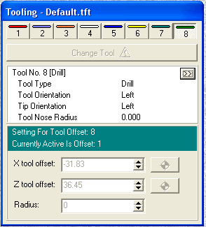

To restore the tooling setup and offsets: On the CD locate: VR Turning CD-ROM\VRTurn\Bin\Tooling Files\*.tft
Copy the .tft files to C:\Program Files\Denford\VRTurning\Tooling Files

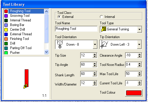

To restore the tooling library: On the CD locate: VR Turning CD-ROM\VRTurn\Bin\vrturn.ttd
Copy the file to C:\Program Files\Denford\VRTurning\
