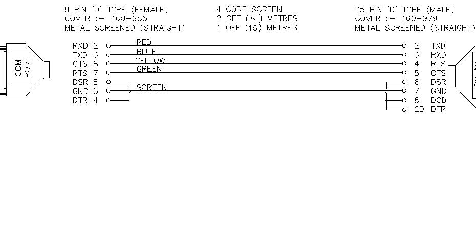

Information and programs that may be of help to you :D :D :D
RV-M1 Robot RS232 Cable details.JPG (41.88 KiB) Viewed 24073 times
