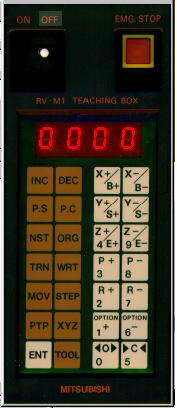

FYI - but on the older RV-M1 robots that Z pulse was as below :-
If the RV-M1 Robot is not nesting correctly it could be the Z phase pulses that are not within limits. Please refer to page 4-36 of the Robot manual, i.e.
By pressing NST 9 9 1 ENT this gives the Z phase pulse for axis J1 and NST 9 9 2 ENT this gives the Z phase pulse for axis J2 etc.
The limits for each axis are
J1 Minimum Value 30 Maximum Value 170
J2 Minimum Value 30 Maximum Value 170
J3 Minimum Value 30 Maximum Value 170
J4 Minimum Value 18 Maximum Value 78
J5 Minimum Value 18 Maximum Value 78
You have to re position the datum switches or the metal parts that activate the limit switches to get the correct Z Pulse values

there is no NST button on it
Re: Robotic arm RV 2AJ S12 Issue
I have not heard ot the Robo Explorer Program.
The NST button is on the RV-M1 teach pendant.
RV-M1 Teach Pendant.JPG (15.4 KiB) Viewed 95580 times

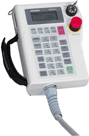

Teach Pendant attached to robots are similar to picture I just uploaded
How can I save teach Points?
Teaching Positions (A)
1. Controller key switch set to [TEACH]
2. Teach Pendant key switch set to [ENABLE]
3. Press [DEAD MANS BUTTON] in
4. Press [MENU] button
5. Select [TEACH] (Option No 1)
6. Select program [ABC] (Default) by pressing INP/EXE button
7. Keep pressed the [STEP/MOVE] (Servo’s ON) button
8. Press [POS] + [ADD] buttons together
9. Type a position number you want to teach e.g. 11
10. Jog the axes to the correct position
11. Press [STEP/MOVE] (Servo’s ON) + [ADD] buttons
12. Press [STEP/MOVE] (Servo’s ON) + [ADD] buttons again to
confirm REPLACE
Teaching Positions (B)
1. TEACH
2. ABC
3. POS (Release button)
4. 51 (Robot Position No you require to teach)
5. INP/EXE button
6. DEAD MANS HANDLE (PRESS IN HALF WAY ONLY)
7. STEP / MOVE (Servo’s on)
8. JOINT / XYZ
9. Jog axes with appropriate buttons
10. STEP / MOVE +ADD buttons
11. STEP / MOVE +ADD buttons (Confirms replacement)
Option (A) Move to a pre taught position
E.g. move to position 11
6. Select program [ABC] (Default) by pressing [INP/EXE] button
7. Press [STEP/MOVE] (Servo’s ON) then RELEASE
8. Press [POS] button
9. Type in the position No you want to move to e.g. 11
10. Press the [DEAD MANS BUTTON] + the [STEP / MOVE] button
(Once the Servo’s are on, release the [STEP / MOVE]) button,
then press the [INP/EXE] button (Robot beeps if everything is
OK) keep the button pressed in until the move has been
completed.
Option (B) Move to a pre taught position
E.g. move to position 151
7. Press the [BACKWD] button until there is no data visible
8. Press the [RPL] button TWICE until a clear line is opposite the
flashing cursor
9. Press [CHAR] (Character) button then press the M & O buttons
(These are multifunctional buttons)
10. Release the [CHAR] (Character) button then press the 1, 5 & 1
buttons
11. The screen should now read MO 151
12. Press the [DEAD MANS BUTTON] + the [STEP / MOVE] button
completed.
Opening and Closing the Robot Grippers
1. Press [DEAD MANS BUTTON] in and hold
2. Press the [HAND] button + [+C] button (Gripper CLOSED)
3. Press the [HAND] button + [-C] button (Gripper OPEN)

Whats different control of this teach Pendant and your uploaded teach pendant?
Your teach pendant is for the RV-2AJ Robot, the one i up loaded is for the older RV-M1 Robot
