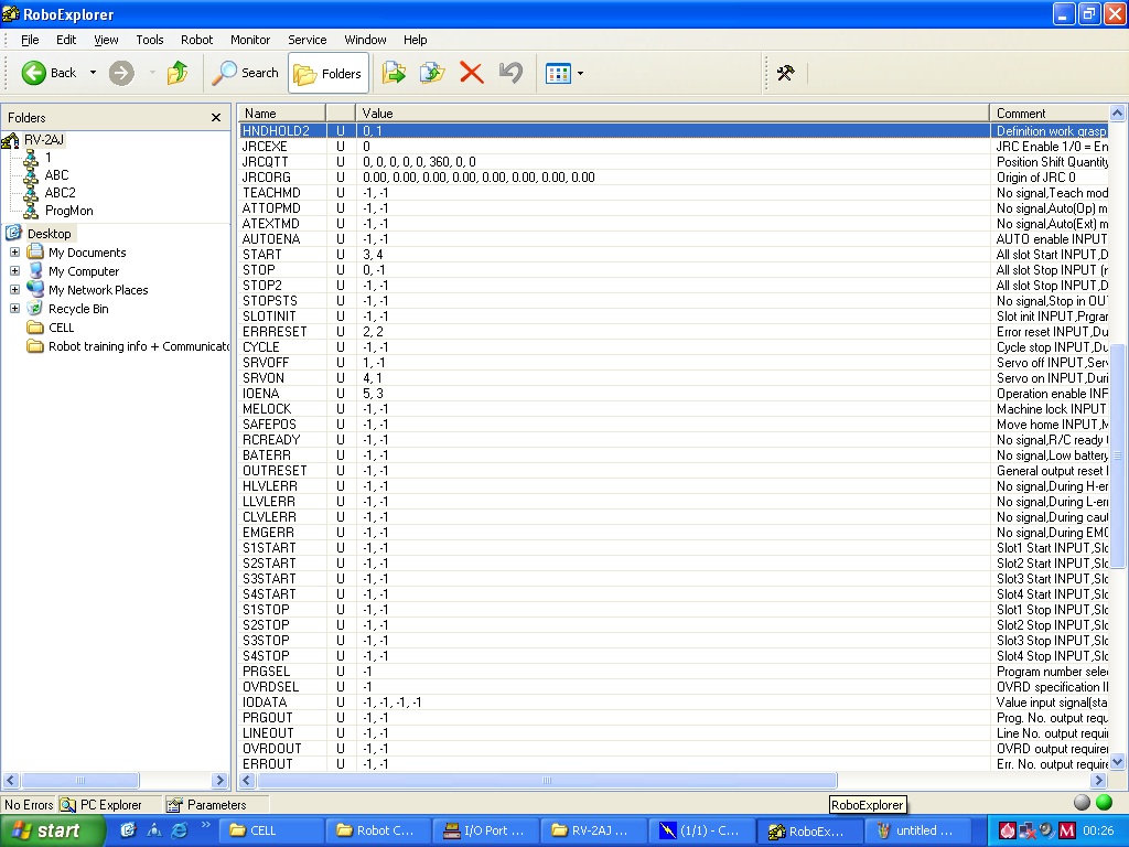

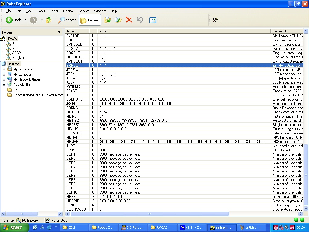

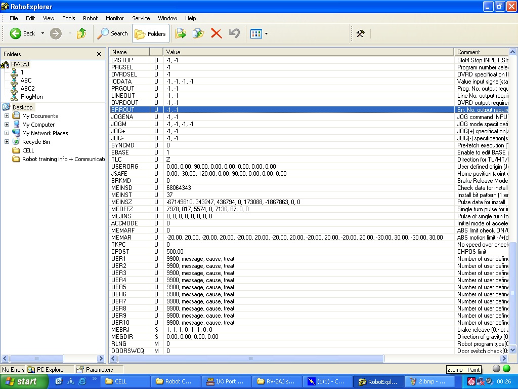

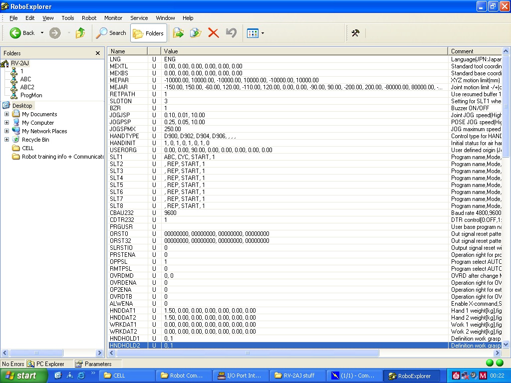

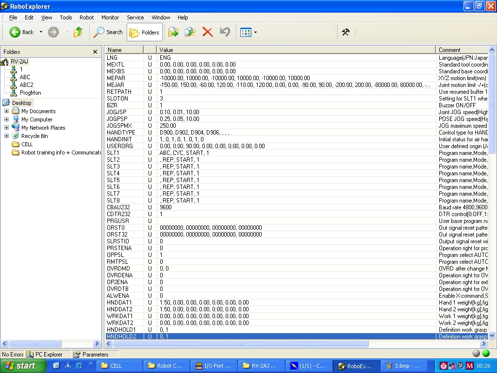

As I previously Describe we have two robots, One with Mill Machine, other with Lathe Machine,
I retrive list of parameters in those robots
Robot attached with Lathe is Working Perfectly Fine
But Robot Attached with Mill is not being controlled by robot Communicator.
I am uploading parameters details of both robots.
Kindly help me to resolve this problem as I have to complete My project as soon as possible.

- Lathe Page 3
- Lathe 3.jpg (283.82 KiB) Viewed 35992 times
- Lathe page 2
- Lathe 2.jpg (258.02 KiB) Viewed 35992 times
- Lathe Page 1
- Lathe 1.jpg (289.43 KiB) Viewed 35992 times
- Mill Page 3
- Mill 3.jpg (284.9 KiB) Viewed 35992 times
- Mill page 2
- Mill 2.jpg (259.13 KiB) Viewed 35992 times
- Mil Page 1
- Mill 1.jpg (289.53 KiB) Viewed 35992 times
Re: Robot Issue
Can they be saved as a text file which can be compared to find any differences ?

Re: Robot Issue
I have Compared it ........
Parameters values of MEINSZ
MEINSZ
MEOFFZ
are different
MEINSZ
MEOFFZ
are different
Re: Robot Issue
Those look to be related to the joint encoder pulses (ie, positions)
You'd probably expect them to be different.
I don't know what else to suggest now (I've never used these robots, so don't know what common problems are either)
