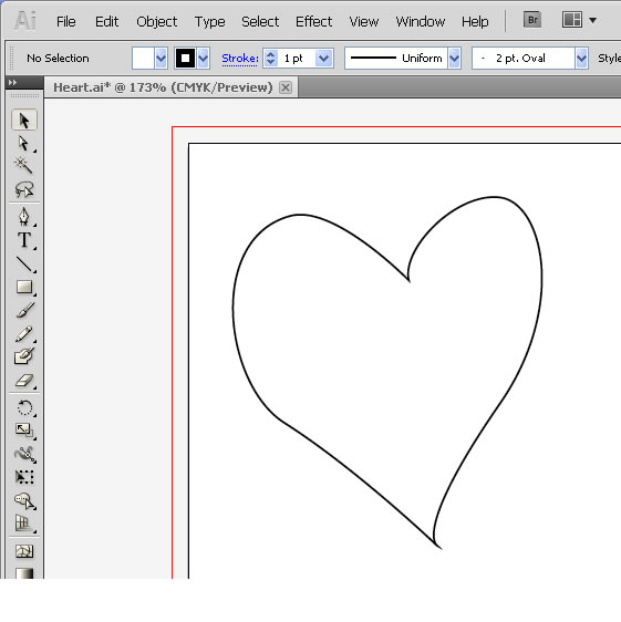

There is Object > Expand and you can also try Object > Path > Simplify
However, I tried it in Illustrator CS5 and the curve was exported as a dxf and it seemed to import OK - maybe you have a version with a .dxf export bug ?
You can try the .dxf I created...
