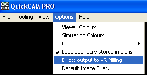

Because the normal user will be using a different INI file (settings), it may be that the option to output to VR Milling is not turned on..
Check it on the Options menu (see attached) ..
Turns on or off, the automatic output of cnc files to VR Milling v5
