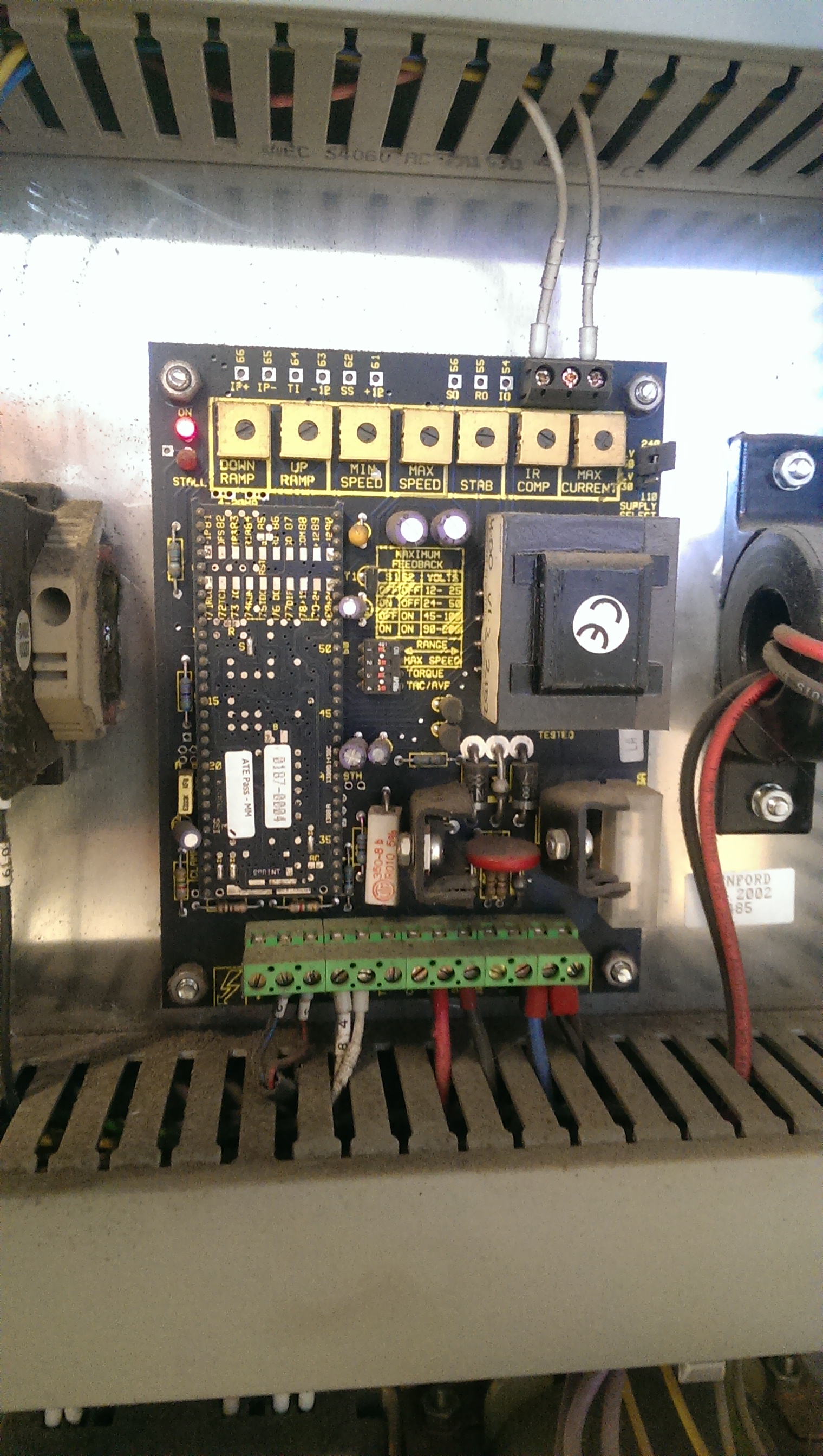

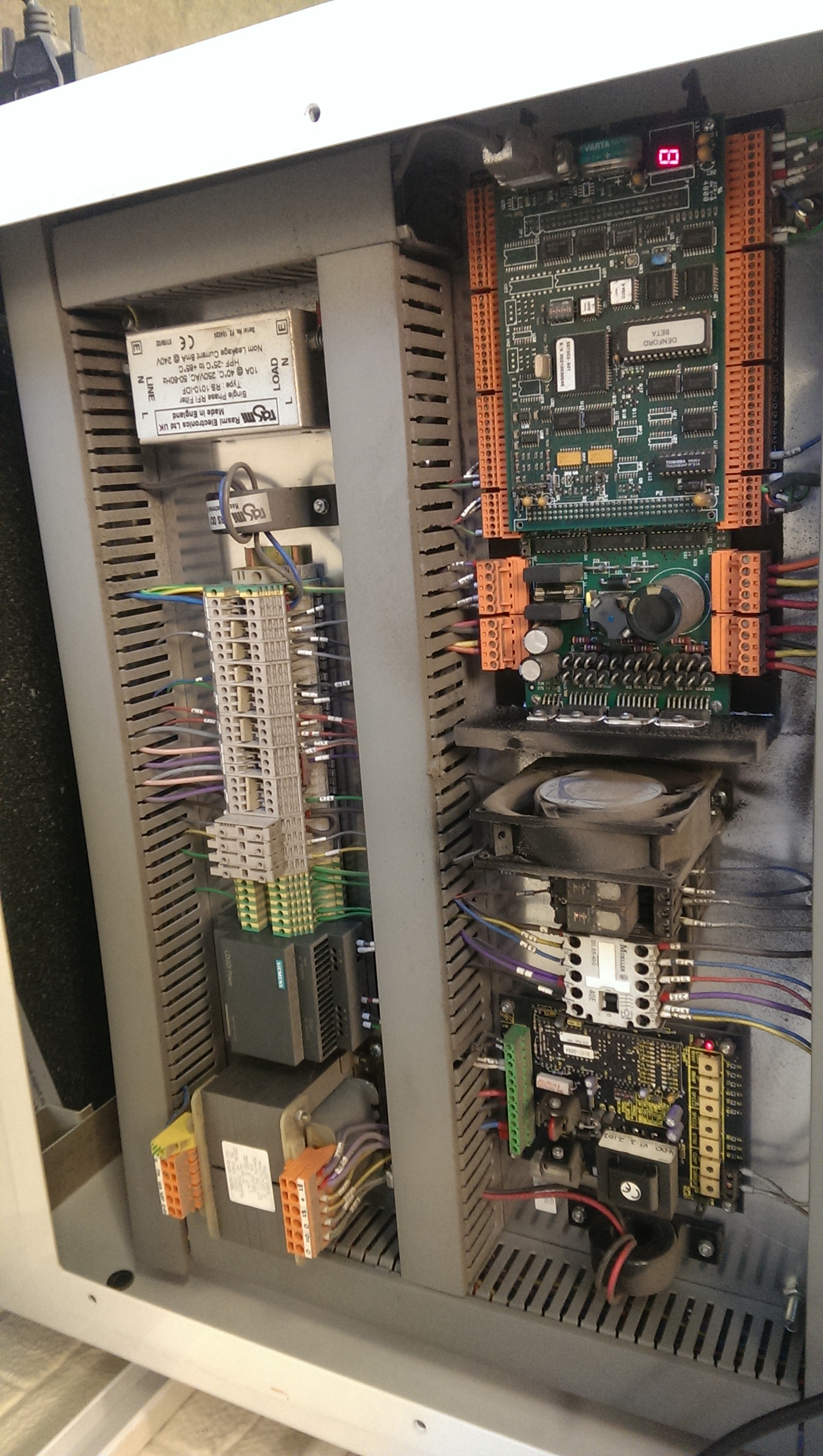

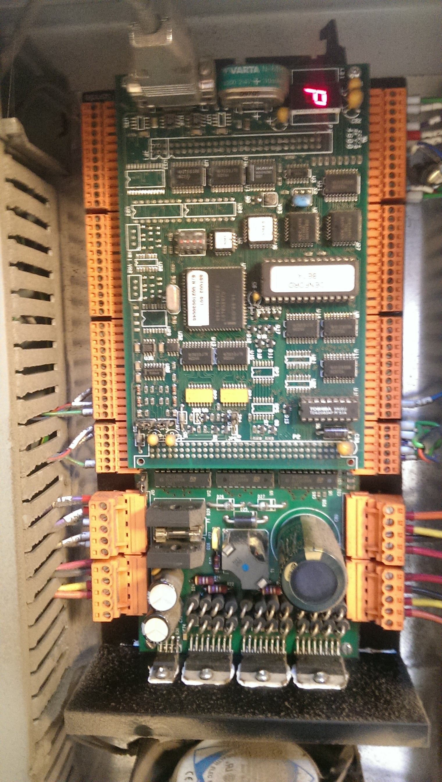

Ive attached 3 pics of the boards in the back of the machine listed above. (I had to rotate them as the site prefers portrait to landscape)
These were all taken while a program was running, The 7 seg display would swap between displaying P and 8.
The door was not locked either.

The Guardmaster is controlled by the zero speed output from the Sprint 400 spindle drive. It is the 2 white wires on the top right of the drive card. It should control one of the relays next to the fan & outputs 24 volts DC so you should be able to see if the relay is changing over & measure the voltage.

I hope that the guard is something simple like crappy contact. I will get to investigate on Thursday I hope.

Bit of an update. There was a meeting on after work so I could stop past 6pm, Ran chuck3 file via the old laptop again and the door was fine up until about line 6000. Then the door solenoid was firing open n shut almost all the time. Aborted the run and ran Chuck4 (the raster only program) The door would not lock at all. Couldn't understand how the heck the program code could mess up the lock as Martin had pointed out it is triggered by the Sprint 400 speed controller yet it had done the same with the raster program the other day too.
Whizzed the back off the machine while it was still running the program and grabbed my meter. Barely touched the terminal on the Sprint400 and the door relay fired. BINGO for this one... Dry joints on the connector on the PCB. So re-soldered and door lock is fine!!!!
Ill run some programs in the morning, I really hope this turns out to have been the fault and the arcing has been messing up the control. Ill need to check the other machine too now.
