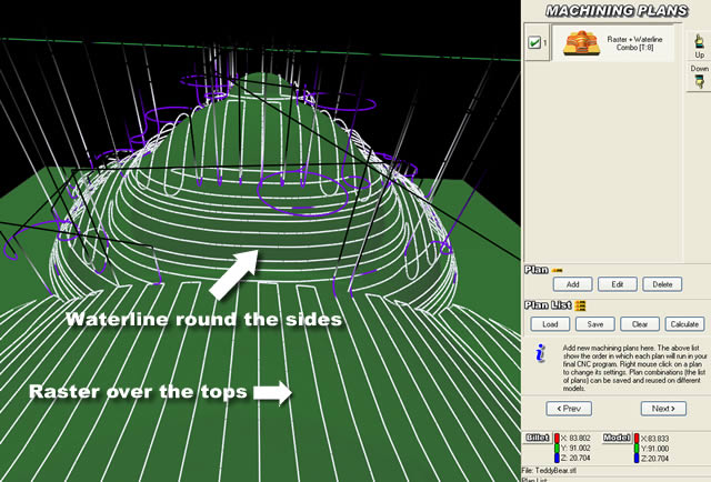

If you are creating the plans in QuickCAM PRO, then you should be able to use waterline milling to clean around a profile.
The problem is that during the raster cut, the tool tends to rip out the edges slightly due to the heavier cutting forces - especially MDF.
Then when you come to clean around the edges with waterline or pencil milling, the tool is unable to clean up the marks fully.
The solution here is to rough raster with a finishing amount included - this leaves stock on the whole of the model.
Then finish raster with no finishing amount, then pencil or waterline around the edges.
Alternatively, try the combined raster+waterline plan which raster over top surfaces, and waterlines around the steeper sides (see picture)
- The Raster and Waterline Combo machining plan in QuickCAM Pro (not available in QuickCAM 3D)
