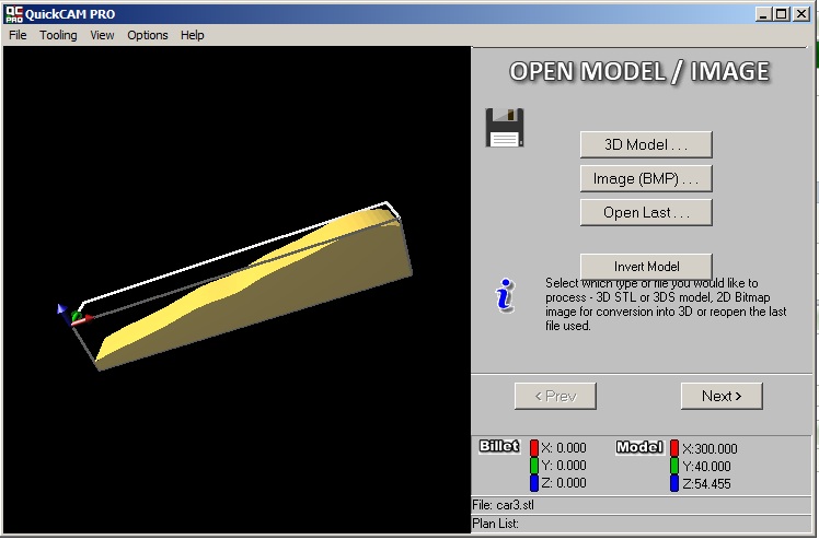

Re: STL problems
I have downloaded and opened in QuickCAM PRO without problem.
What was your problem?
- car 3 .jpg (70.39 KiB) Viewed 35517 times

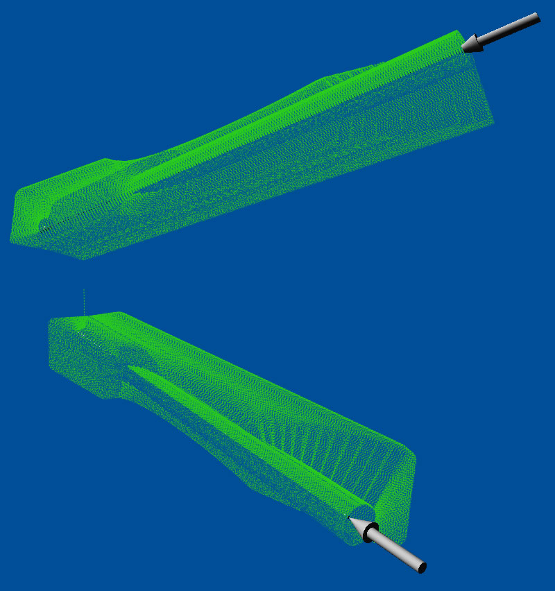

Re: STL problems
when we put this this through QuickCAM 4D a 'hole' appears in the base....please see attached screen shot

- Posts: 3651
Re: STL problems
We think we may have fixed the issue with holes on long triangles.
Can you try this BETA file out for us?
https://www.denfordata.com/downloads/Qui ... 10-exe.zip
It's just the QuickCAM4D.exe file so will just need copying into the program files directory.
Make a backup of the original QuickCAM4D.exe file before replacing it - just in case!

Re: STL problems
our IT dept has done as asked and no difference in the holes appearing during a cutting path being made.
they have returned the orig. exe. file
many thanks for you support on this and i hope you can find a solution to the problem...if there is anything else we can do at our end please ask
