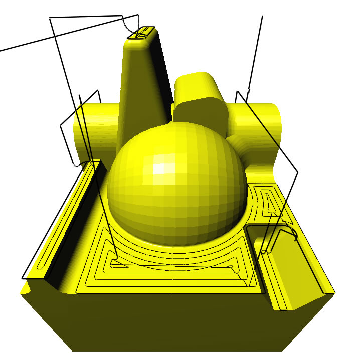

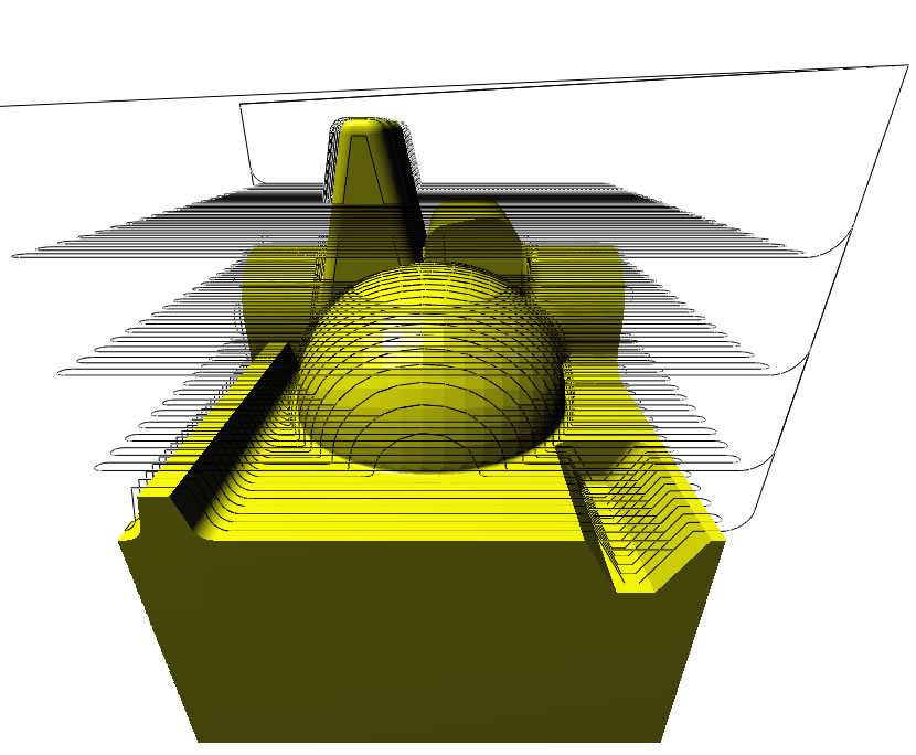

The pro version has more "fancy" machining types available:
- Raster roughing and finishing.
Also includes a raster + waterline combination plan - Plan_RasterRoughing1.jpg (93.23 KiB) Viewed 29695 times

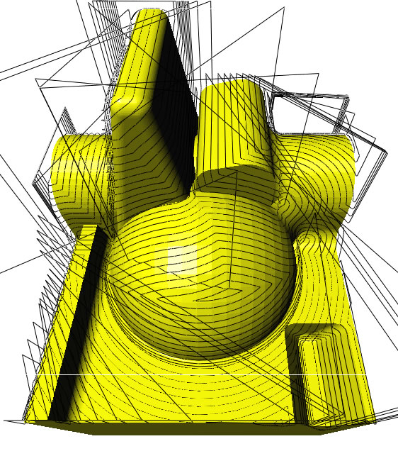

- Waterline milling
- Plan_WaterLine.jpg (185.29 KiB) Viewed 29695 times

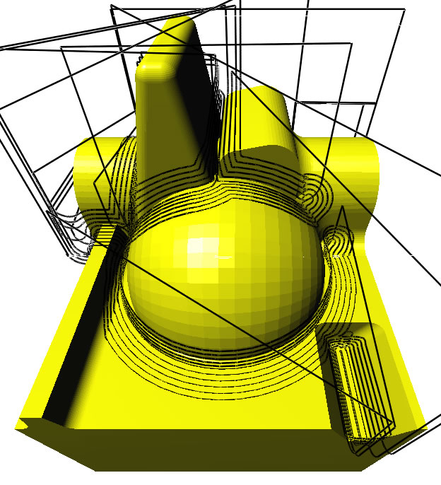

- Pencil milling
- Plan_Pencil1.jpg (68.89 KiB) Viewed 29695 times

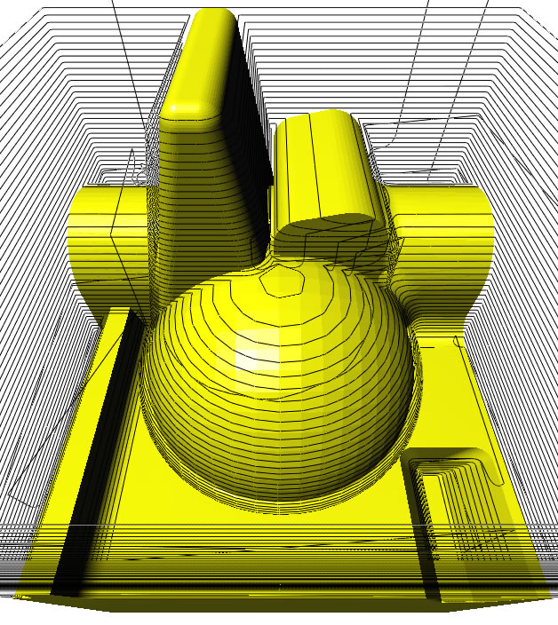

- Parallel Pencil milling
- Plan_ParallelPencil1.jpg (116.14 KiB) Viewed 29695 times

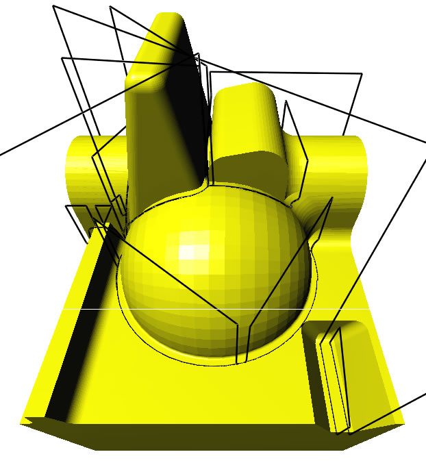

- Horizontal Area Clearance
- Plan_HorizontalAreaClearance.jpg (84.21 KiB) Viewed 29695 times

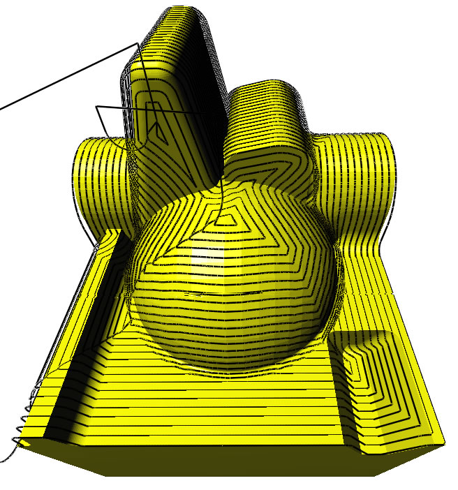

- Corner offset
- Plan_CornerOffset1.jpg (157.17 KiB) Viewed 29695 times

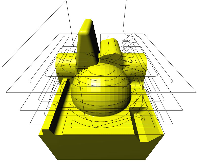

- Area Clearance
- Plan_AreaClearance1.jpg (93.3 KiB) Viewed 29695 times

QuickCAM PRO has the same cutting stratergies as 3D plus lots of others. The other stratergies would allow you to improve the finish on a car. While the basic raster finishing is the quickest option there are contour lines left by the cutter. The other stratergies would allow you to finish areas of the model (using the custom boundary option) then add additional machining plans.

For making F1 cars, a raster plan is usually enough to get a good enough finish (before finish sanding by hand)
