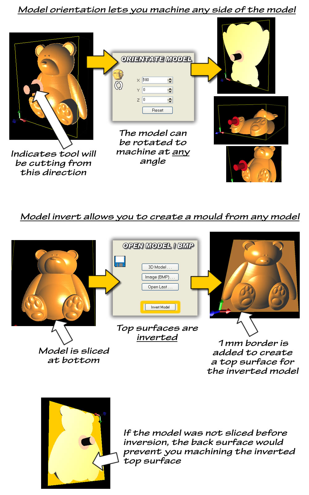

I think you have misunderstood the difference between Orientate and Invert.
Invert is only there as a quick way of making a mould from a model, but if you seriously wanted to create a mould, you would create it properly (ie split in two, with pouring holes and draught angles) in the CAD software first.
Orientate lets you machine any side of the model, from any angle.
- QuickCAM-Invert-Orientate.jpg (209.8 KiB) Viewed 25885 times
