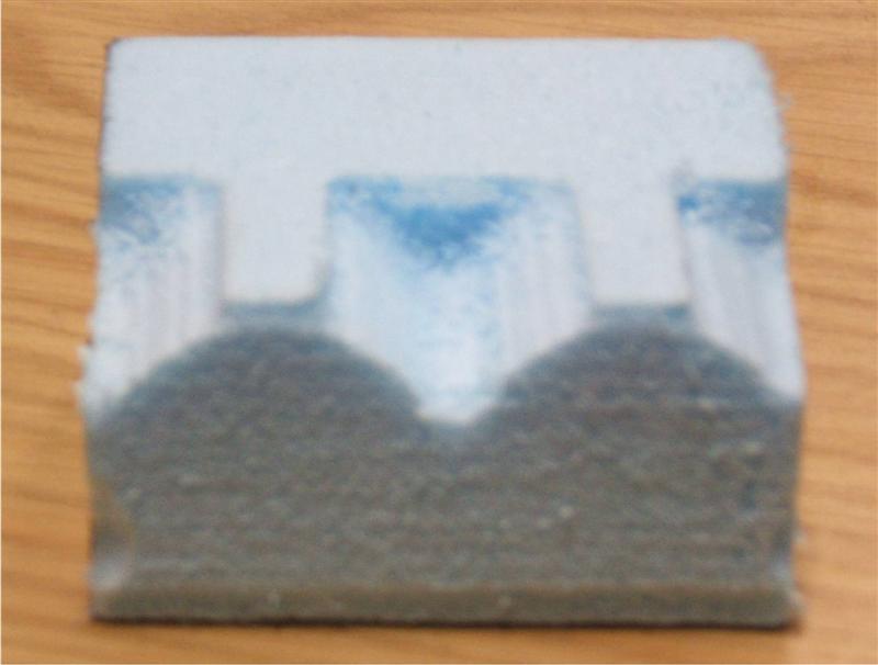

This one clearly shows the steps that I keep getting on many of my bottle shapes that have been cut recently.

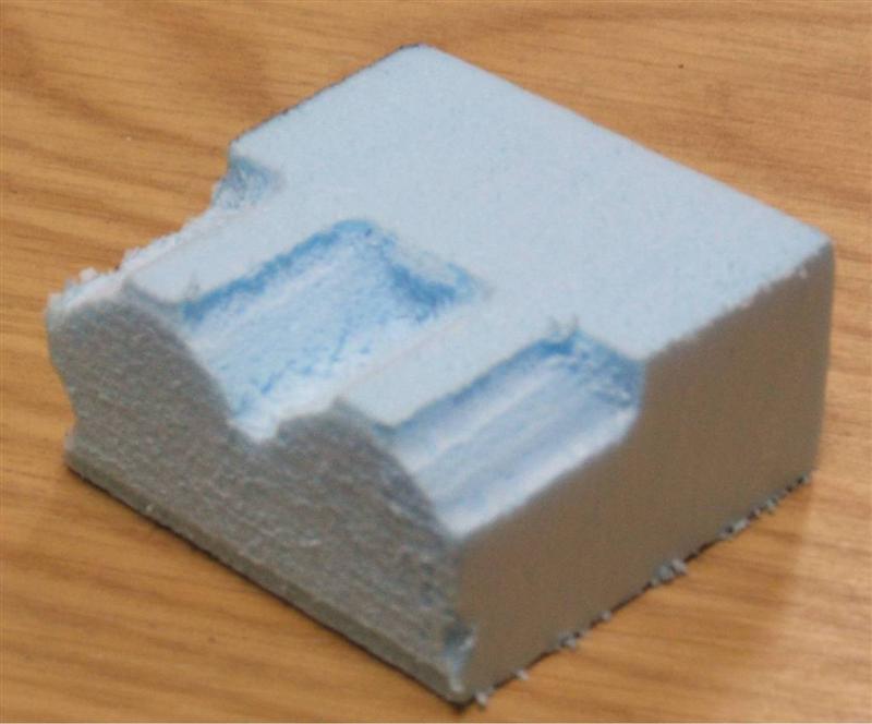

A little blurred but it does at least show where the curves should be on the front (but machine is not cutting all the way through).

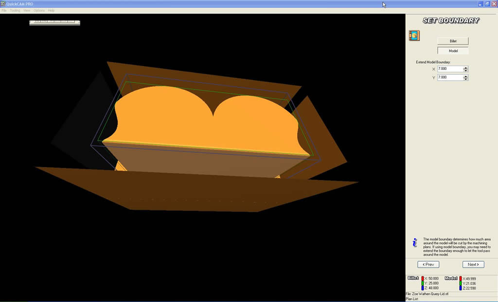

Post by Steve » Tue 29 Jan , 2008 18:43 pm
Thanks for the pictures. :)
There is a page in the wizard where you select the boundary of the model. You can set it as the model or the billet and you can extend the boundary. :!:
The boundary sets the distance the tool center must work within. If you want to cut around the profile of the part you must extend the boundary.
If you want the tool to go down the side of the block you must have either material there or extend the boundary by at least the tool diameter.
In your case the tool centre could not go outside the block so could not cut the edges.
My screenshots are a bit large too! :oops:
If you do the same again but either increase the block size so you have at least 7mm round each side of the part or extend the boundary as shown in the attached jpg it will work. :D

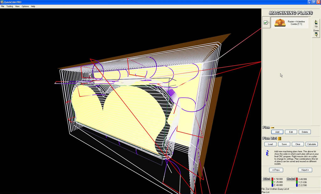

I would suggest a better strategy would be the raster waterline option see image as this will leave smoother sides and a flat top. :idea:
boundary to model extended.jpg (34.96 KiB) Viewed 13772 times
Raster + Waterline.jpg (87.15 KiB) Viewed 13772 times
