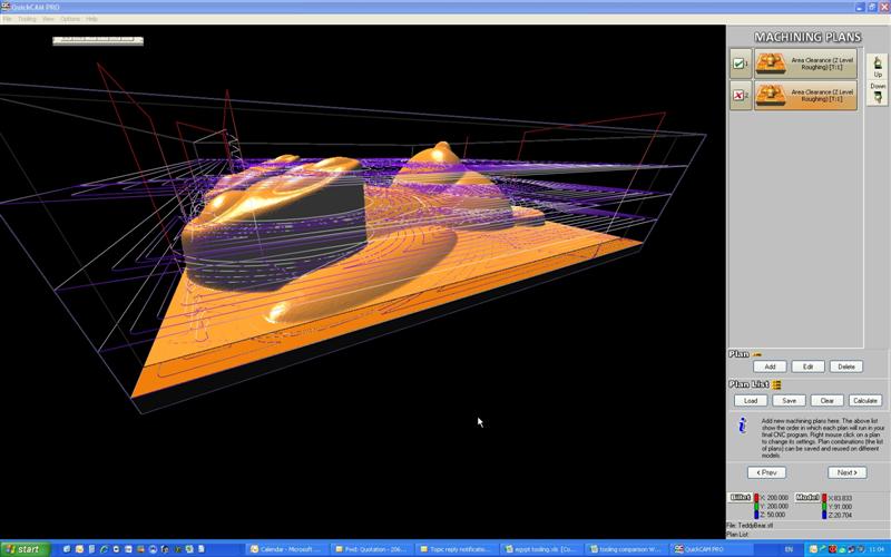

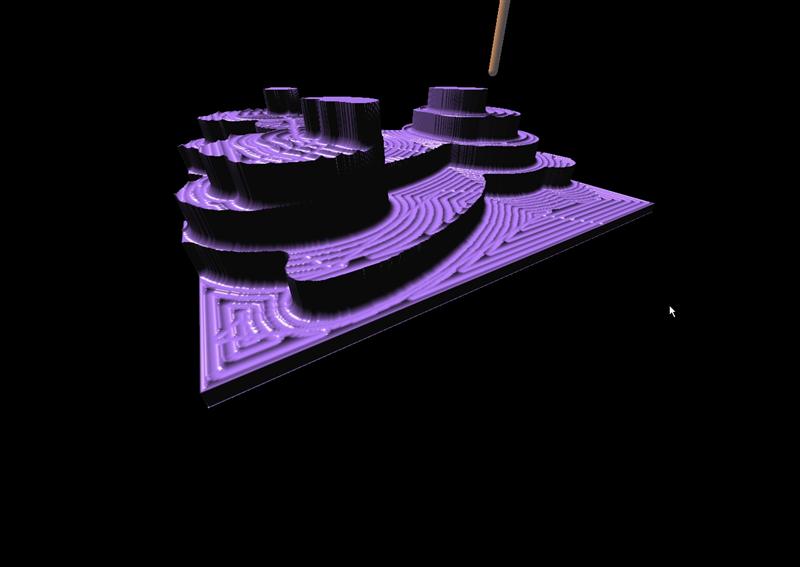

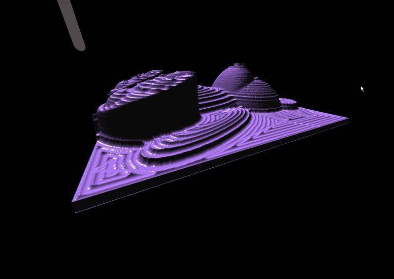

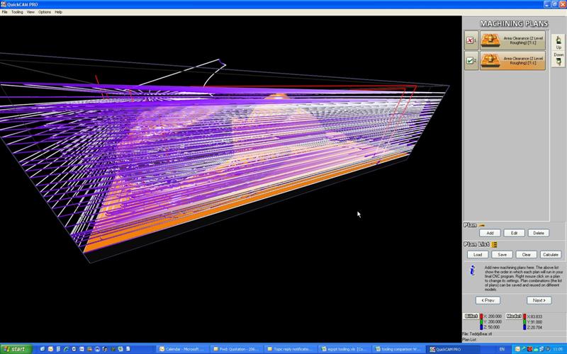

Actually, I have an immediate question regarding controlling the step down when using QCPro.
Does setting the step down for a cut impose a maximum step down if Adaptive Step Down is checked?
i.e. When using a 2mm cutter I set step down to 1mm and check Adaptive Step Down. Does this mean the step down will adapt but never exceed 1mm?
Re: What Value To Use For Tooth Load?
If you set the stepdown to 12mm the cut will not exceed 12mm in one pass.
If you select addaptive stepdown then the cutter will create multiple passes if the sides are slopeing
See the samples below.
Note if you are carrying out a finishing pass then the software assumes that the model has already been roughed out and goes to full depth from the start.
So if you had roughed the model as shown below with addaptive stepdown off the roughing takes much less time but in places the finishing pass could be removing 12mm of material.
with addaptive stepdown on the finishing pass would be much lighter.

I believe that adaptive stepdown should work like that. My understanding is that if there is a surface at 3.35mm (ie between 3mm and 4mm) then it will create a stepdown at 3mm, 3.35 and 4mm if the stepdown is set to 1mmPhil wrote:Actually, I have an immediate question regarding controlling the step down when using QCPro.
