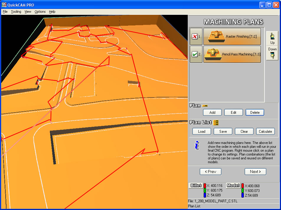

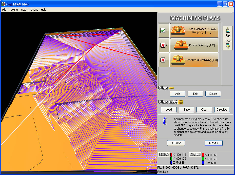

1. Area clearance with a large slot(flat) drill
If you're cutting a hard wood, you may need to remove a lot of the material first

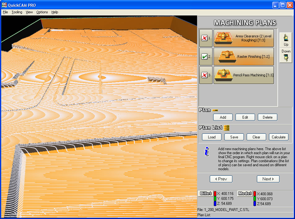

2. Raster finishing with a ball nose (small enough to fit into the smallest feature)
3. Pencil pass machining with a slot drill to remove the radius'd corners left by the ball nose.
Pencil milling with a slot mill will follow the contours and clean away the radii left by the ball nose cutter

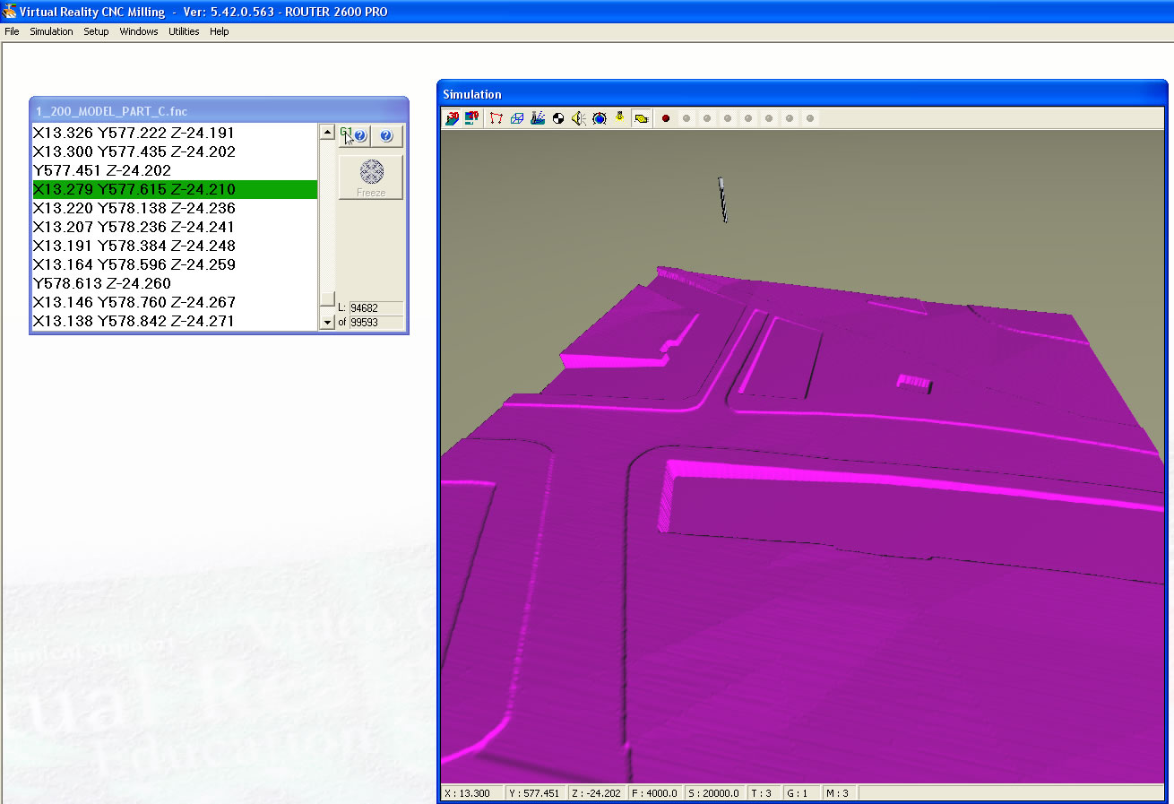

Because the model is large, then both the Quickcam and VRMilling 5 simulations will struggle to show it in fine detail, but as I said, start with a custom boundary and see what the results are like.
