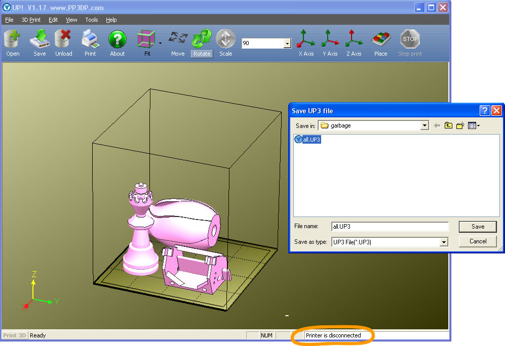

I'm not sure what version of software you are using but my 1.17 version will run without needing an UP! printer connected.
If you want to place, rotate and scale a couple of models while the other printer is running you can either:
1. Disconnect the machine USB cable once it has finished sending the current print and then use the UP! software to prepare the next print
or
2. Use the UP! software on another PC to sort out the next print, place your model(s) and adjust them, then click the menu Edit > Merge. Then File>Save and save the 'plate' as an .UP3 file which can be loaded back into the software again and will retain the size, position and orientation of the model(s)...
