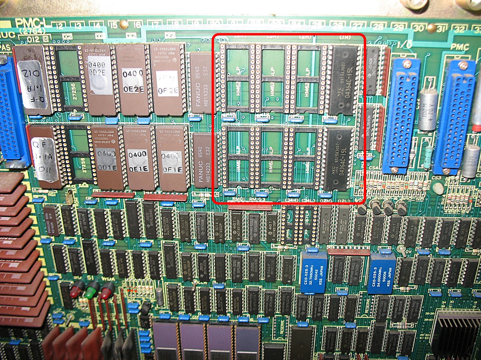

Re: Fanuc OM upload/memory problems on Quatromill
please see attachment.....I guess these are the memory chips. Can you tell me what I have?
Note the existing chips appear to be directly onto the board and possibly soldered?? i.e. the presentation is not like the vacant slots. As a result, I have not attempted to remove and re-seat until confirmed they do actually come out.
One other point of interest is that I set param 901 to bit 4 (2 chips = 16K ????) and I still get the 911 alarm. The interesting thing is that PROG, P just picks up whatever you have set the bit to, NOT the capacity of the installed chips.
Thanks for the Ebay link. I see this seller has exactly the same chips I have installed. Presumably, if I get half-a-dozen and fit them in the vacant slots it may solve the 911 alarm??
- fanuc memory.jpg (1.14 MiB) Viewed 50177 times
It's certainly worth fitting new chips and setting the memory to full.
Those existing chips do look soldered so all you could perhaps do is re-solder the back of them...could be difficult to get at.
I think the 64K chips are the ones to go for but can't be 100% sure...I can't find the post triac_whizz did a long time ago when he upgraded his
I can get identical chips to those in the attachment NEC D43464C-15L
Are these 4k, 8k or what?
I believe the PCB is an A series and max is 48k, so not capable of 64k chips
Also, just reading through one of these posts:
viewtopic.php?f=33&t=3120
viewtopic.php?f=47&t=2444
And noticed something about the RAM parity chips..you may need to add those as well. They are probably the smaller sockets just below the big RAM sockets.
Double check by looking at the two to the right - do they have the same code as the silkscreen printing under the sockets ?
Google the chip codes and see if comes back as RAM parity or RAM control etc..
PS just seen your post and those other links mention 32K chips. Try PM lone_ranger as he seems to know more about it.
Please post back your findings though!
Thanks. I think from reading the other posts I have only 4K on the board........which would explain exactly why I am getting a 911 parity alarm on files over 4k!
To help others with a similar problem in the future I would state that (certainly on an OM series A control) what is entered in param 901 is meaningless. The software just picks up what is entered and shows that in PROG, P, INPUT. It does not cross-reference the chips installed, neither does it throw up any alarms or issues if the bit setting is wrong. This may be different on other controls, as it seems to be contrary to what some say in other threads I have read, in that it MAY throw up a system error.
What I can say is I have had various bits set over the last weeks and after power up....no effect what so ever on the operation of the CNC.
The problem now understood, clearly an upgrade is called for! I have PM'd Lone-ranger (Rob) to advise on the memory chips (I do not know the serial number for the 32k chips) but even the 2k? chips on Ebay (NEC D4364c-15L) would presumably give me a total of 16K in the interim (at £1.46 each I won't lose sleep if they don't work). Wow, if I had 4x my current memory....think what I could do!
THANKS "DENFORD ADMIN"
I think the 64 part of the chip means they are 8Kbits x 8address bus (ie 64Kbits total or 8Kbytes)I can get identical chips to those in the attachment NEC D43464C-15L
Although that would suggest you had 16Kb already fitted
If anyone could clarify what works in a Fanuc 0-model: A,B and C that would be great !

I managed to get some NEC chips identical to the embedded ones in the scan and fitted them in the expansion slots. The good news is I can now upload about 1100 lines of code. I believe I have 16k memory now....which does not sound a lot but I have found is plenty for 2-D work.
It may be there are some higher capacity chips that would take the memory to 48k on my OMA control but I did not have any information and stuck with the ones already installed. If I find out a serial for these I will post up.
Just a word of warning to any would be upgrader.......to make the new chips effective, a RESET + DELETE is required on the console, which wipes memory clean. Therefore it is important to have all your parameters and offsets recorded because they will be deleted. It took only about 30 minutes to re-input the params and offsets once I had installed the memory.
One suggestion made when I had the initial problem was to "enable" more memory using param 901. In my case, no extra memory was there on the board! However, I did try a number of different bit settings before I located the chips on the PCB....and basically I followed the advice and tried freeing up memory (that might not have been enabled at the commissioning of the machine). I found no noticeable effect on the machine, irrespective of what bit was set on param 901, and concluded it was just a software switch for the purpose of calculating the memory stats (PROG + P). The param doesn't cross-ref the hardware and just calculates free memory from whatever bit you have set in 901. This is just an observation and something I tried before I found where in the world the memory chips were on the PCB!
The serial of the chips I got: made by NEC "D4364C-15L". (28-PIN SRAM). I can confirm these work fine on a Fanuc OM-A, all-be-it only 2k each but I find if I only have 1 prog on the machine I can get by fine. Now I can combine a number of sub routines that I formerly had to run separately.
The simple reason why I was getting 911 alarms was the memory was FULL. Essentially, any upload greater than about 250 lines was failing to upload with a 911 alarm.
