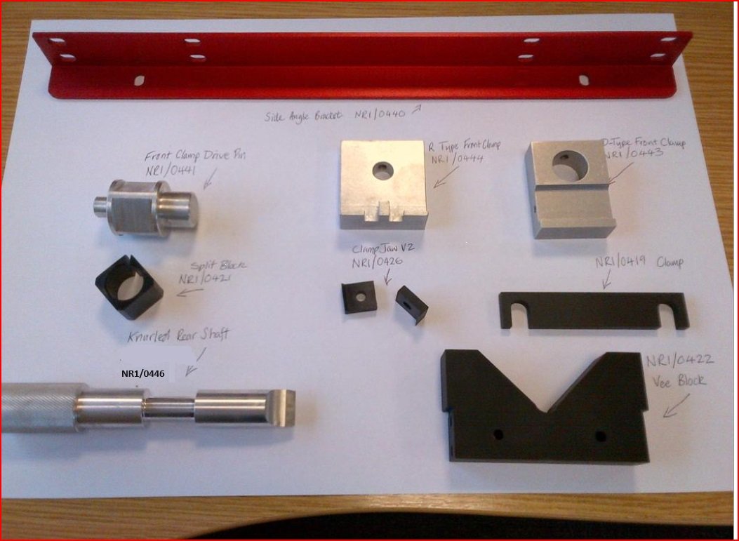

Post by Steve » Wed 22 Feb , 2012 10:50 am
Denford F1 Fixture Parts Description..
F1 Fixture Parts (Large).jpg (77.86 KiB) Viewed 20617 times
Re: Denford F1 Fixture Parts Description
Post by Martin » Mon 02 Sep , 2013 10:56 am
The part numbers shown here are for a qty of 1 of each item.
If you need the NR1/0426 then you need to order 2 of these.

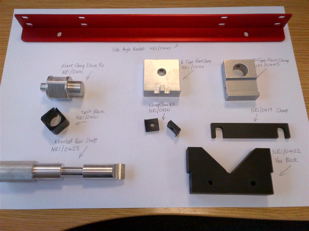

Post by Steve » Tue 14 May , 2024 9:20 am
With the introduction of the F1 Model Block made of foam the bore of the billet was reduced to 18mm.
As a result the spiggot is now a smailler dimension
