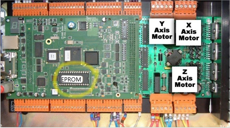

Post by Steve » Tue 16 Mar , 2021 9:29 am
EPROM LOCATION NEXT STEP CARD

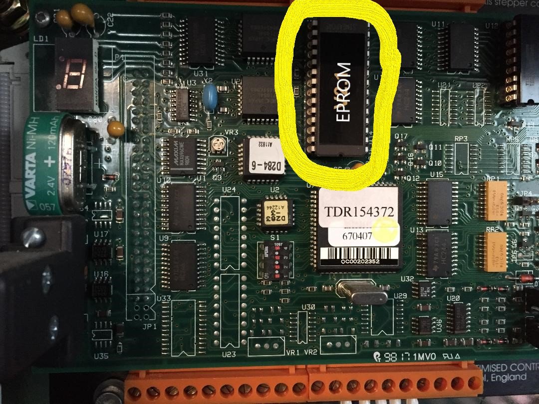

Post by Steve » Wed 24 Mar , 2021 9:39 am
EPROM LOCATION SMART STEP CARD
SMARTSTEP EPROM.jpg (218.83 KiB) Viewed 20448 times
