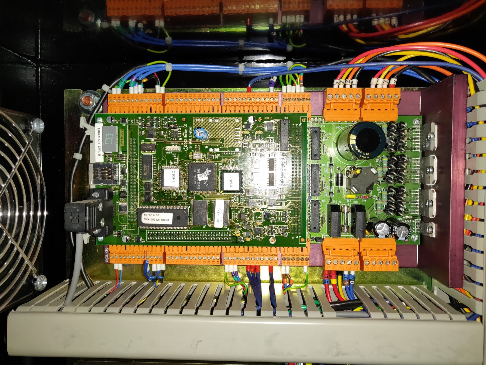

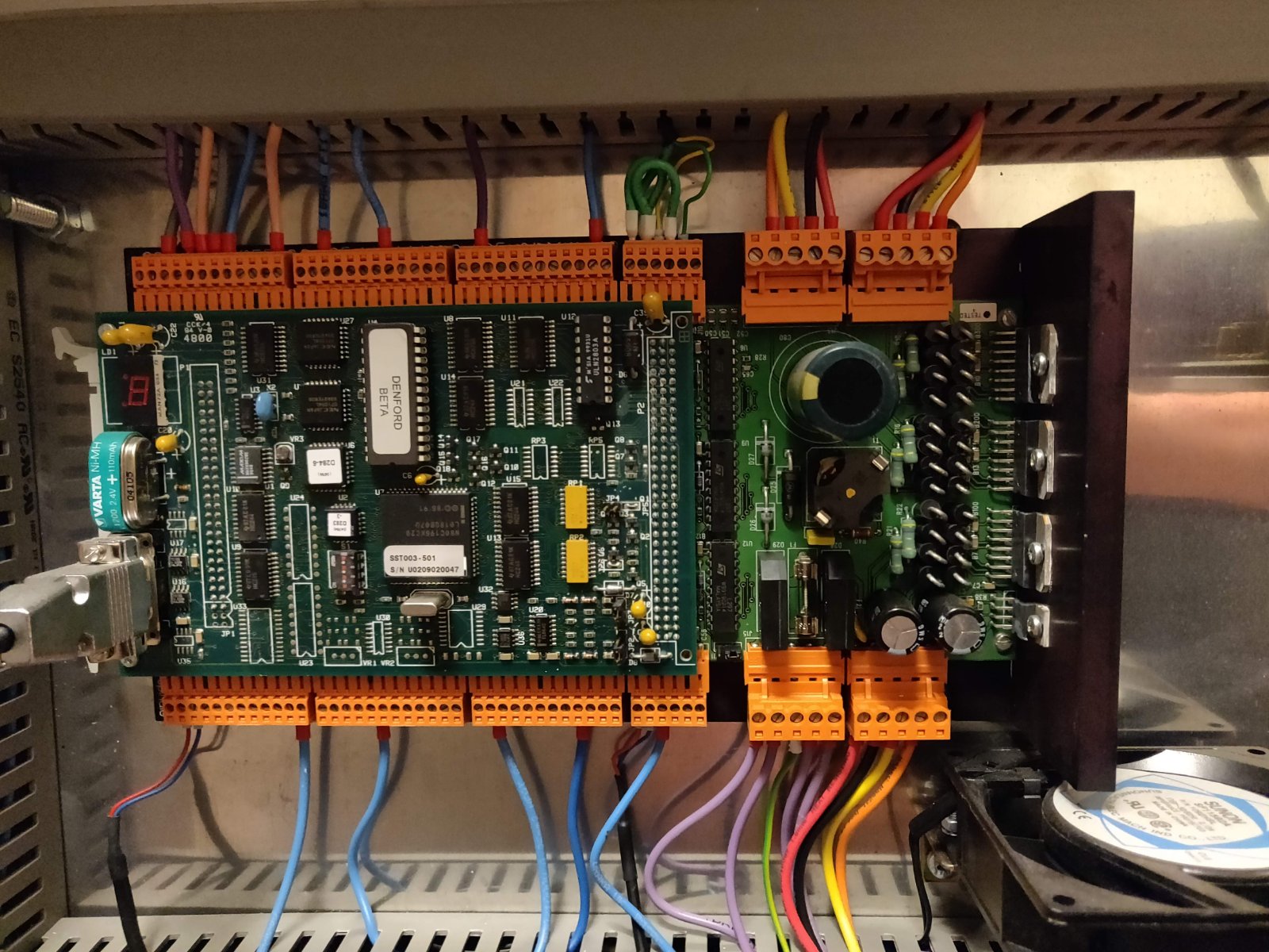

Without going in to the details of why, I am downgrading my novaturn ns from a Nextmove card, to a Denstep card. Will the DS Card control the lathe the same way as the NS? Will I need to specify the machine is a novaturn (no ns) to vr turning? Were the original (non ns) novaturns set up the same way with the same hardware, but with a denstep? I am just concerned about spindle and ATC controls functioning. Please let me know if you have any experience with a (non ns) novaturn, or if you are aware of any hardware changes.

If you go into the machine setup (denny) you can look at the parameters but i'm not sure if there is more to it than that.

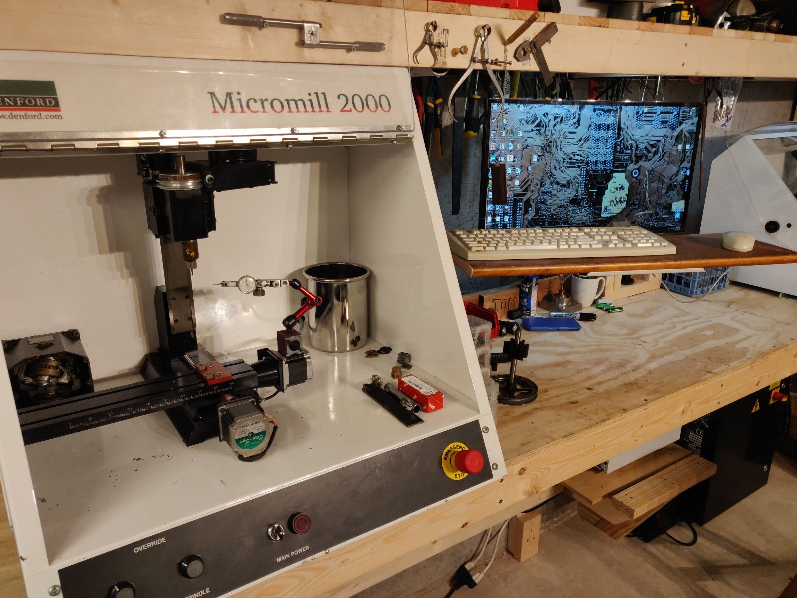

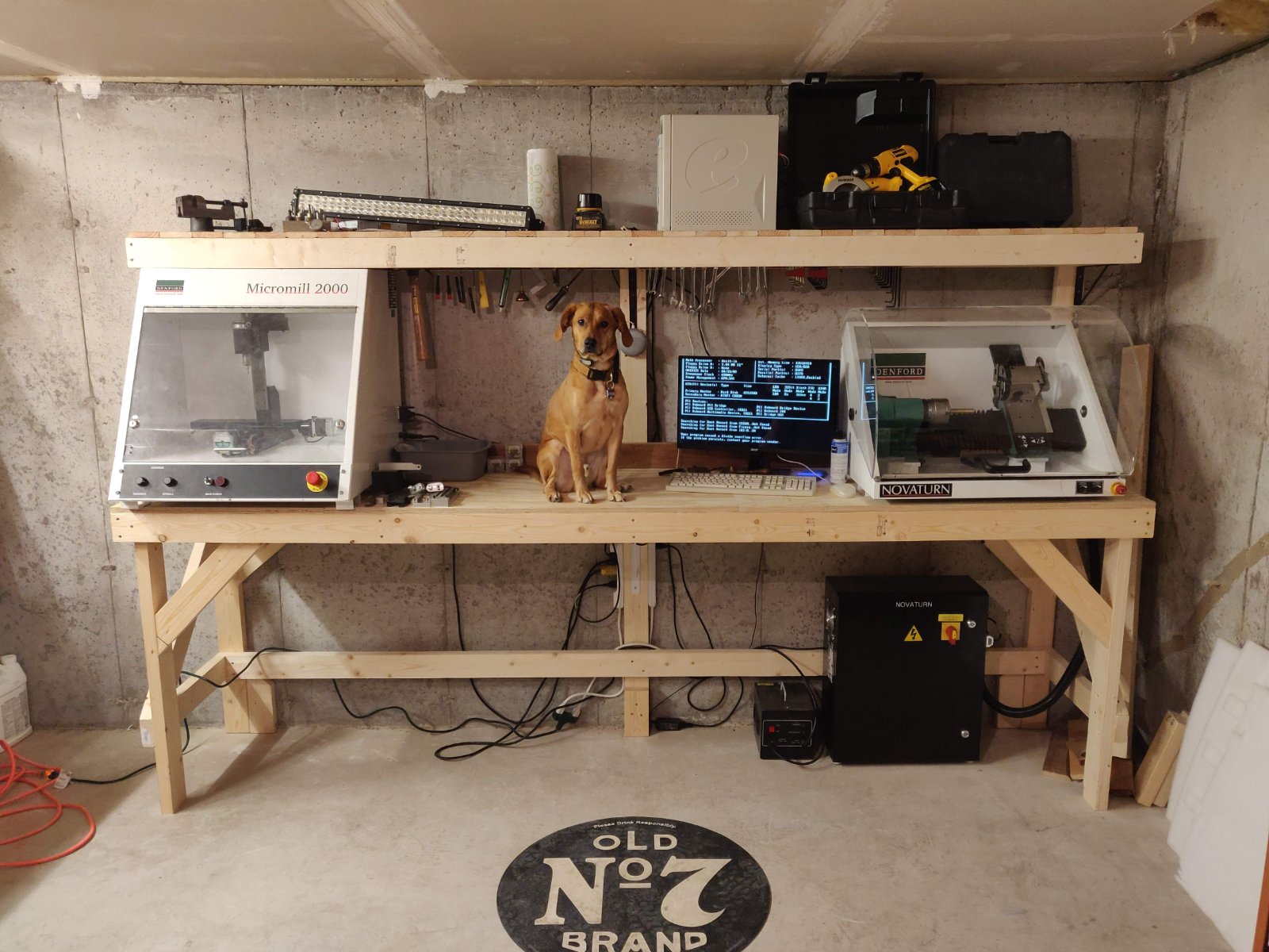

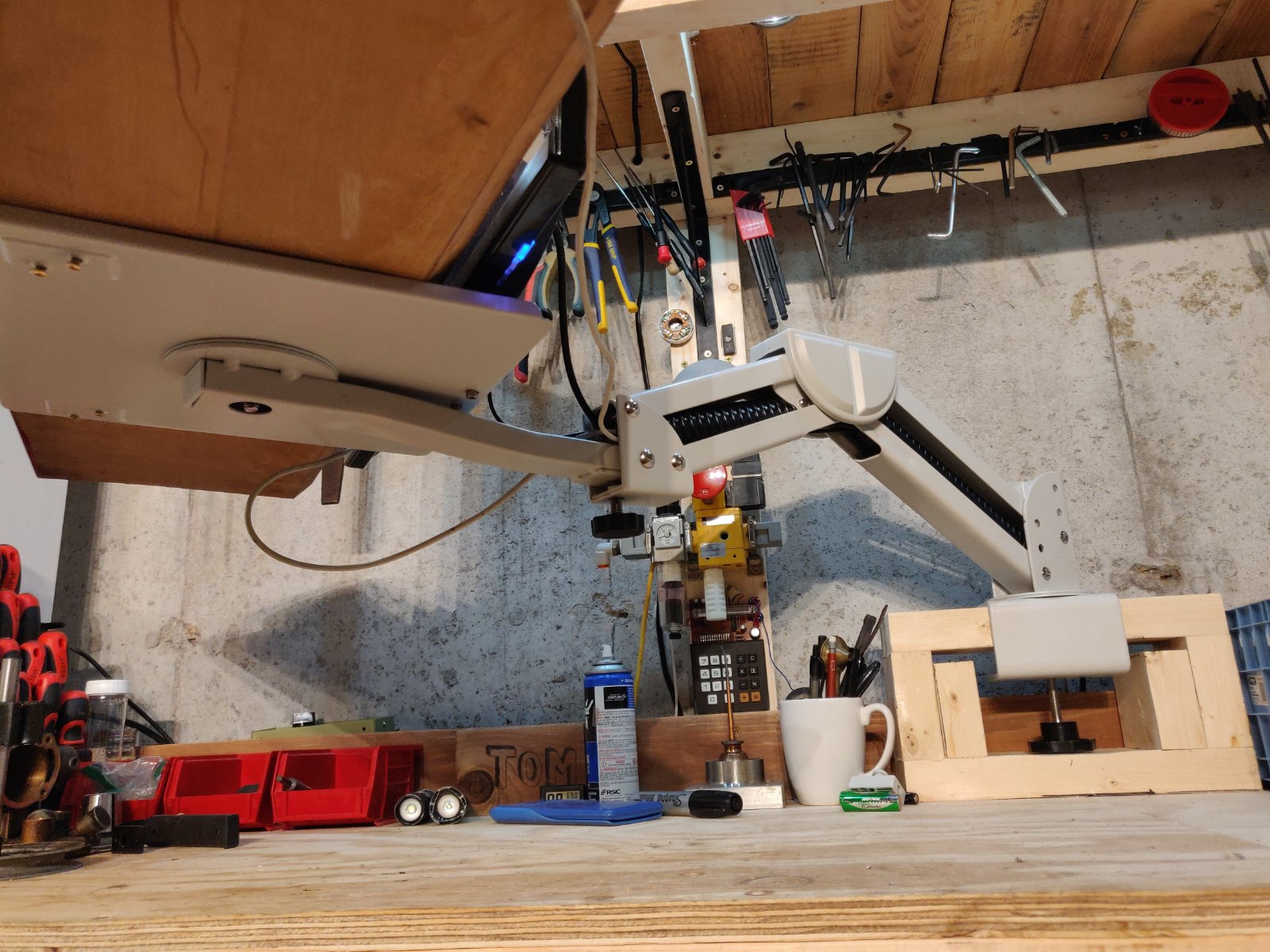

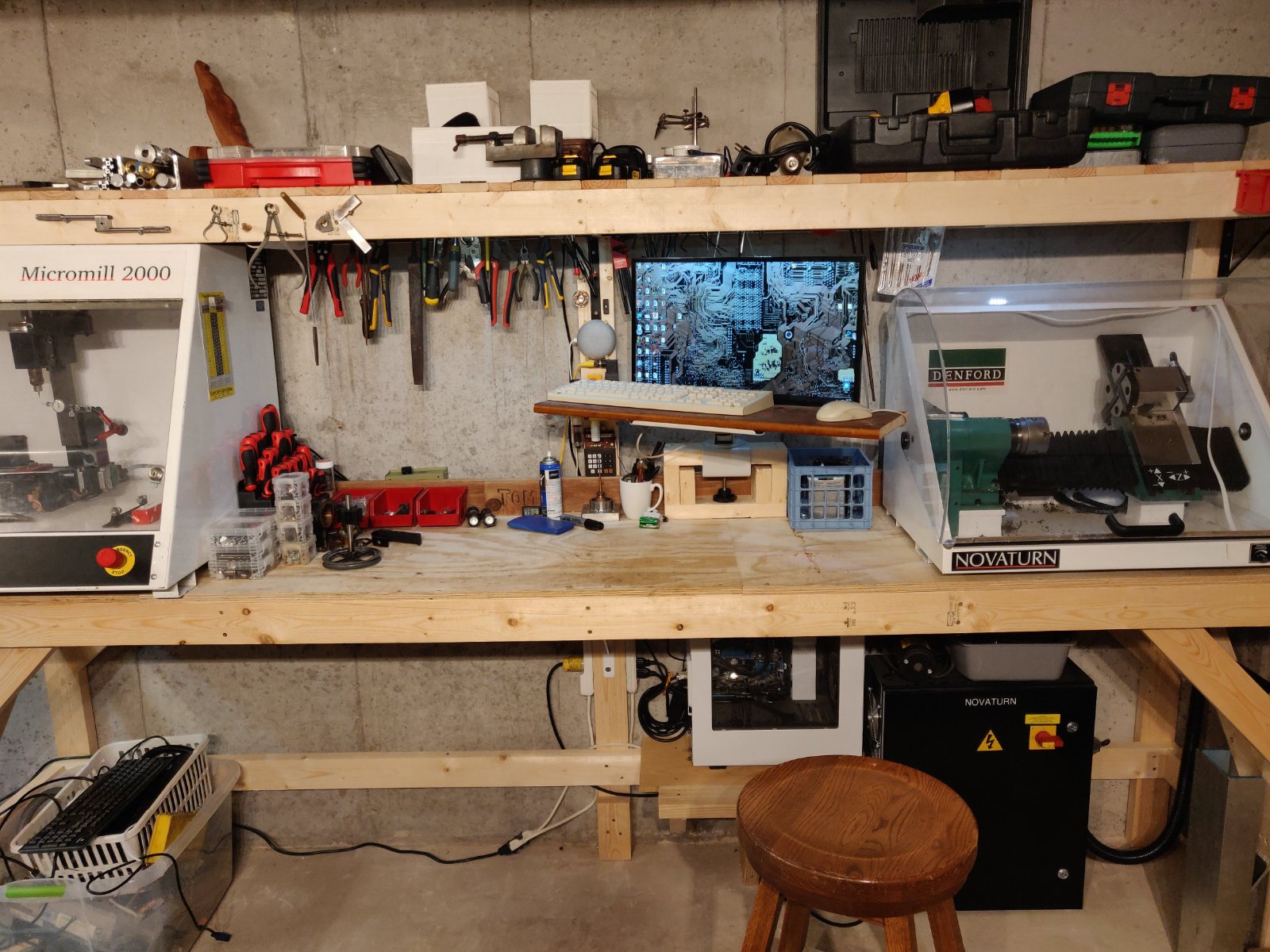

I have made some updates since then, namely to the PC. in attempts to modernize haha. I was able to find an old monitor arm for a crt, so i am mounting all my peripherals on that. It allows me to pull the monitor, keyboard, and mouse right up to the machine Im using! Im pretty excited about the arm. You will notice I am starting to get the nice oil stain started on the benchtop. So it begins!

We used to have an arm almost identical to that back in the early 90s it was between me and another guy at work but we had the phone on it!
I have become a huge fan of danish oil on wood, couple of coats with a roller and a wipe down :) I needed to do a quick shelf and couldn't wait for paint to dry!
A while ago someone was posting about using USB number pads, it meant you didn't need the whole keyboard at the machine when setting zero,

good call on just having separate mouse and key pads... I would be able to get rid of most of the arm's bulk then, and I am a big fan of that idea.

I was looking at your pics again, I don't know if this could give you any issues in the future but you have a mag base DTI on top of a stepper motor, Wonder if the magnet could impact its operation.

good question! I have not tried to use the motor with it on there, in this case I was using it to check runnout, then stuck it to the cabinet shortly after!
