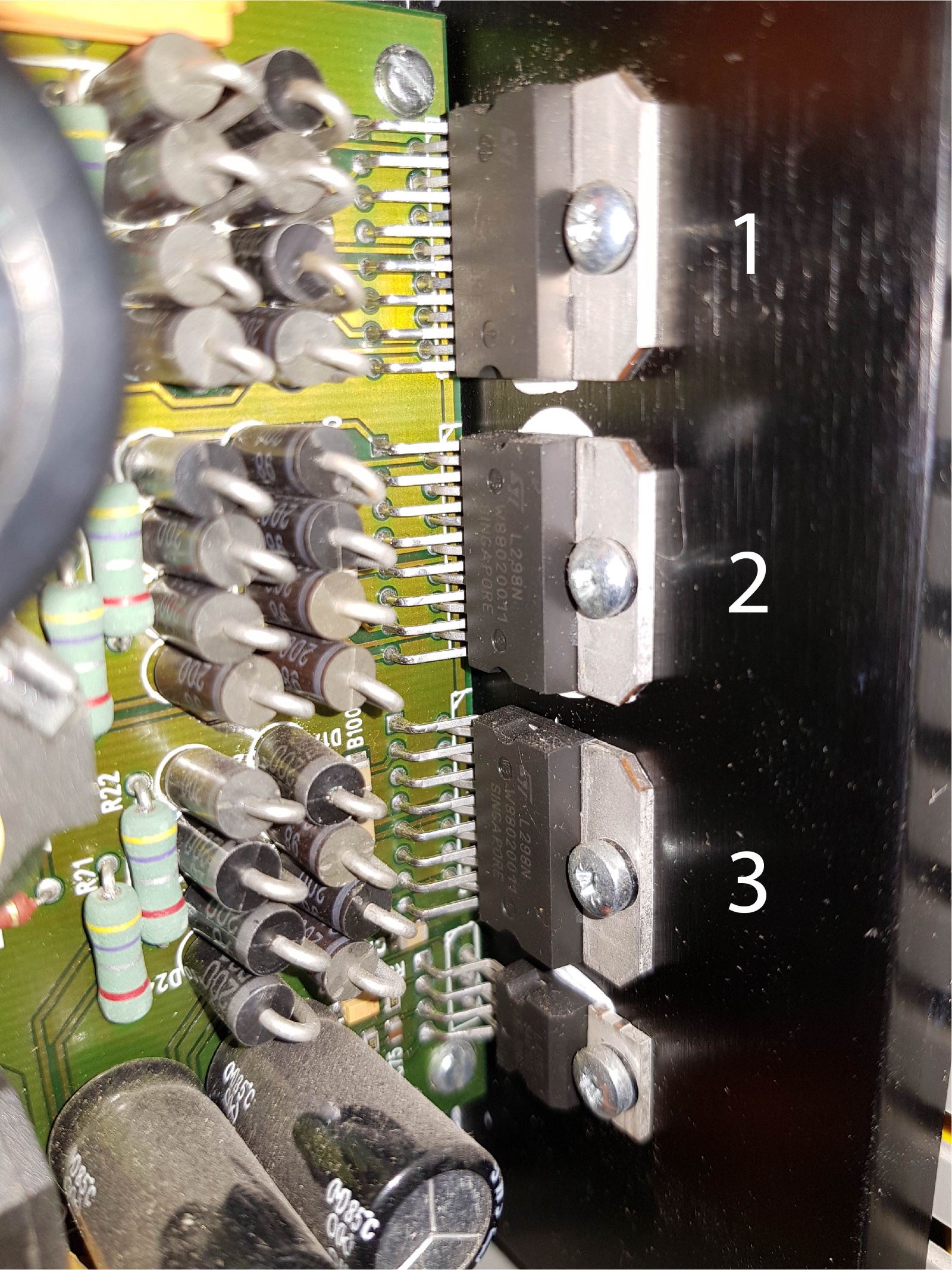

is it 1, 2 or 3. any help would be appreciated.

- ic.jpg (1.09 MiB) Viewed 11256 times

Bit difficult to say for sure without digging out the diagrams, looking at the tracks on the board it looks like those from No2 go to the Y connection.
A quick search and here are the drivers,
https://cpc.farnell.com/stmicroelectron ... m%2Fsearch
Where are you located? I was an electronics engineer for many years, wouldn't take to long to swap out, possibly have a look to prove it.

Hi, Im on the south east side of Barnsley, Not a million miles but still a drive, we could have a look if you want for a beer or two. If you have used a soldering iron and solder sucker or solder wick before you should be fine, you just don't want to be damaging the tracks when removing it.
There is no guarantee it is the fault though, when I have seen them fail I have seen damage to the surface of the driver, a crack or popped surface. If you can get hold of Martin or Steve from Denford they may be able to offer an alternative view point. It would be frustrating to replace the driver and find out it is the thing driving the driver. I will have a dig on line and see if i can see a diagram.
