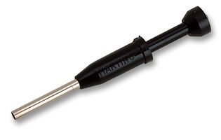

Harting connectors were used on lots of older Denford machines to connect the machine electrics to the big electronics black box
Try the following link for the extractor tool:
https://uk.farnell.com/harting/0999-000- ... /dp/151858
Manufacturer: HARTING
Farnell Order Code: 151858
Manufacturer Part No: 0999 000 0052
I believe most of them use a Han® 42 DD connector. See page 13 of this .pdf document from Harting:
han02-6_e_chap02_han_d_dd.pdf
(1.87 MiB) Downloaded 1120 times

This works a treat, but be prepared for a shock when you opent the packet, for the price its a very small tool but works very efficiently, I wouldn't be without it now.
