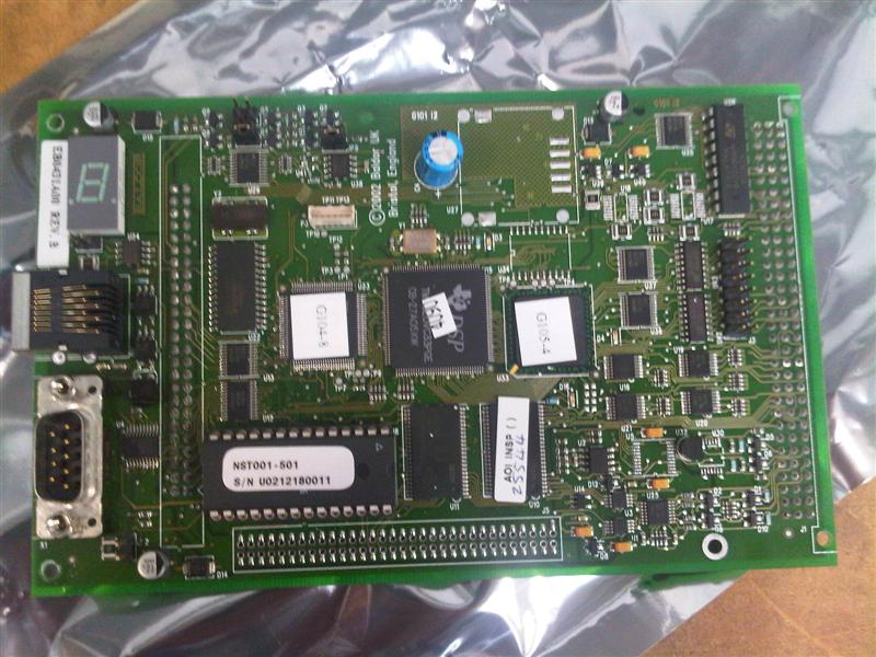

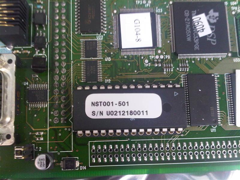

On the control card there is an Eprom that dictates which software will run.
Some EPROMS will run with DOS software others will allow you to use VR Milling or Turning.

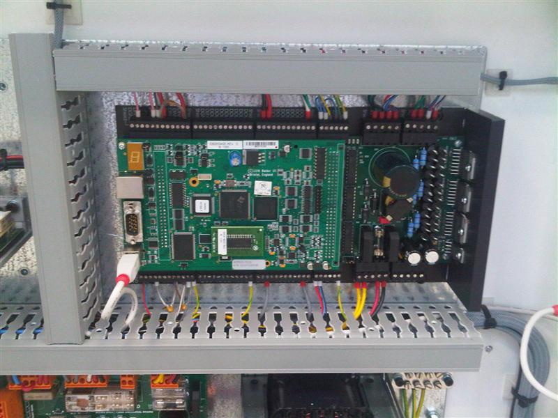

The EPROMS fitted are no longer available so Newer boards have a piggy back board fitted.
The attached photos show the Nextmove card and the EPROM, a close up of the EPROM and the new style unit.
CLOSE UP OF EPROM FOR VR SOFTWARE.jpg (87.12 KiB) Viewed 4081 times
CONTROL CARD AND EPROM.jpg (92.75 KiB) Viewed 4081 times
NEXTMOVE with NEW PIGGY BACK EPROM.jpg (75.36 KiB) Viewed 4081 times
