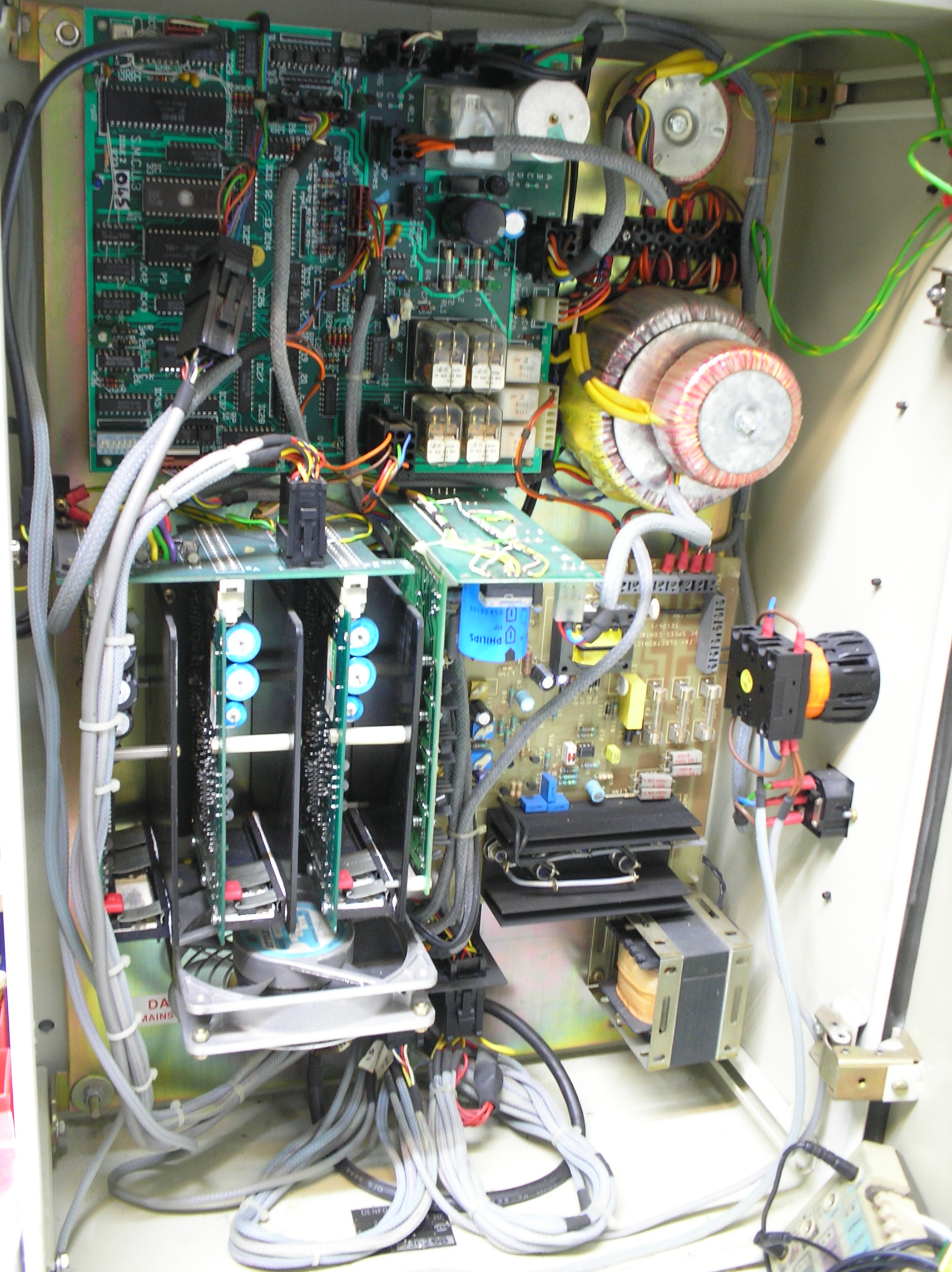

I have found the Serial number inside the white control cabinet on the bottom obscured by wires. It is 230288 Possibly preceded by a 4 so (4) 230288 probably 1993 vintage. Regards Phil.

Can you post some photos?

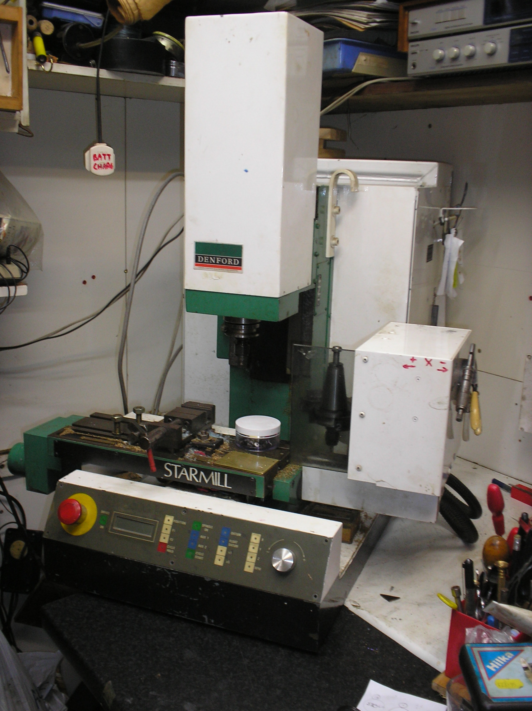

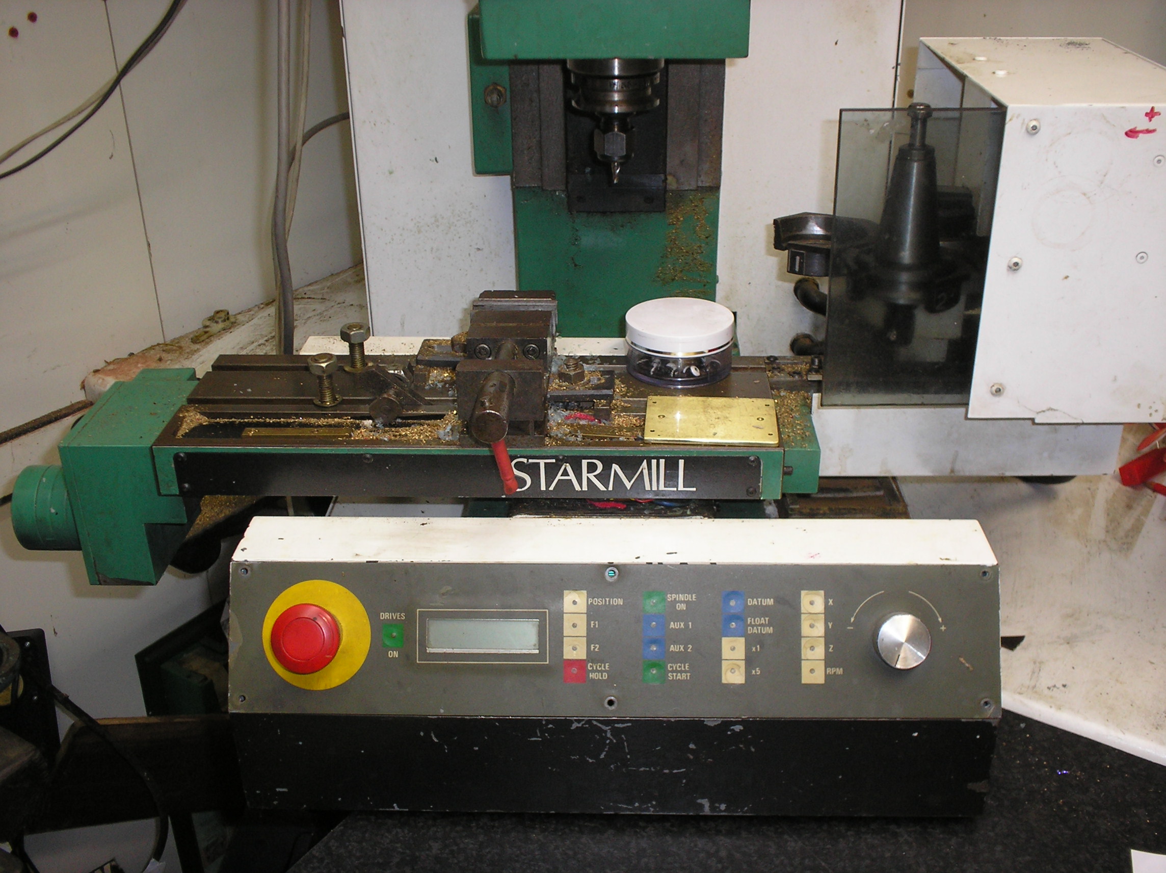

Right, here is the correct information. Disregard all previous woffle. ( Should have worked for ministry of disinformation, or the government) Year of manufacture- 1988 machine serial- 280361. control serial- 230288.
Control- 24v main motor Spindle- .3hp .22KW DC Ph. Thank you again. Phil.
