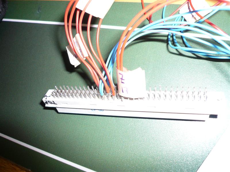

- A connector we made a long time ago for controlling the bottom board stepper motors. (I'm pretty sure we used an opto isolator switched direct from the parellel port)
- NextStep-96way-connector.JPG (78.55 KiB) Viewed 73685 times

well could that have been any easier, mega thanks guys.
I wired in a breakout board to the correct pins using some multiway sockets from a salvaged photocopier (which is a good source for steppers). After a few odd reactions, no y axis, y on the z axis and only one direction. I looked at the mach 3 video tutorial and it was obvious what the problem was, the port settings for the step and direction pins did not match the breakout board.
A couple of settings later and perfect control.
£13.80 and some wires, a cost effective solution.
Next step (pun intended), is to wire in the limit switches and look at the spindle control.

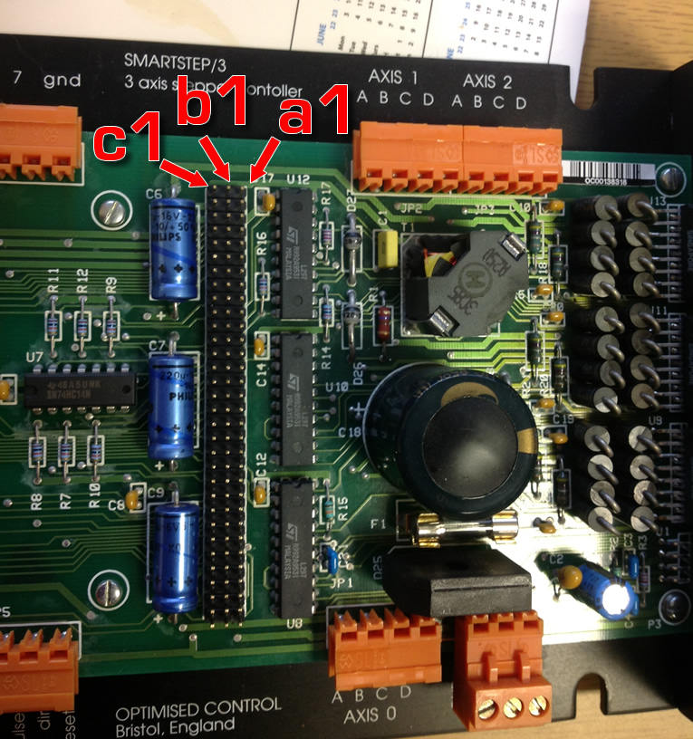

anyone have a picture of the orientation of the 96 pin junction on the board? which side is top, which are rows a/b/c.
having difficulty testing a micromill after removing the proprietary top board. the servos all hiss, so it seems the board is ok but not getting any feedback from them with the parallel cable hooked up and repinned.
all fuses are ok, the end mill was working when i went to look at it before buying it but after moving it to the shop the end mill now doesn't function either. about to buy a controller but i want to see if anything works on it at all before dumping more money into it. have the original software but was unaware of the dongle issue so now i'm stuck with it.
Re: Baldor Nextstep Step and Direction pins - 96way connecto
Best described by a photo:
- 96-way-header-pins.JPG (280.27 KiB) Viewed 71928 times

unfortunately that is how i had it wired so either the board is cooked or the machine driving it is having issues. i do know the board is powering up fine as with the fuse removed the servos stop making the hissing noise and the LED numeric indicator on the add-on board works fine.
guess i will start with some simple input and output tests on the board to see if it is actually pulling up properly.
it is an issue 2 board but i doubt that makes much difference.
