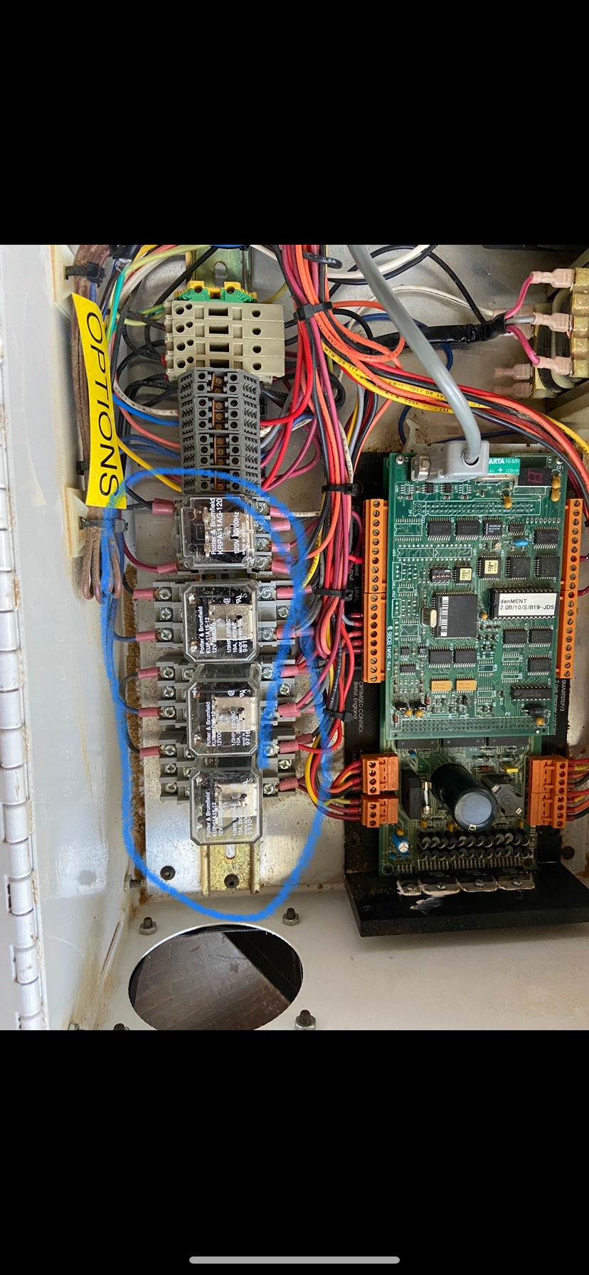

MikeR
Posts: 12
Joined: Wed 17 Nov , 2021 20:03 pm
Hardware/Software: Denford microrouter 2000? Windows 98
Re: Emergency Stop and Guard Switch contact functions
Post by MikeR » Sun 21 Nov , 2021 18:42 pm
I have the same problem with mine . Are any of these the relays for the E stop ?
