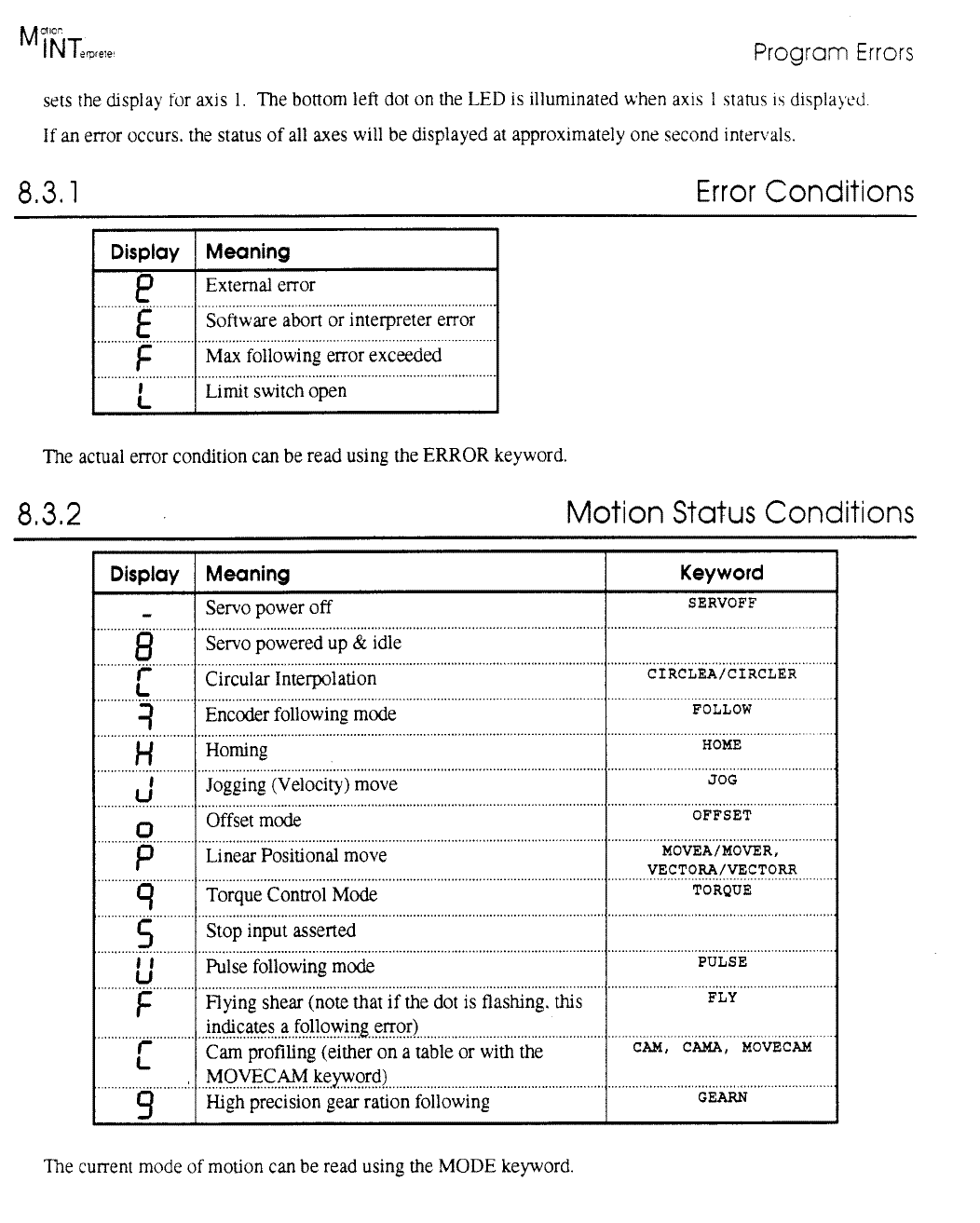

After installing the new EPROM a "7" comes up on the LED Display.
Any idea what this means?

This is the chart for the older Baldor smartstep control boards...
there is no sign of a 7 :?

It's an "L".
The card is installed vertically in the control box, had to get the right orientation.
Checking the home switches and wiring.
Thanks for the help.

In my notes "L" can mean "Denford Software Not Communicating" with the machine
