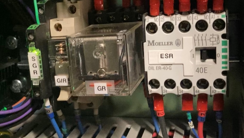

My novomill with Mach 3 has developed a fault with the interlocks. I simply heard a loud clicking when running the machine, then the machine stopped and doesn’t allow me to run it again, I opened up the cabinet and the three items GIR, and GR are clicking away and GSR switch is flicking from left to right. Like the switch is tripping. I have a video of this but can’t seem to load it up so anyone wanting to hear what’s happening I can sent it over on my mobile. Any ideas what’s happening and what to check/ replace . Image

It sounds like something may be shorting out the 24Volts DC.
It may be worth disconnecting one of the wires going to the guard lock solenoid.

If you remove wire number 90 from the GIR that will disconnect the guard solenoid.
It may also be worth checking the diode fitted inside the Guardmaster switch.

Ok so I took thenumber90 wire off and it didn’t fix it. I uploaded a video on YouTube of what’s happening inside the cabinet if it helps. https://youtu.be/mdeijccjO91

It does look like the 24volts DC is being shorted out by something.
With it being updated to Nach 3 I am not sure where to suggest to proceed.

I took the machine to a guy in melton mowbury that converts denfords . I can’t seem to get hold of him otherwise I would drive it up there. He seems a good guy and is still advertising on eBay but doesn’t answer his phone or emails? It worked really well for over a year then just tripped out one day , very frustrating. When I hit the emergency stop button a couple of the solenoids stop tripping so maybe it’s the emergency stop button shorting out. Can I purchase a new switch just to start eliminating things. I need to feel I’m doing something
Re: Interlock is tripping.
Post by Martin » Tue 24 Oct , 2023 10:54 am
It would be unusual for the E-Stop switch to short out.
Do you have a electrical meter you can use to test the 24Volts DC supply & see if it is being dragged down?
