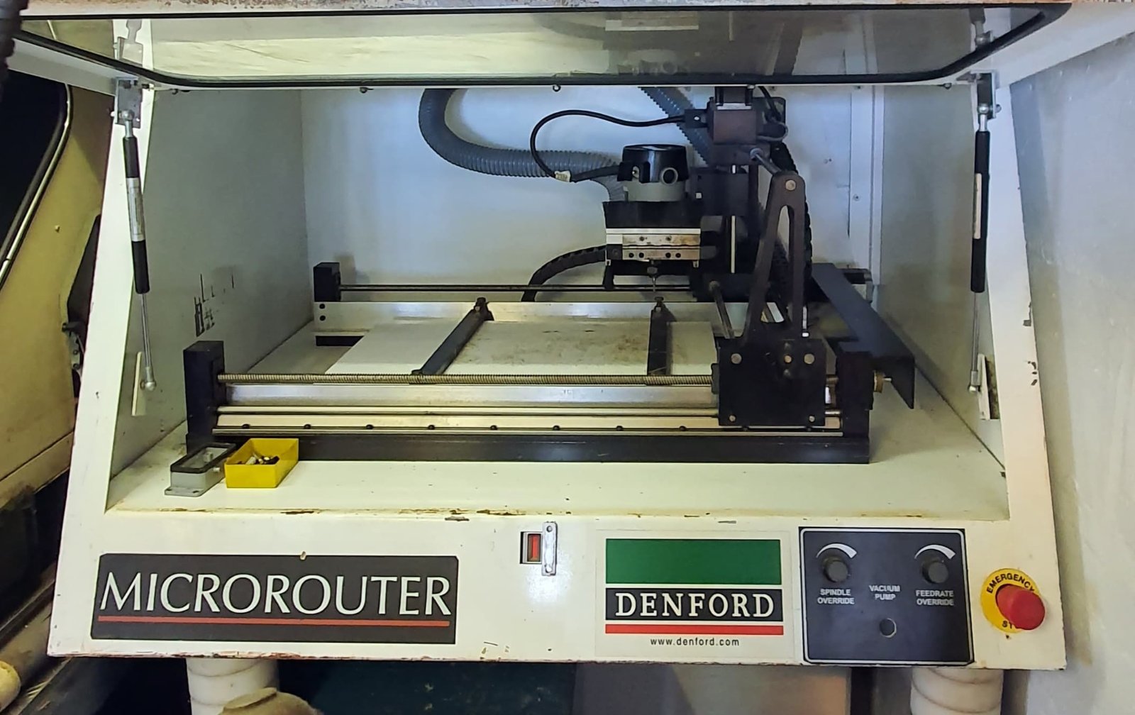

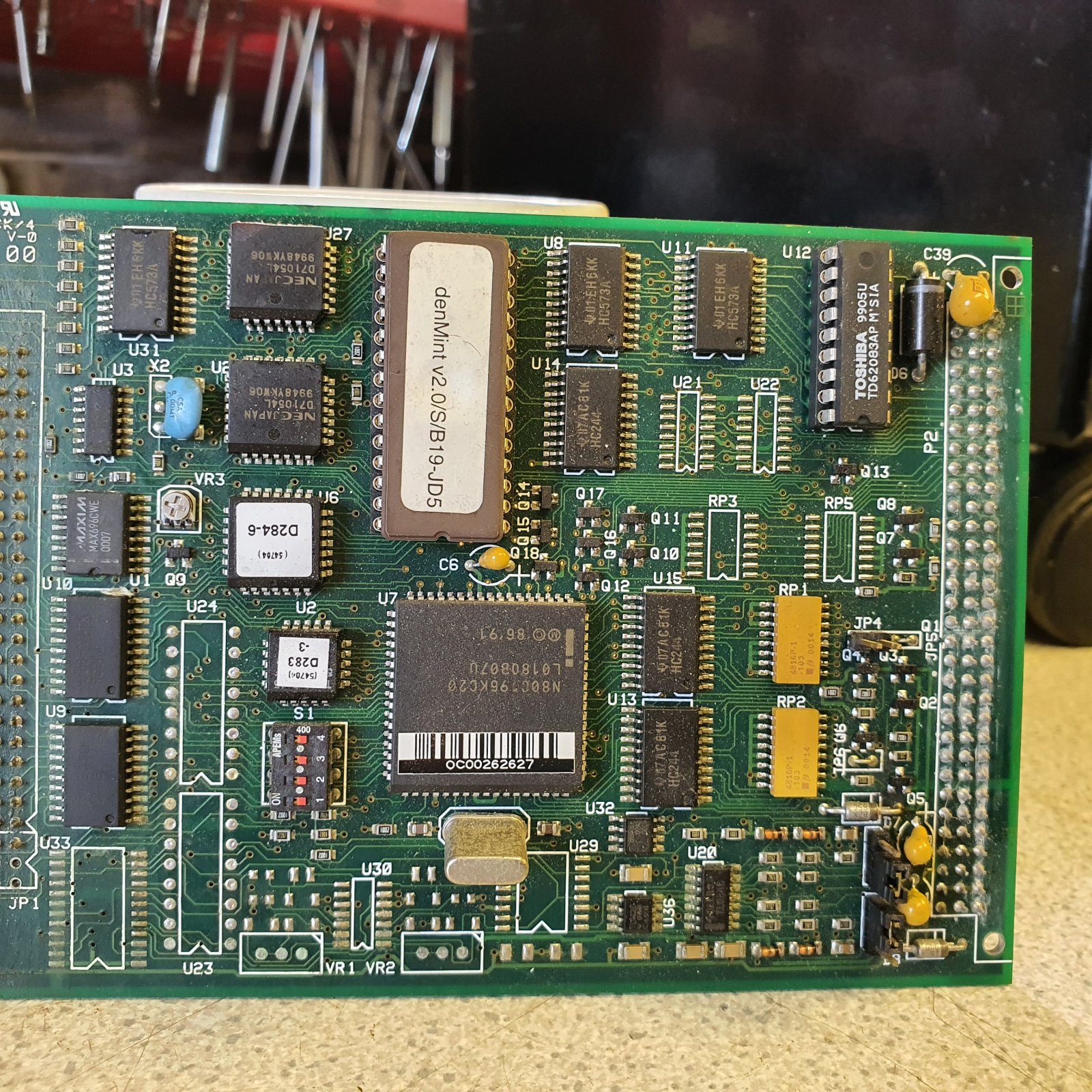

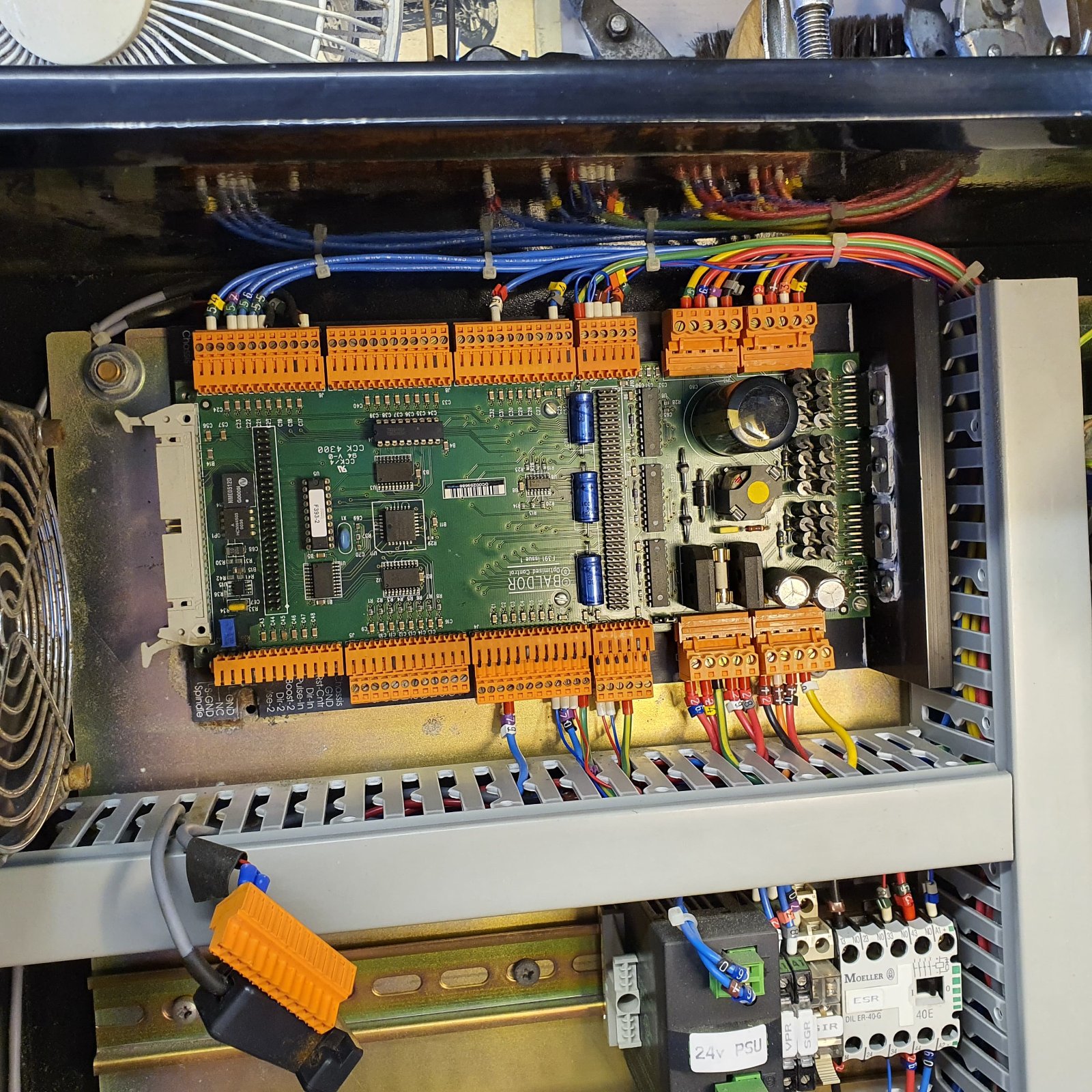

I bought my Micro Router quite a while ago with the intention of learning to run it but unfortunately taken ill. After a while I plugged it in and while it was standing there powered up, I heard a 'POP' from the cabinet and the spindle motor started on its own and a bit of smoke came from the cabinet.
Is there someone that could diagnose the problem and test the boards maybe local to Dover, Kent to get me up and running please.

I would be looking at all the components for evidence of the pop. Hopefully Steve or Martin will be able to say where to look in more detail. It could be on the speed controller rather than the upper board.
If you are OK with a meter I would pull the plugs from the lower board and check the output from the 24v PSU. The drawings are on the forum so you should be able to trace through the PSU side of things.
The speed controller for the spindle needs a feed from the upper control board so if you were to disconnect the cables that do that you should be able to see if the Sprint controller (I think this is the same one... its the one called starturn sprint speed https://www.denfordata.com/bb/viewtopic.php?f=46&t=4778) has failed hot.

Just an addition, you need to work out what has failed, I know the control boards are prohibitively expensive new, so second hand would be your only option if so, unless you could go down to component replacement. No idea what the cost of the speed controllers are. If it is main boards, it may be a case of converting to mach 3.

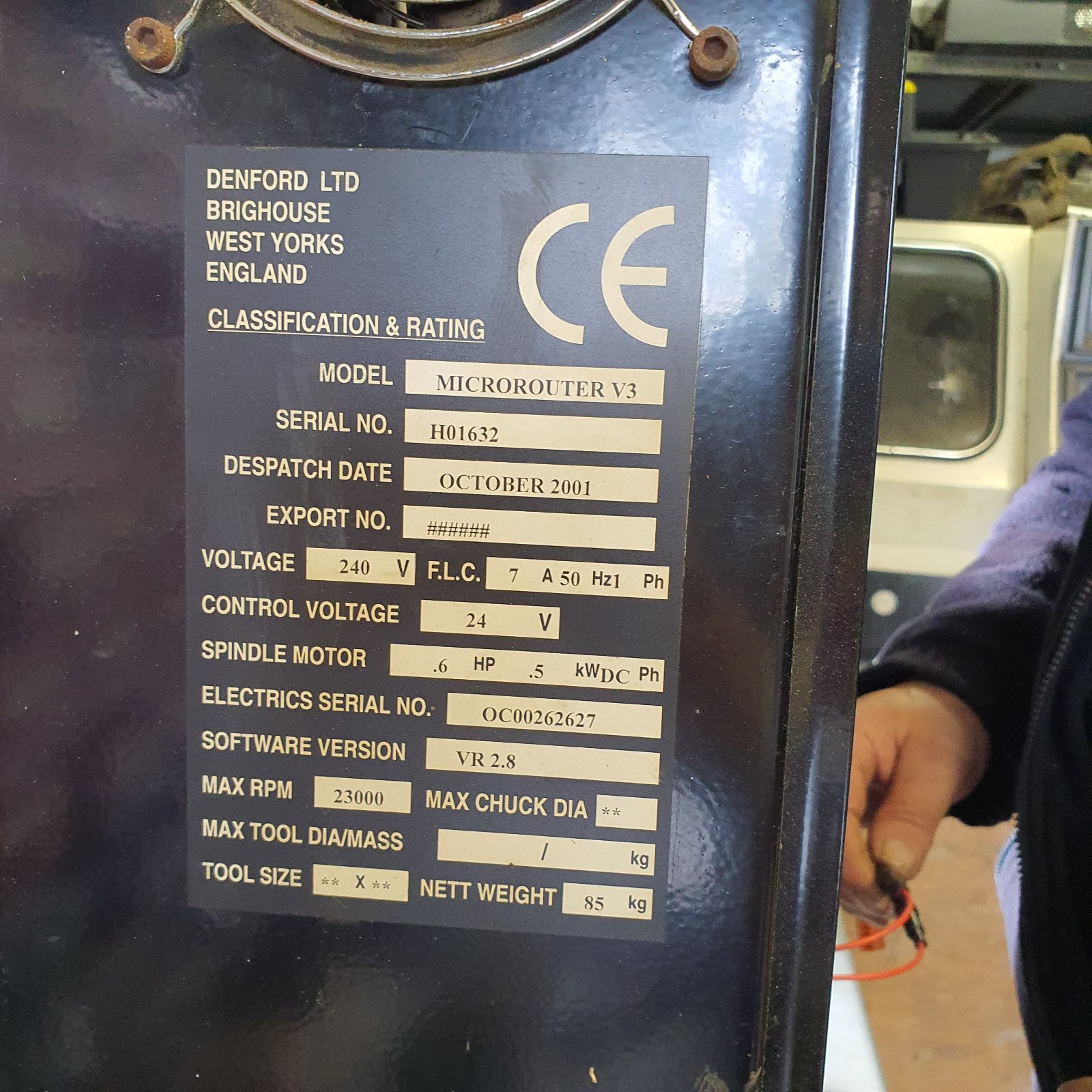

you will need to do a bit of checking as to which is which, machines got upgraded over time and this wasn't always recorded on the plate. Yours is visually older in that the electronics are in the separate box.
