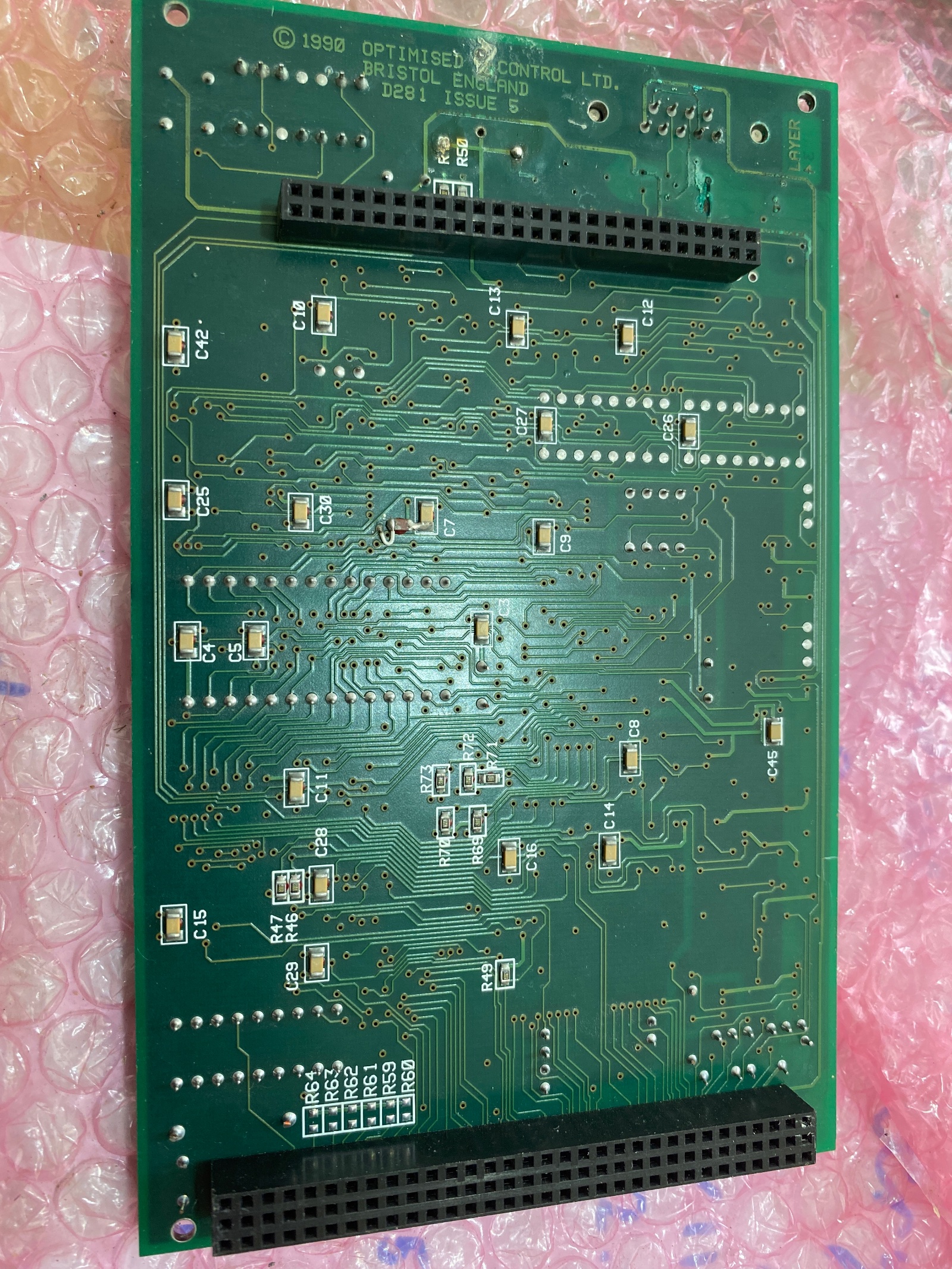

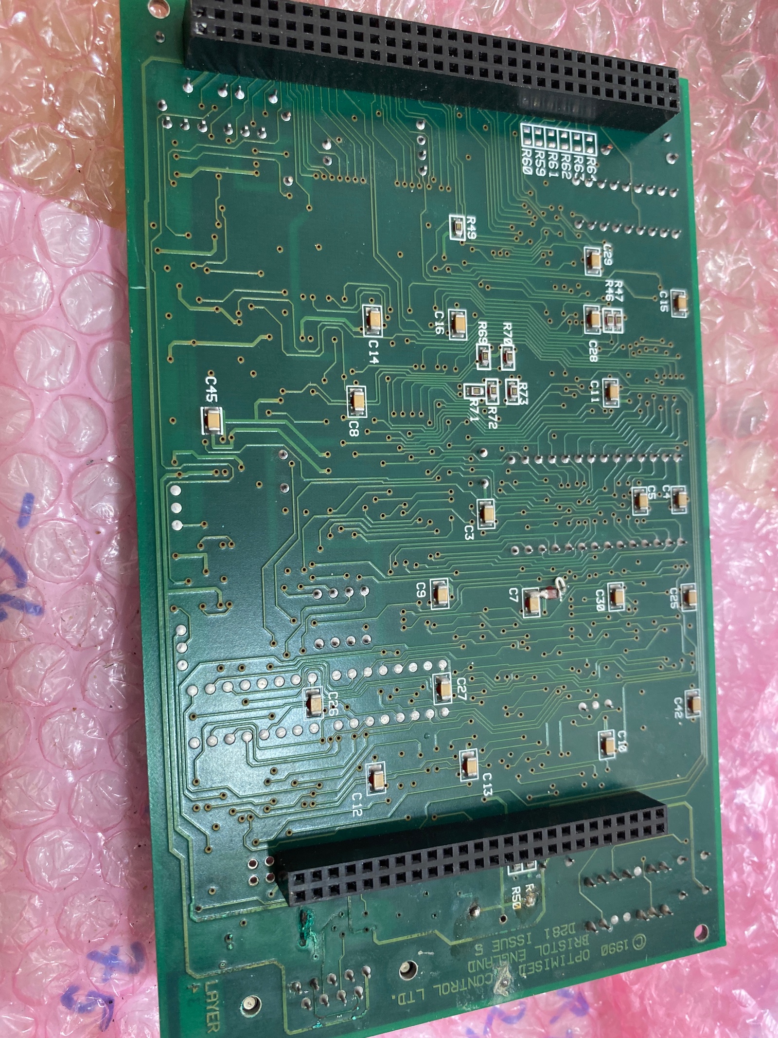

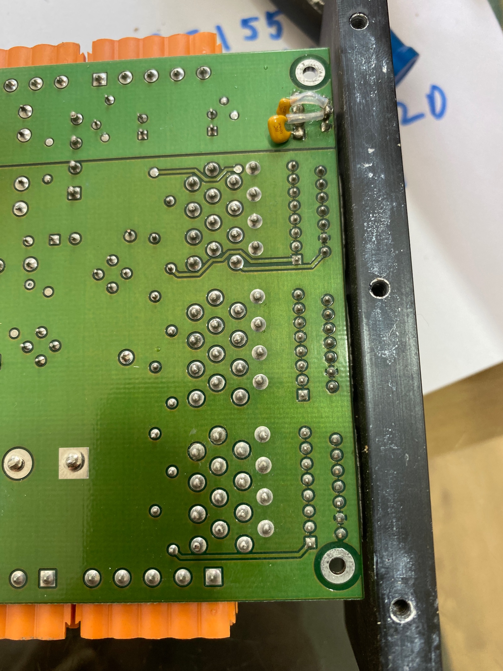

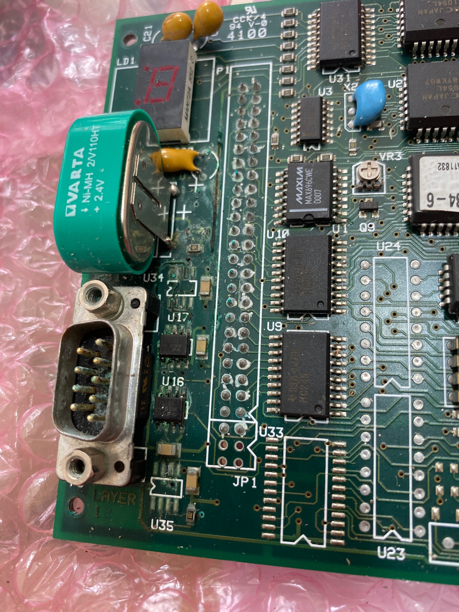

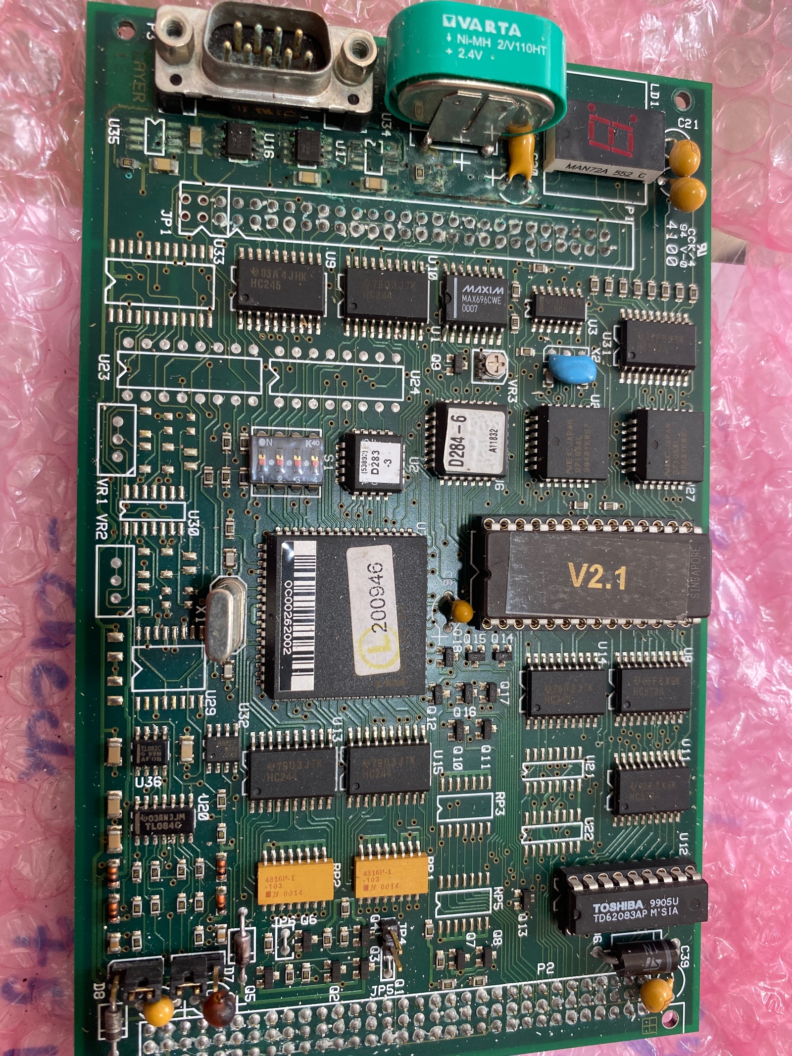

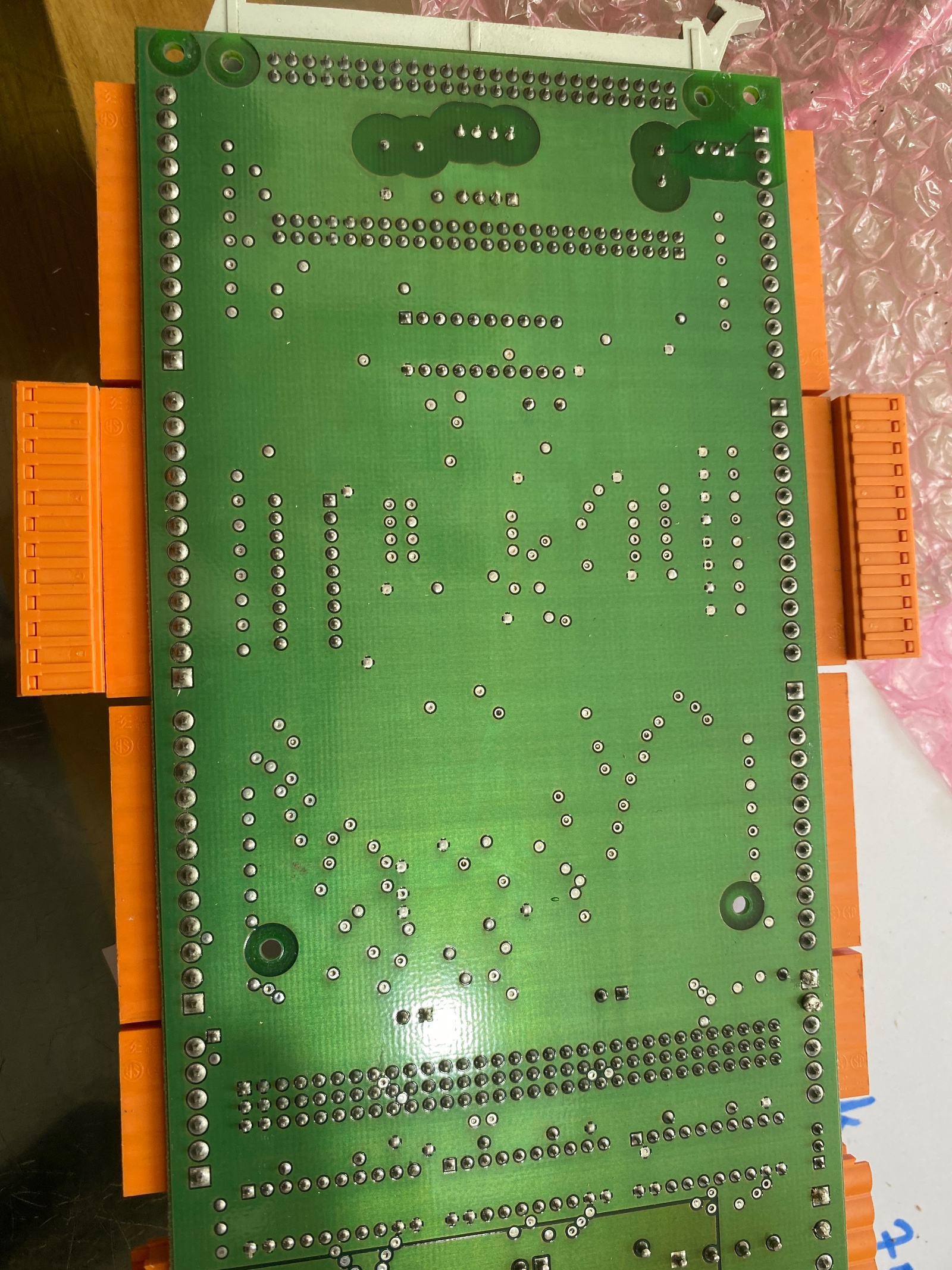

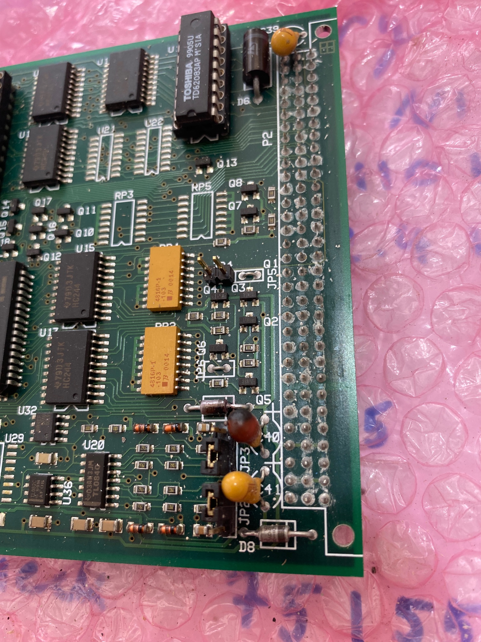

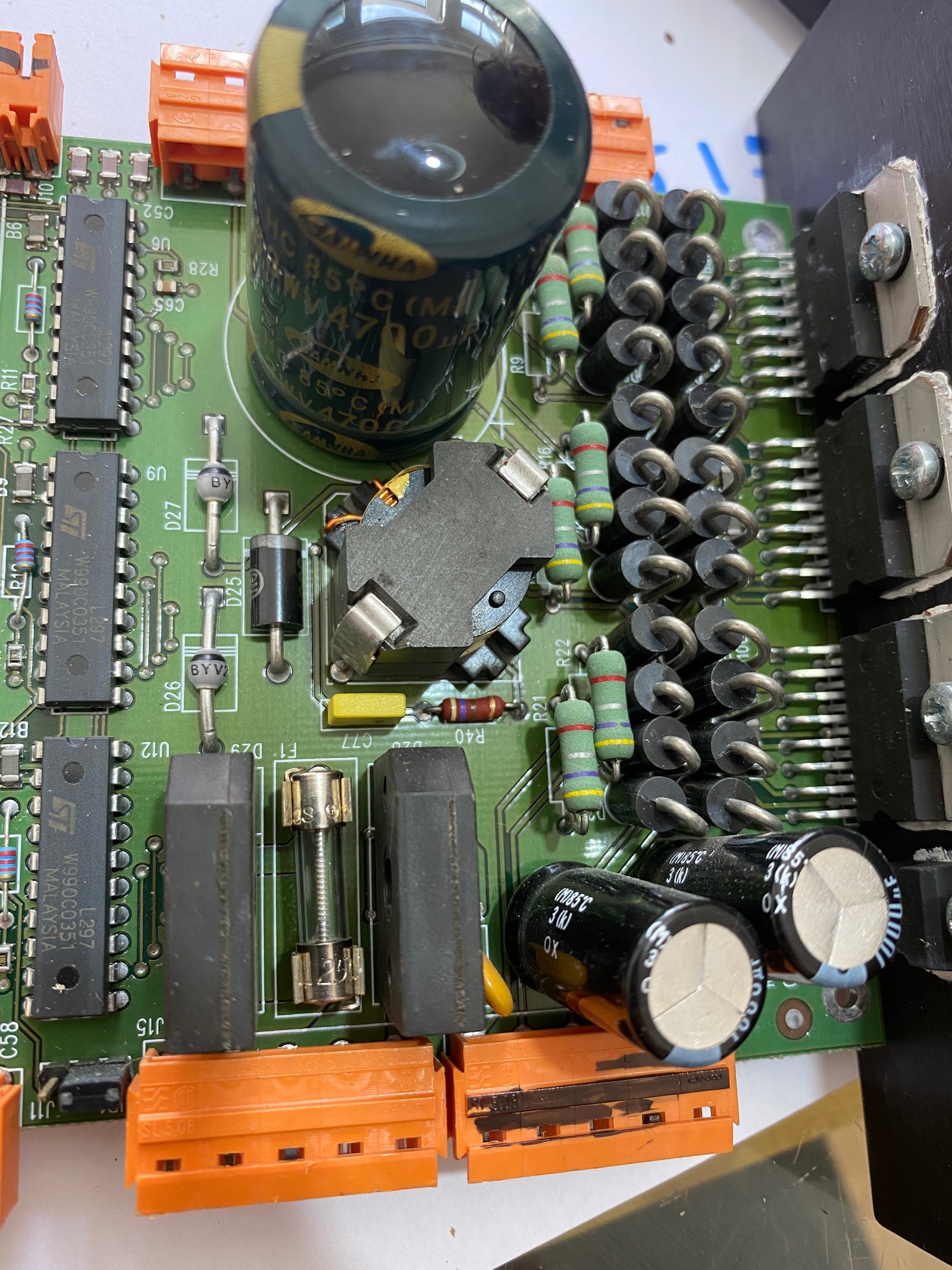

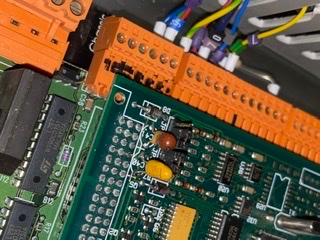

I have acquired a novamill, electronics box, and original pc with software and dongle - with the plan to learn the craft of cnc machining

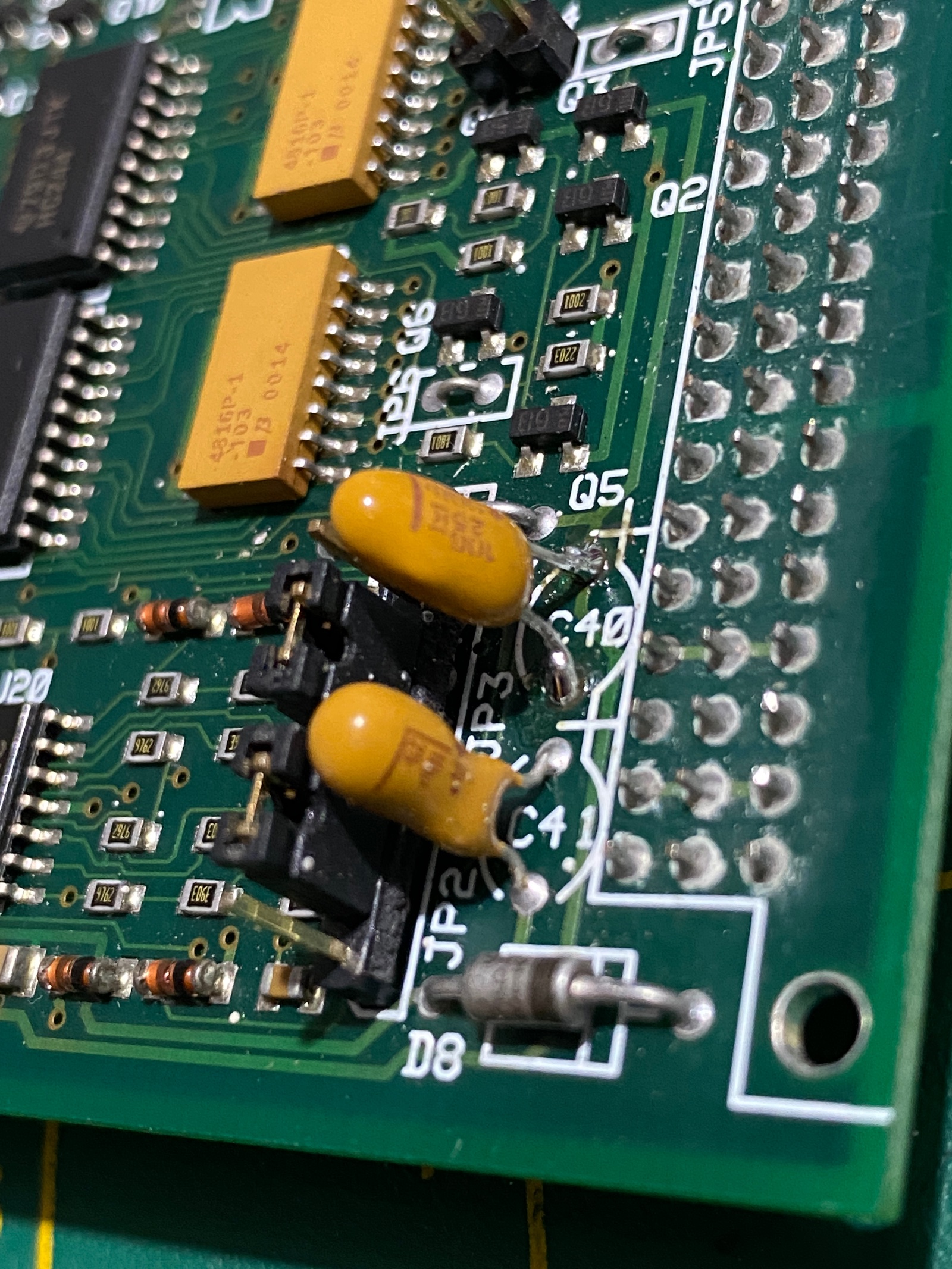

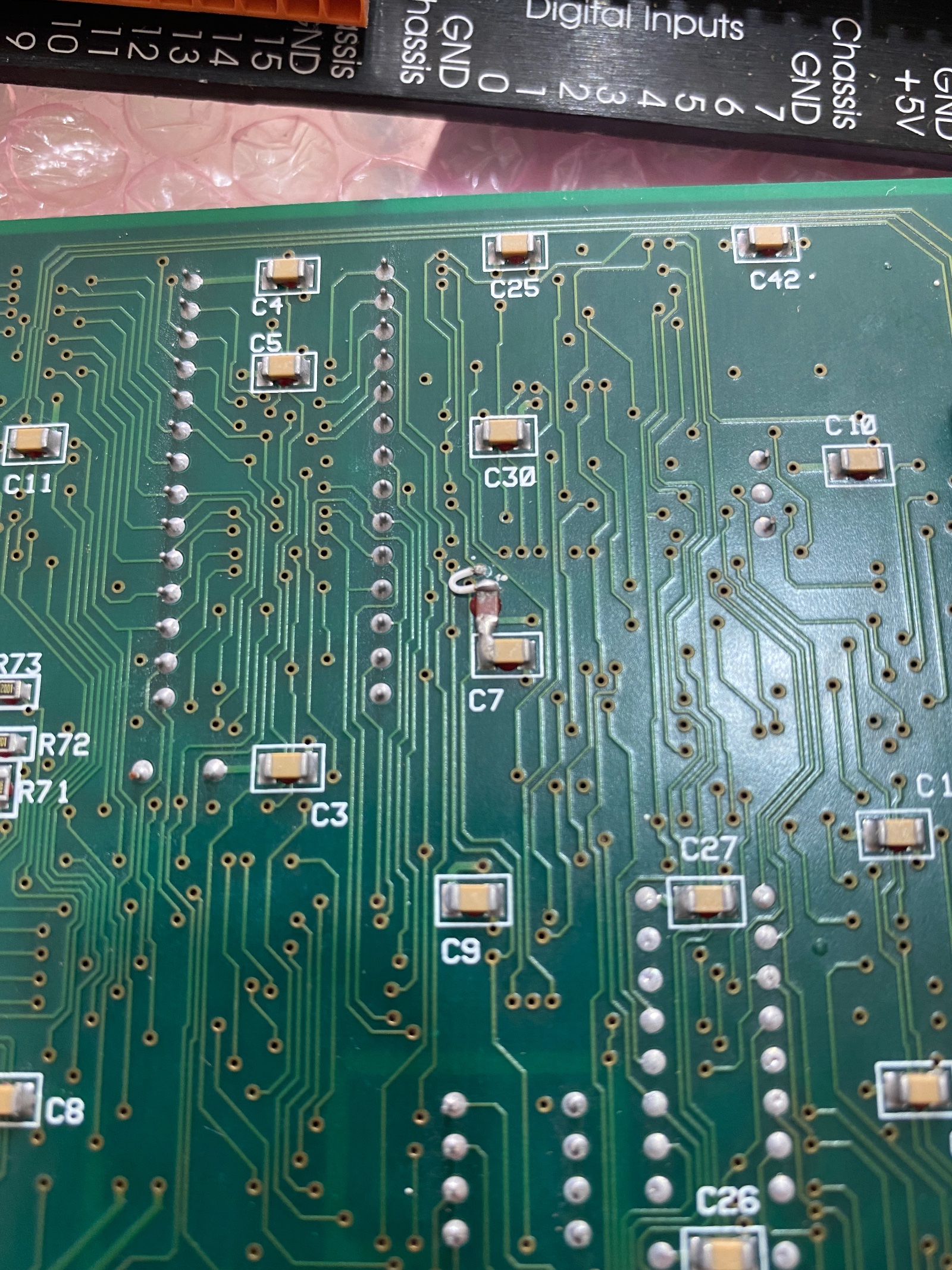

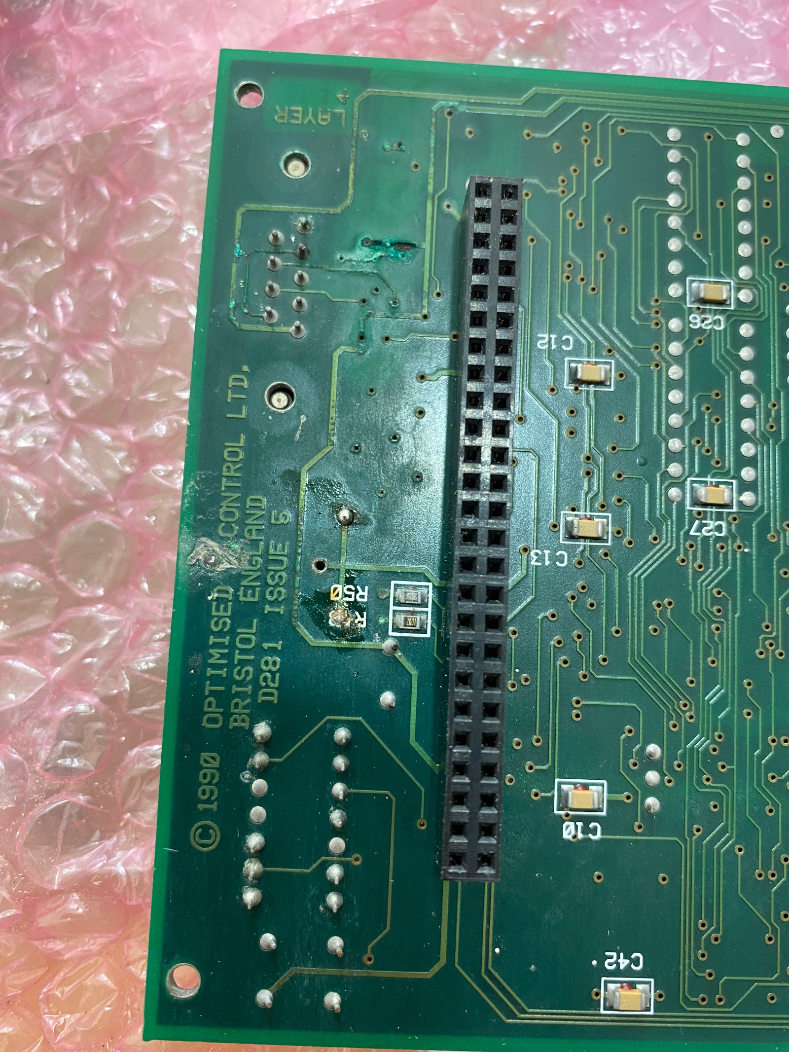

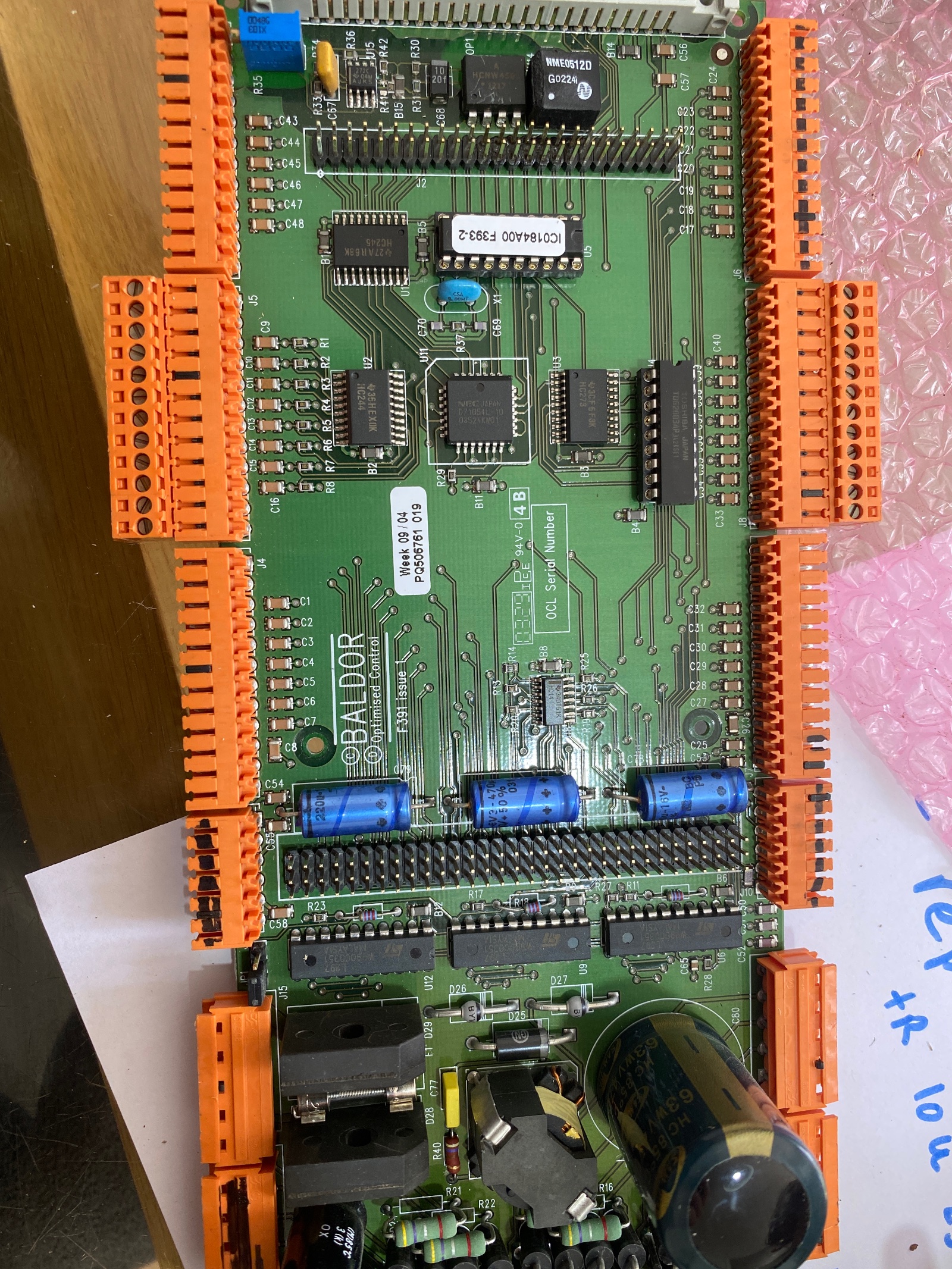

I’ve managed to get the pc working and so am now working on the control board. Apparently the board had been stored in a slightly damp space and I can see some corrosion on the board.
Wanted to ask the experts for help troubleshooting if possible. The corrosion isn’t that bad to be honest it’s certainly not the worst I’ve seen.
All fuses tested fine for continuity

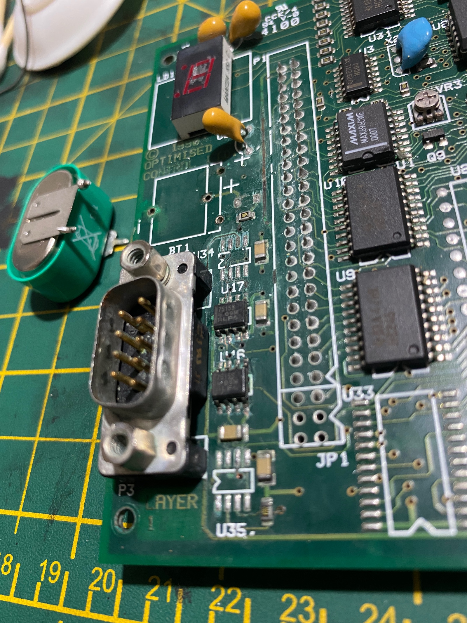

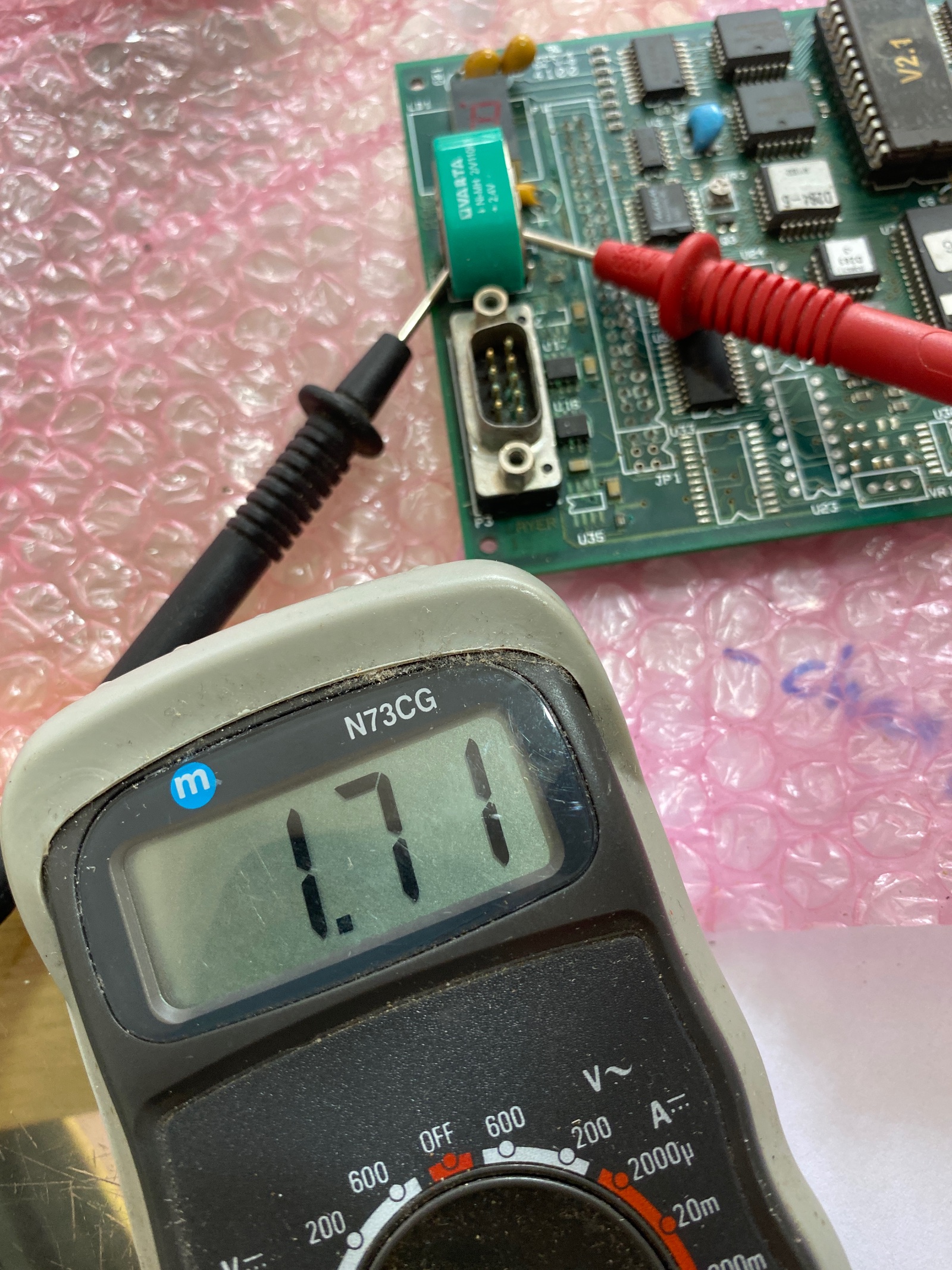

Currently the board 7 segment display doesn’t show anything - the battery on the board is a 2.4v and measures 1.7v - not even sure what this battery is for or if it charges up?

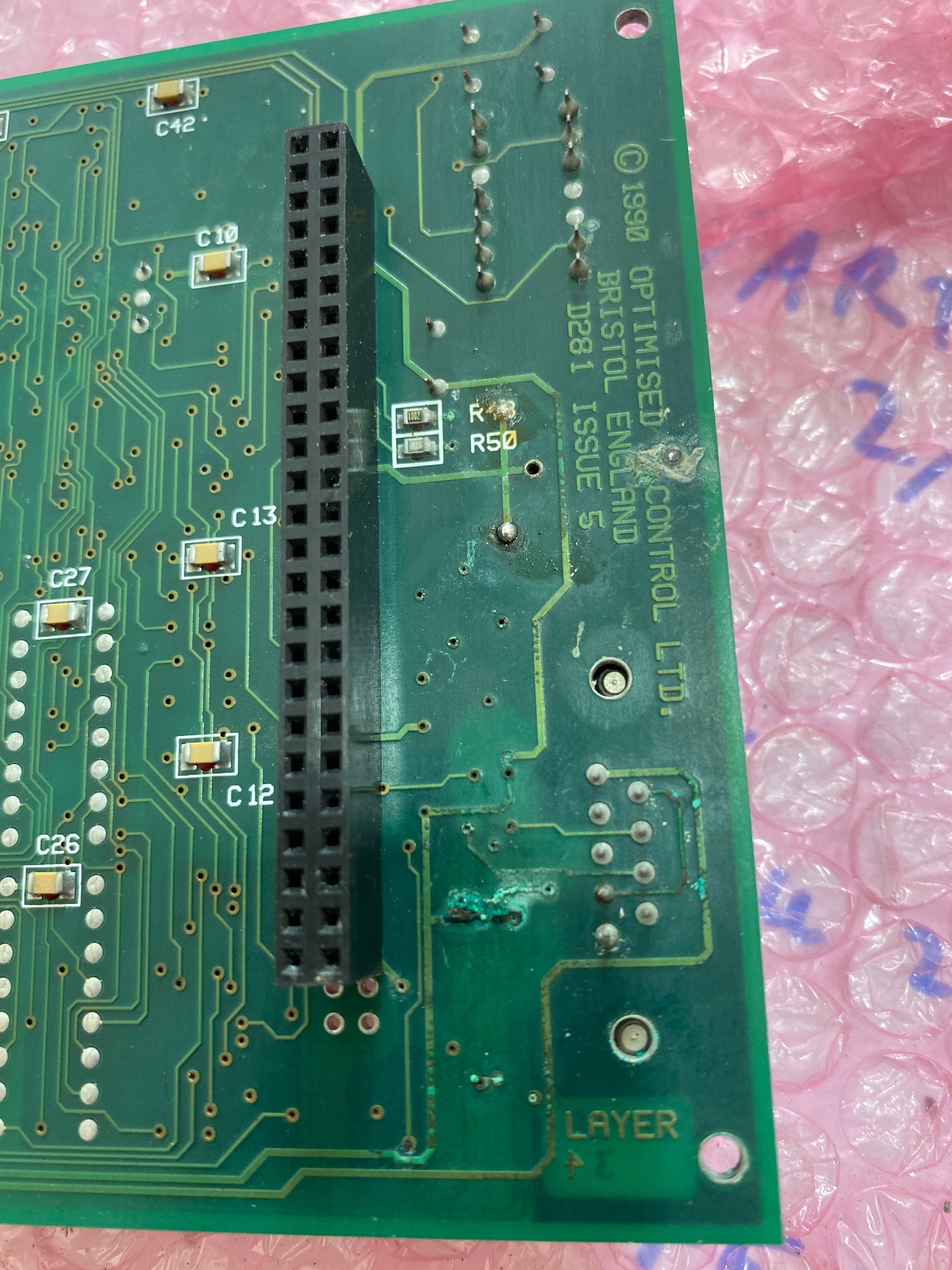

I can see some corrosion near the rs232 port, one ceramic cap looks blown which I will replace. The baldor board underneath looks ok except for the NME0512D looks swollen so I might replace that.
I’ll attach some photos. Please could someone in the know help with sharing some knowledge on the best course of action?
I want to try getting the board working and I want to try avoiding swapping out hardware for any mach3 upgrade. Reason being I have the original pc, and am ok at soldering. I also wanted to learn how to cnc .... not necessarily the process of upgrading a cnc - so if I can keep things original then that would be great - it looks to be a great board with good components
Many thanks

- FA41575F-1140-475F-BBB3-AF72D0F1AA53.jpeg (1.25 MiB) Viewed 11618 times

the battery is not needed, so you can remove it. looks like you're on the right path, a good clean up and lets hope it works

Out of interest - what is the battery for? Was it to preserve some sort of memory?
I’ll remove it anyway before I start cleaning - but do you think it doesn’t need to be attached at all? Even when I install the card back?
- Posts: 613
Re: Novamill electronics
Not sure to be honest, I presumed it was to store settings but the word from Denford is it is not required for the way they use the board.
The boards are very capable units when you look into them and could do a lot more, I would say they are well over spec'd.

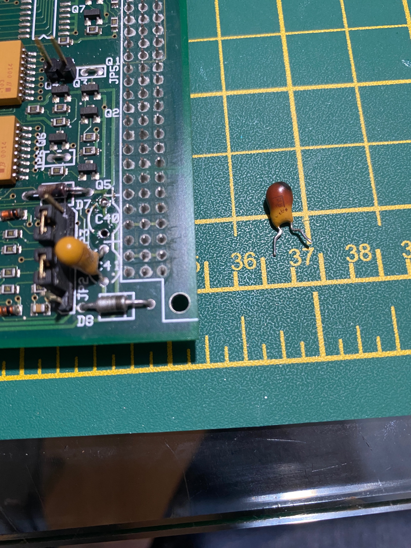

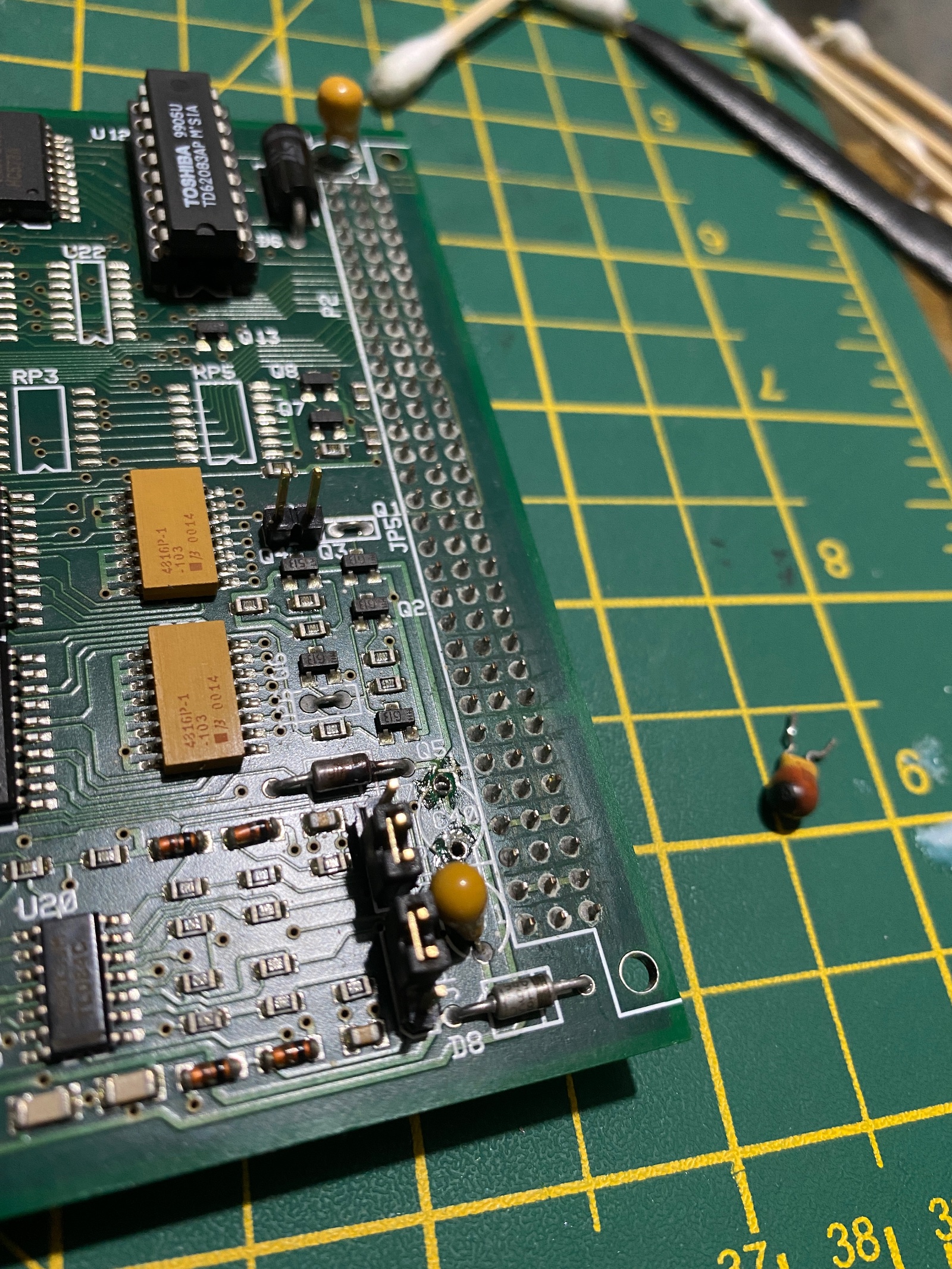

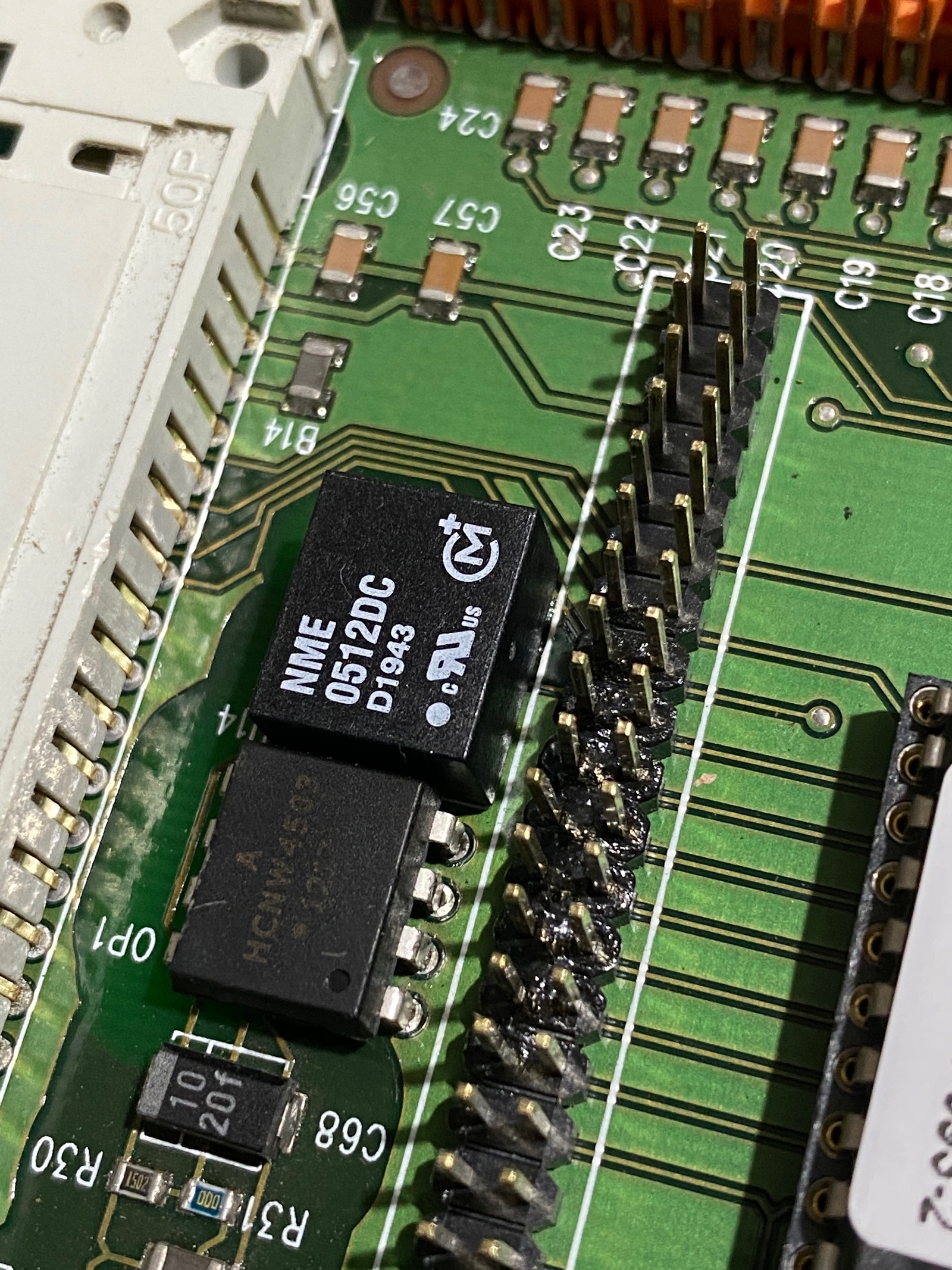

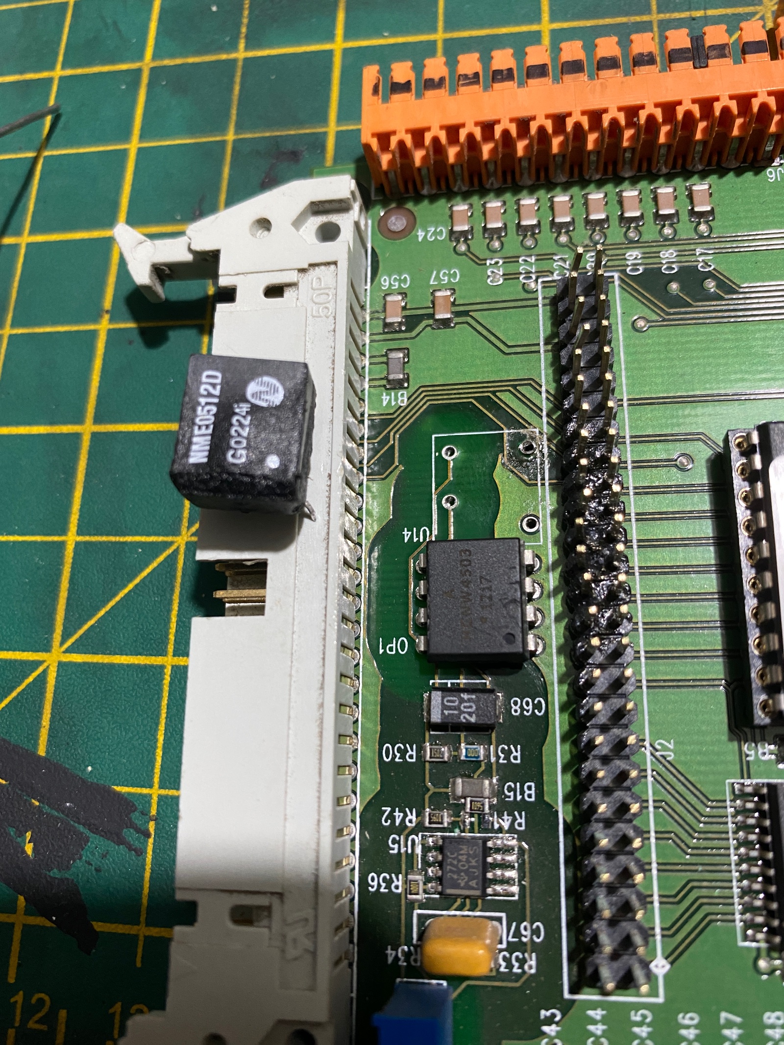

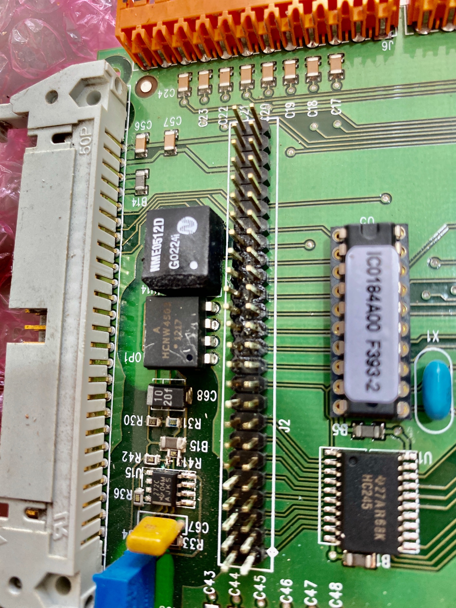

Last night I gave the board a good clean up and scraped away most of the corrosion on the pins - the worst affected area was around the rs232 port - which I guess makes sense as the enclosure fan is right near it so any dampness going through the system would naturally get stuck around this area
Have also removed a tantalum capacitor which was blown, the board battery, and the nme0512d. I have replacements coming tomorrow
Any additional pointers to check while I’m at this stage would greatly help
Many thanks
Photos below
Many thanks
Photos below

So I’ve managed to fit the tantalum capacitor and the nme0512dc
Buzzed through the connections and they seem fine
Wanted to ask if there was a way to power the board without using the power supply from the enclosure as the enclosure is currently in a friends garage and I took the board out to take home clean and repair... wanted to check it before I go all the way to my friends

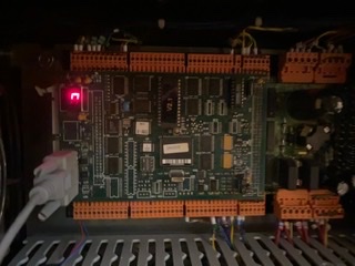

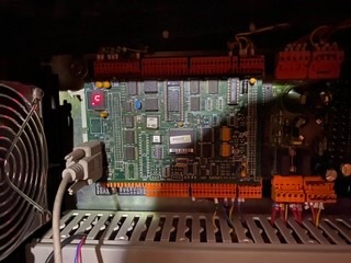

So I ended up putting it back in the enclosure
I plugged up just the power in and 5v
On the 7-segment display I only get the top left segment illuminated solid and the bottom left dot flashes for a time and then goes out
Please could someone help me to understand what this means as I can’t see the error in the manual
Many thanks
Many thanks

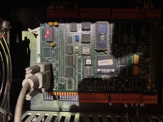

Managed to get on the 7 segment display now shows
Top left
Top middle
Top right
... all lit
No flashing dot
And again I don’t know what that means
Also - I added a couple photos to show the display but also the second tantalum capacitor next to the newer one is now starting to burn - you can see the new capacitor next to an older one which has now gone brown in the photo and was smoking
Many thanks
Top left
Top middle
Top right
... all lit
No flashing dot
Many thanks
The Denstep LED codes can be found here.
If you remove the Eprom does it still show the same message?
https://www.denfordata.com/bb/viewtopic.php?f=54&t=3167
Yes the Eprom is the 2.1
You can power both boards up by supplying 24 volts DC on to the Logic connection. It should also power using a 24 to 28 volt AC supply.

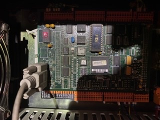

Ok so I’ve managed to get the board back in and tested turning on the enclosure after plugging in each of the plugs - 1 at a time
No smoke! - which is encouraging
I attach 3 photos below
So there are 2 photos with the eprom installed showing a flashing dot in the lower left and the top left segment permanently lit
Then there is one photo with the eprom removed - this shows the lower left dot is permanently on as is top left top middle and middle segments... I guess it is the c display message (Indicating maybe cam profiling or cam table) though there was a moment when The top right segment was also illuminated indicating an o for offset mode
I really don’t know what that means - maybe I need a new eprom?
Many thanks
Many thanks
