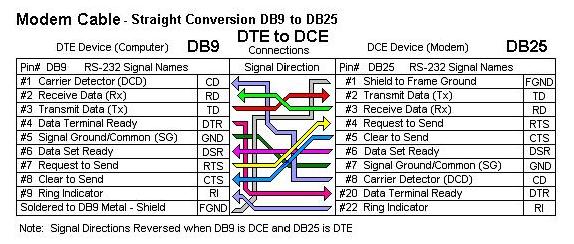

For clarification
All Denford's machines (With the exception of Micromill's and Microturn's manufactured for the USA) have a BI01812GG external serial cable connection between them and their PC's.
Micromill's and Microturn's have signal to signal adapter cables i.e. TD - TD, RD to RD, RTS to RTS etc, as the RS232 wiring crossovers are carried out internally on the machines themselves.
A typical external Micromill and Microturn cable would be
- Modem Cable Micromill - Microturn - extrenal - 9 -25.JPG (49.66 KiB) Viewed 39081 times
