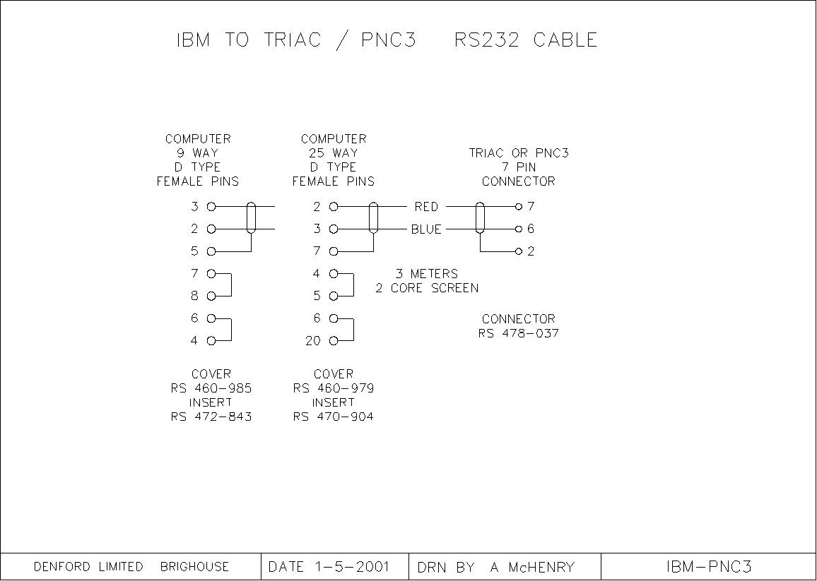

As i am not fully up to speed with wiring diagrams, could some one tell me on the 'IBM to TRIAC' drawing below.
What the 'loop' symbol from pin 2 on the 7 pin connector stands for.
Roy 8)
Post by bradders » Tue 06 Feb , 2007 8:23 am
Roy,
Its the interwoven metal screen wire that surrounds the other plastic coated cables. Therefore you want "Screened cable" to make up the final cable

Post by Roy » Tue 06 Feb , 2007 20:23 pm
Thanks, I was thinking that possibly could be the case. But best to check with you experts!

Hi I have got some cable which has a foil shield, will this do the job?
