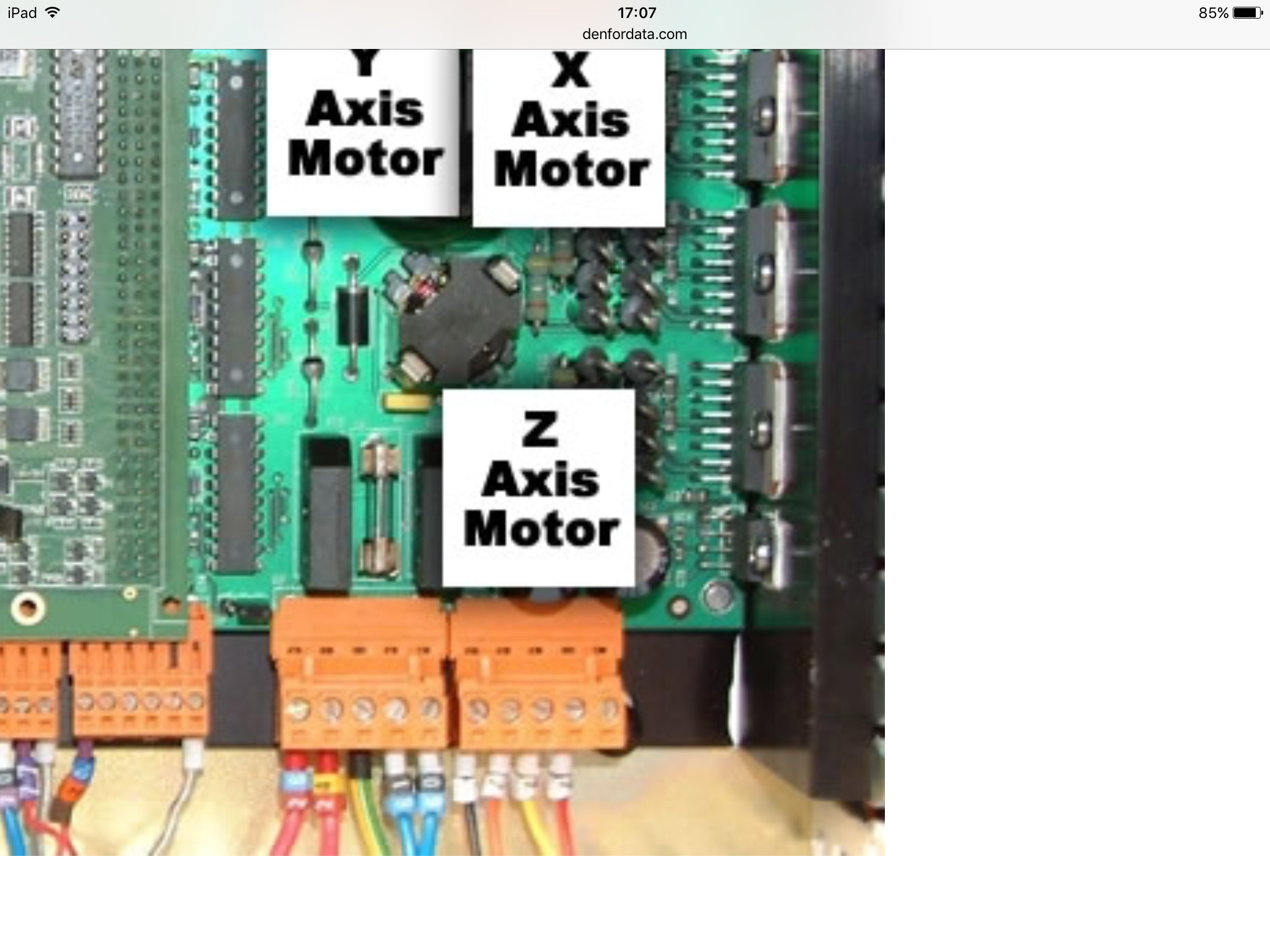

Re: Baldor F391 Series 1 - Odd Failure
Post by Steve » Sat 12 Nov , 2016 10:09 am
The regulator is shown in the bottom right hand corner of the photo below.
HunterScotty
Posts: 10
Joined: Sat 02 Dec , 2006 21:12 pm
Location: Scotland
Post by HunterScotty » Sat 12 Nov , 2016 10:13 am
That is the one - do you know the make and model of the chip and where I can maybe order one?
