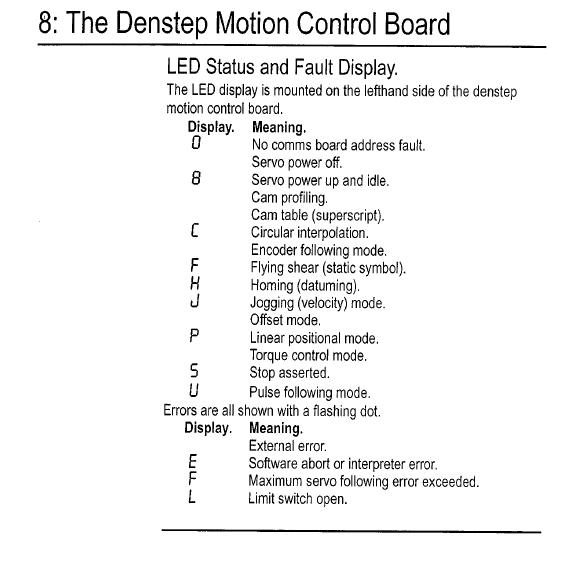

Post by bradders » Mon 24 Jan , 2011 9:32 am
Denstep 7 Segment LED status and fault display
Denstep 7 Segment LED status and fault display.JPG (43.75 KiB) Viewed 7994 times
Re: Denstep 7 Segment LED status and fault display
Post by bradders » Mon 24 Jan , 2011 9:48 am
Denstep 7 Segment LED status and fault display in PDF format
Denstep 7 Segment LED status and fault display.pdf
(55.66 KiB) Downloaded 1365 times
Post by Denford Admin » Mon 13 May , 2013 9:05 am
Nb, an L on the display also means that the Mint file needs 'L'oading
Our machines would not normally show L for limit switch open because we've never used that feature.
