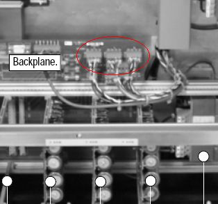

Post by ilbiondo » Wed 28 Mar , 2012 8:00 am
When i try homing the X axis baldor card writes "H"
When i try homing the Y axis baldor card writes "8"
When i try homing the Z axis baldor card writes "8"
I checked DC on terminals shown on the picture: is not present.
I checked all fuses in the axis card and in backplane: are ok.

Post by ilbiondo » Tue 10 Apr , 2012 16:43 pm
YESSSSSS!!!! I did it! :fireworks: :lolol:
The machine works!
The fault has been an abnormal contact of a fuse on the backplane!
Thank you all for your advice and thanks to Denford for the support.
