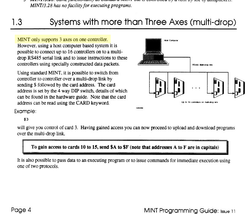

Re: Connecting a 4th axis drive to a denstep Red 7 seg board
I've just had a look at the Denstep mint manual and it would seem that it was only capable of 3 axes anyway...
email technical
denford
co
uk to see if they can supply an older Nextstep (RS232 only) top card (as these are often replaced in USB upgrades)
email technical
- mint-denstep-extract.jpg (104.07 KiB) Viewed 13738 times
