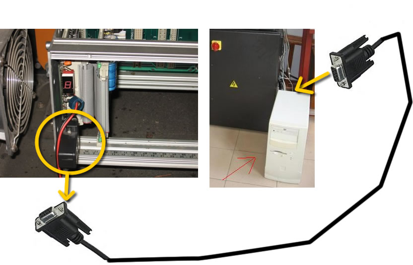

6. Double check the connections from the PC to the Baldor control - all kinds of adaptors and connectors can be used to get the signal from the PC to the control - checking these pins are all connected will prove a cabling fault:
Just to clarify where the above cable should plug from and to...
