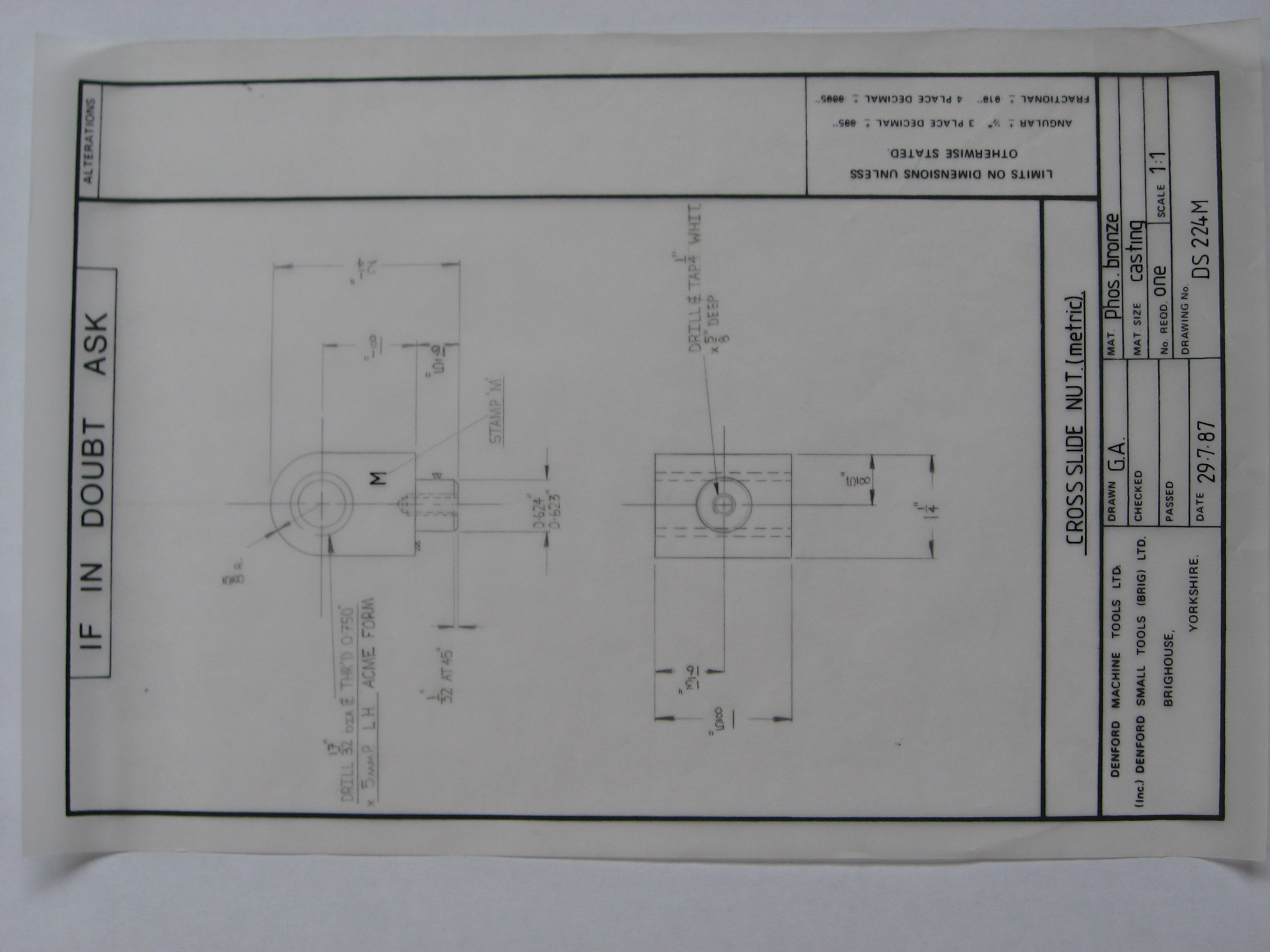

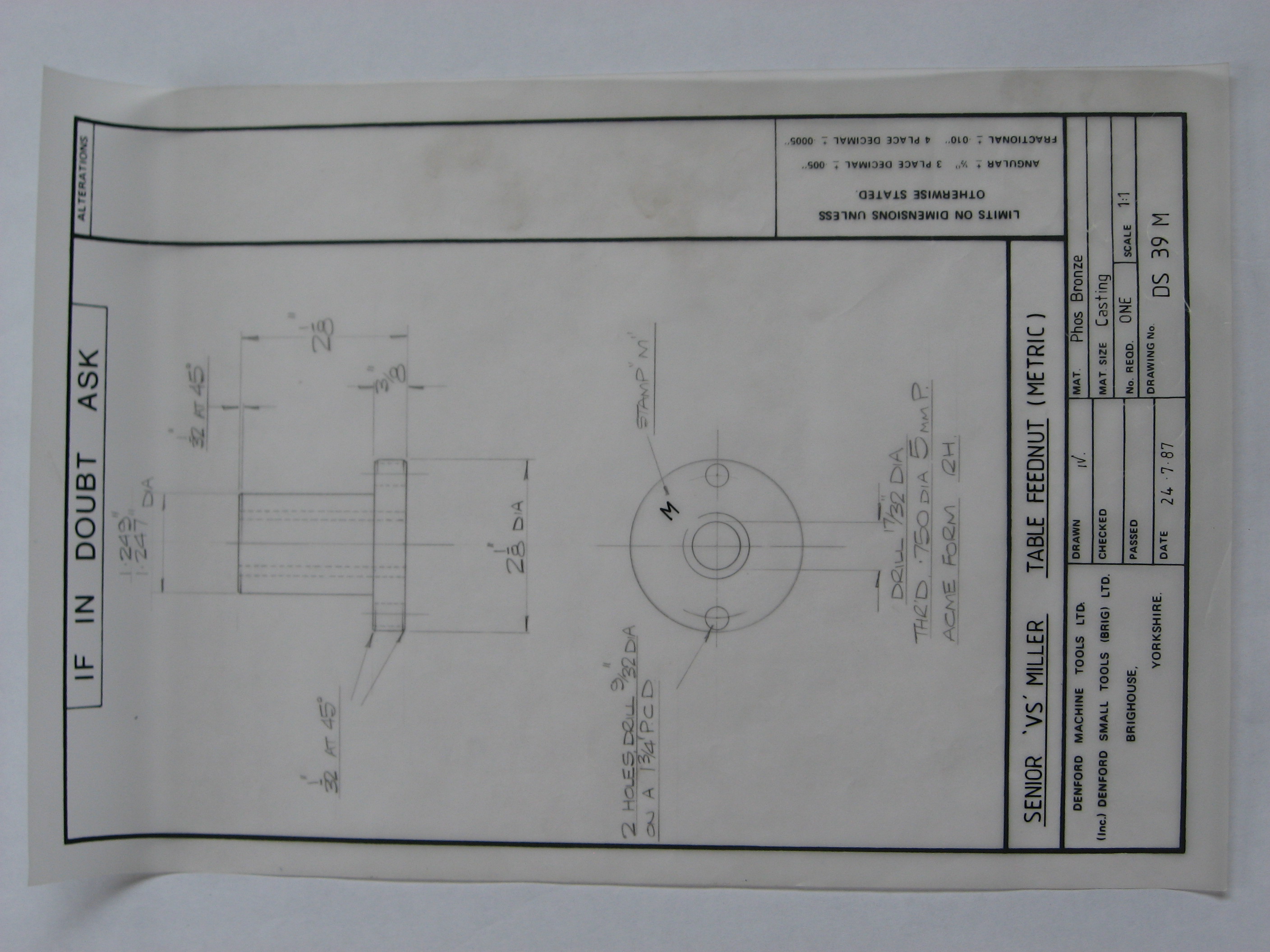

Drawings for nuts to fit the M1, Major & VS models - request was made for information on the Yahoo Tom Senior group.
Apologies for quality / file size - there was a lot of stuff to get through the day I found these!
Cross slide nut
DS 224 M Cross slide nut.jpg (1013.23 KiB) Viewed 16577 times
Feed nut
DS 39 M Feed nut.jpg (1.02 MiB) Viewed 16577 times
