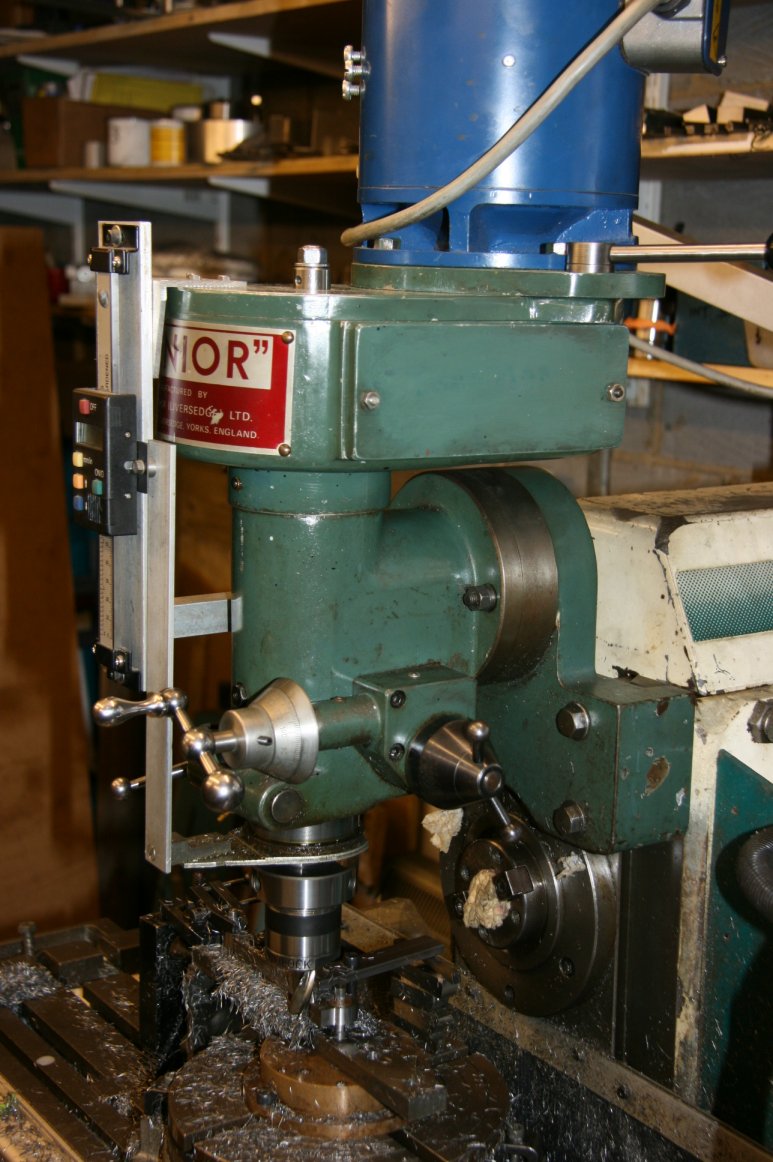

Hi. Has anybody taken a Senior Quill Head apart? Mine needs a new top bearing but I cannot find any way of removing the spindle pulley. There are 2 socket grub screws in the same hole in the pulley, but removing them makes no difference. The pulley stays put! It does jiggle up and down about 1mm with a solid clunk at each end of the jiggle as if it is a key hitting each end of a keyway. Anyone got any ideas?
- Quill Head 001.jpg (150.54 KiB) Viewed 32317 times

Can you post a pic of the head so that we know just what you need - I have drawings numbers / copies for various Denford Senior bits, but the machine naming seemed to be a bit random around that period.

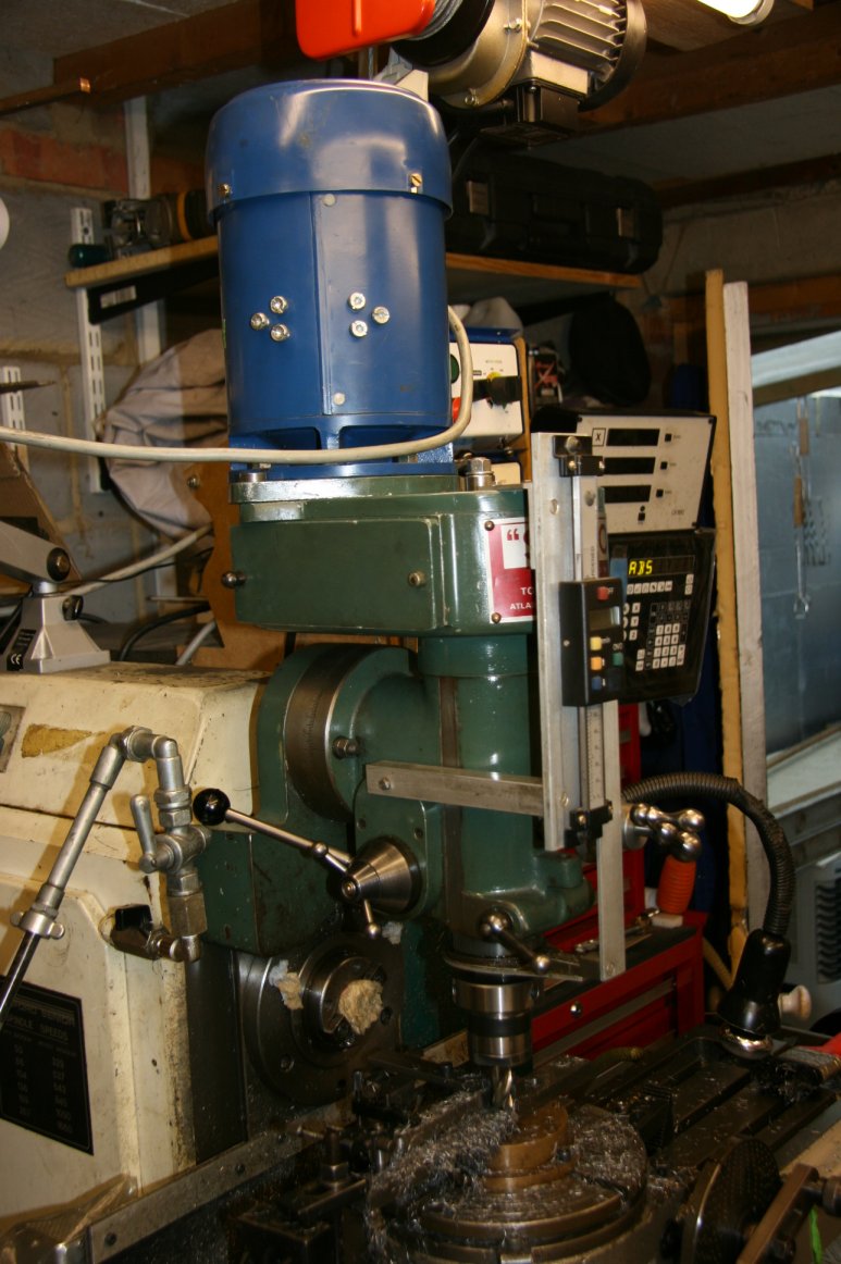

Hi Andy.
Hope these help. Any assistance will be greatfully received. If you have any relevant drawings I will gladly pay for copies and any associoated costs.

Looks like a standard Senior quill head (just wanted to check as the base machine is a Denford Senior) - I replaced the bearings on mine a few months back.

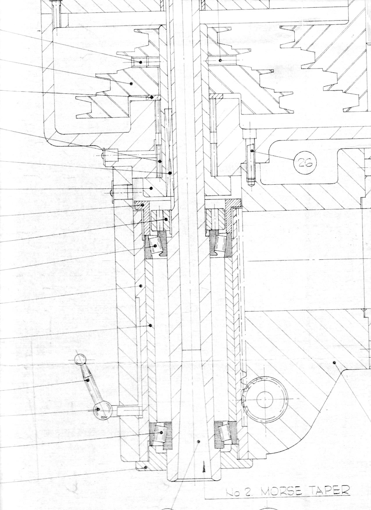

There is a picture under S-Spindle-1.zip on the Yahoo Tom Senior page - this shows an earlier arrangement than yours (quill lock is a screw on the front, not a split clamp) but shows essentially what you should find inside.
From what I remember now, the pulley is a close fit on its spindle and the grub screws that retain the pulley tend to throw up a burr when they are tightened. Consequently, it is very tight to remove and the pulley bore inevitably gets a bit scored.
When you jiggle the pulley, is the pulley spindle moving with it? If so, I suspect that the 'clunk' you are hearing is the flanged head of the pulley spindle contacting the housing. They seem to be assembled with a fair amount of axial clearance!!
So the first time you remove the pulley, it needs a bit of faith to get a lever as far under the pulley as possible and gently prise it up. Once it is off, you can file a small flat on the spindle so that subsequent burrs when you re-assemble with the grubscrews won't affect any future dismantling.
I wanted to minimise the axial float when re-assembling, and it becomes a bit of a game to hold the pulley spindle up whilst pushing the pulley down - so a small wedge (a thin flat screwdriver) down the main spindle keyway helps to lock the main splindle and pulley spindle together whilst adjusting the pully position.

PM me your email address & I'll send you a copy of the drawing.
P.S. I'd be very wary of using a puller unless you can get it right inder the pulley - the edges break off easily, as I learnt to my cost when I had to remove my motor pulley (the previous owner had used a loctite-type adhesive, which wasn't obvious until I got it off)

For completeness I've attached the drawing in question, from the Tom Senior site... hope no-one minds!
