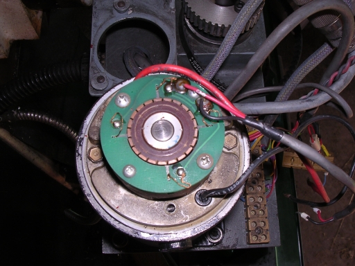

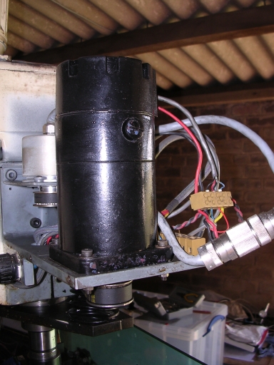

a) Z-drive motor. After repairing the intermittent Z servo tacho wiring, the quill has started "stuttering" and on inspection its at a regular interval which corresponds to one bout of stuttering per rotation of the Z servo motor. Now traced to what I believe is a shorted commutator or failed winding on the Z servo motor (with the motor just on low-voltage a DC supply it will turn through, say, 330 degrees and then jump the remaining 30 degrees). Am urgently trying to find a replacement or to get it rewound. No label on it. Appreciate if anyone could advise - anyone have a parts list? or just the motor specs? or even better, a user manual? or even just recognise the maker? (no label on the motor at all, castellated top may be distinctive? appears tacho is an integral fitting, appears to be remains of a Baldor label on one of the other larger bed servos ....). Base appears to be NEMA-34 footprint. Current motor (2 brushes) delivers app 30 RPM / volt (minimum start voltage is just under 3v); free-running/no-load current (i.e. motor off machine) is app. 0.2A. Tacho (4 brushes) gives out app 6.5v / 1000 RPM.
1 - Senior 3C Z servo motor
1 Denford_3C_Z_Servo.jpg (148.16 KiB) Viewed 18677 times
2 - Senior 3C Z servo motor tacho
2 Denford_3C_Z_Servo_tacho.jpg (148.13 KiB) Viewed 18677 times

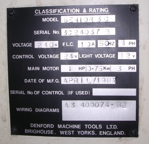

The attachment 3 Denford_3C_serial_plate.jpg is no longer available
3 - Senior 3C main data plate
3 Denford_3C_serial_plate.jpg (75.19 KiB) Viewed 18658 times
