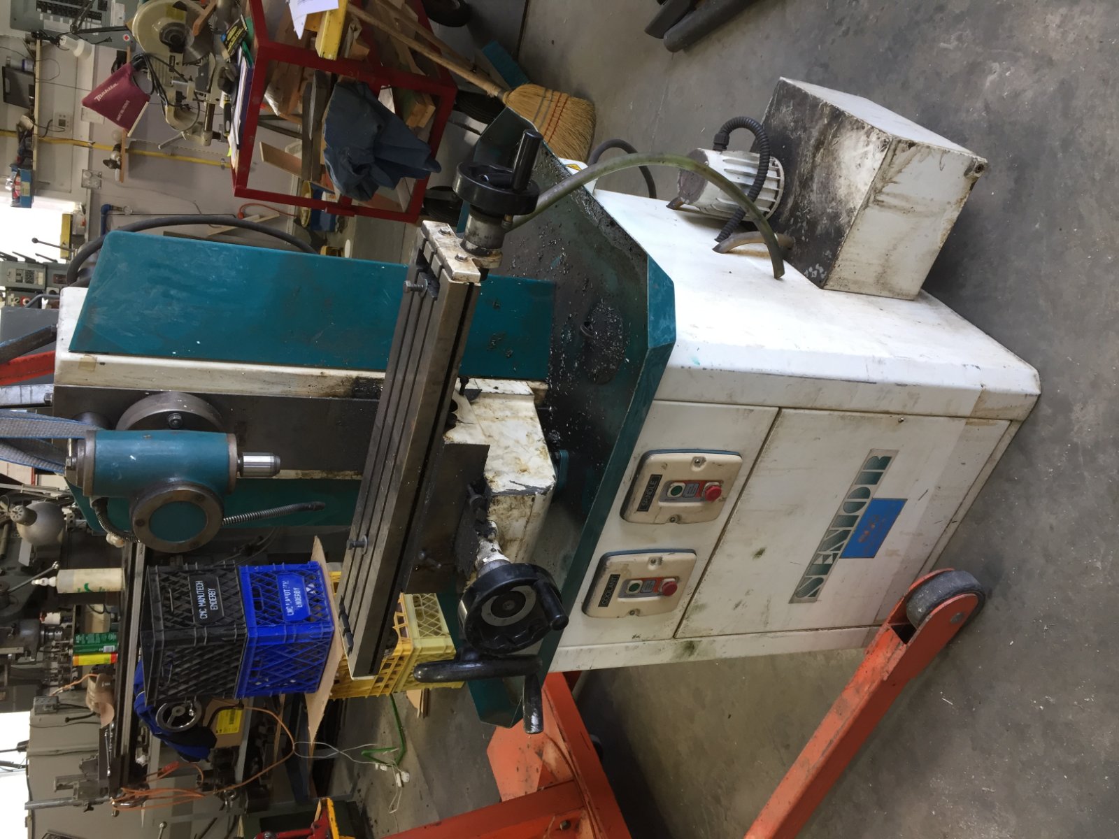

I am in B.C. Canada, and just acquired a Denford Senior/ Junior Milling machine
First - I am looking for a manual & drawings. Second it has a collet stuck in the vertical spindle, so what it the taper, and how do I remove it. I backed off the retaining stud, and gave it a rap with the hammer, but it did not move. Any ideas.

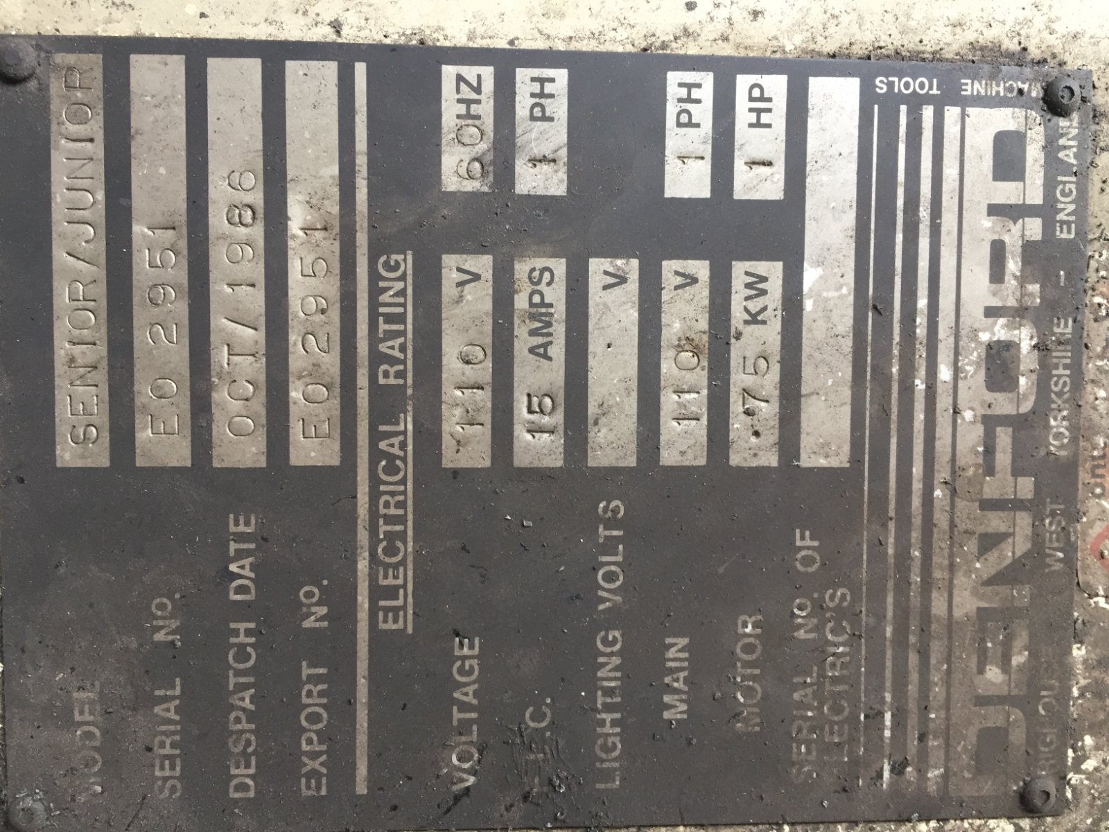

The S/N is EO 2952, and Dispatch date is Oct 1986.Denford / Junior Milling Machine

Thanks for the quick reply Andy - I will get a bigger hammer! I alway want to check first. My machine is a bit different than the manual you linked me to. The motor on mine is in the lower cabinet. The serial number is EO 2951, Dispatched Oct 1986, if that helps.

The lower belt seems to be too long, so I wanted to see what the correct length should be. Also - I have to pull the table, saddle and knee, because there is stiffness and binding. I also may need to get a new cross feed nut - I will find out when it comes apart.
